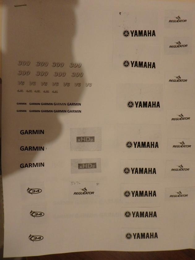

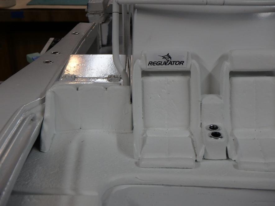

    Graphic Update:
    Photo copied cut and paste master to make waterslide decals
    Click image for larger version  Name:	P1090006.jpg Views:	0 Size:	38.0 KB ID:	177455

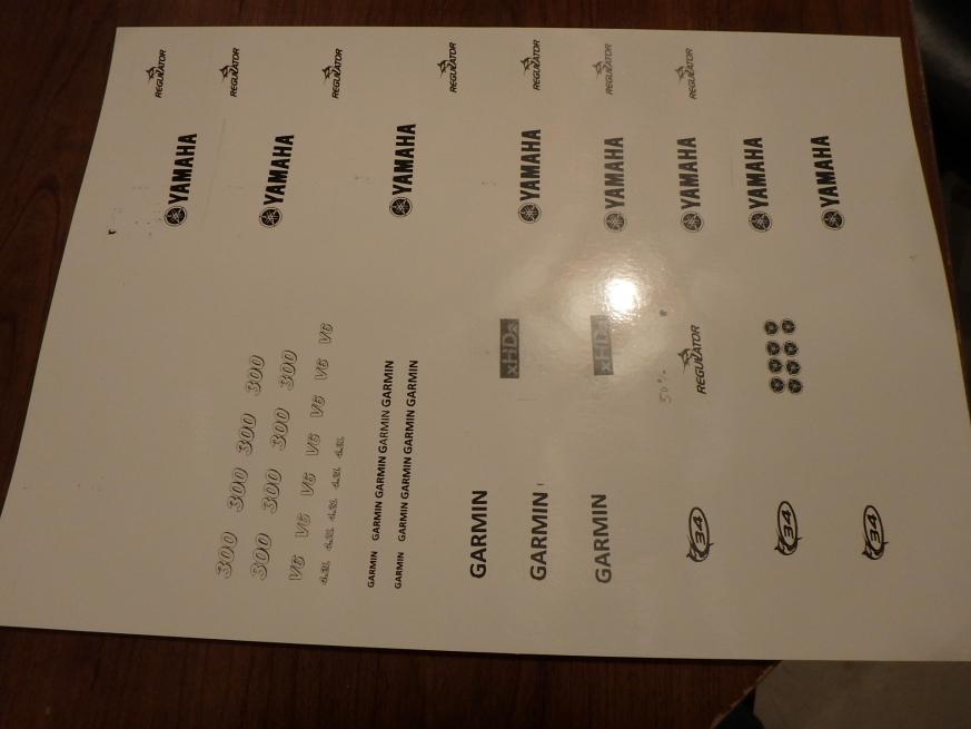

    Printed decal sheet ready to use (cost to print two at office supply store :$1.51 US!)
    ​ Click image for larger version  Name:	P1090010.jpg Views:	0 Size:	37.9 KB ID:	177456 ​
    Mockup decal lay out for upholstery
    Click image for larger version  Name:	P1090009.jpg Views:	0 Size:	39.9 KB ID:	177457

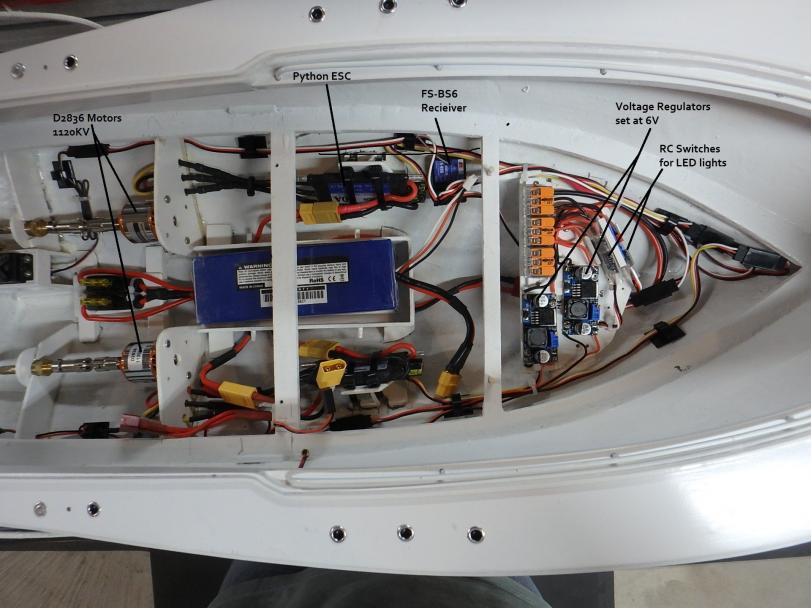

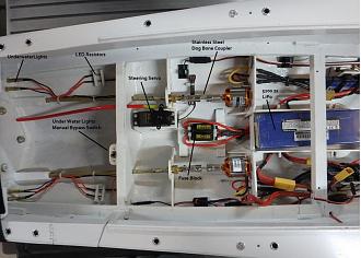

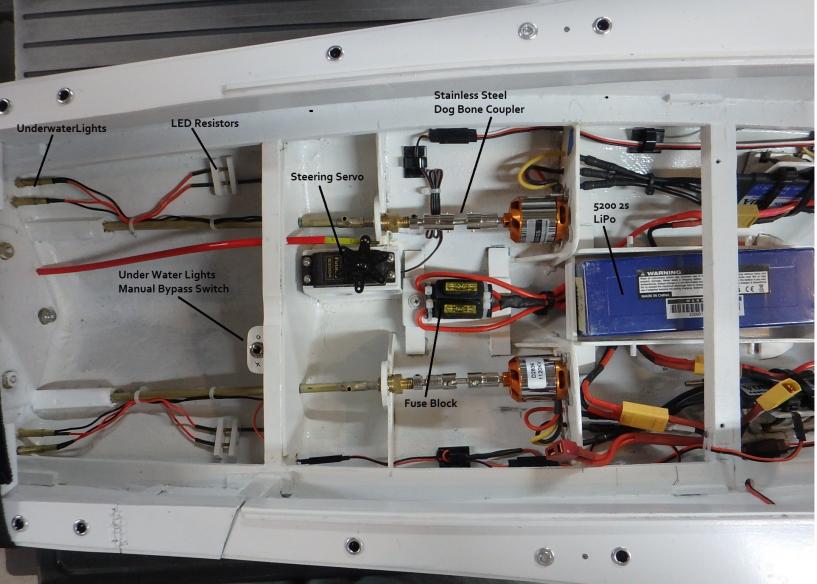

        Here's what makes it go...
ID:	177922 Click image for larger version

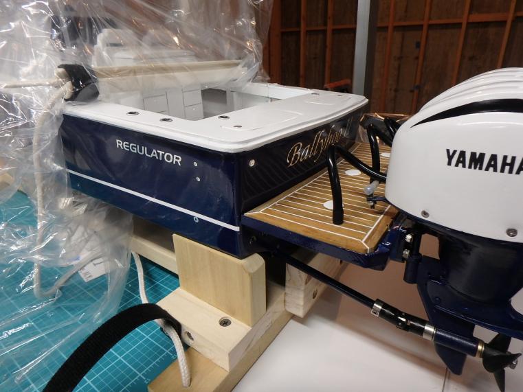

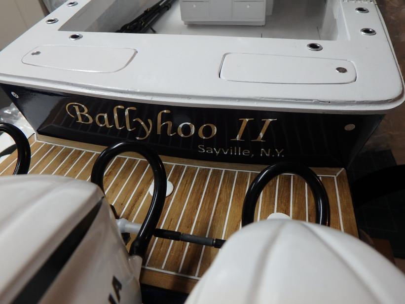

          The boat is now finished off with a name...
ID:	178678 ​ Click image for larger version

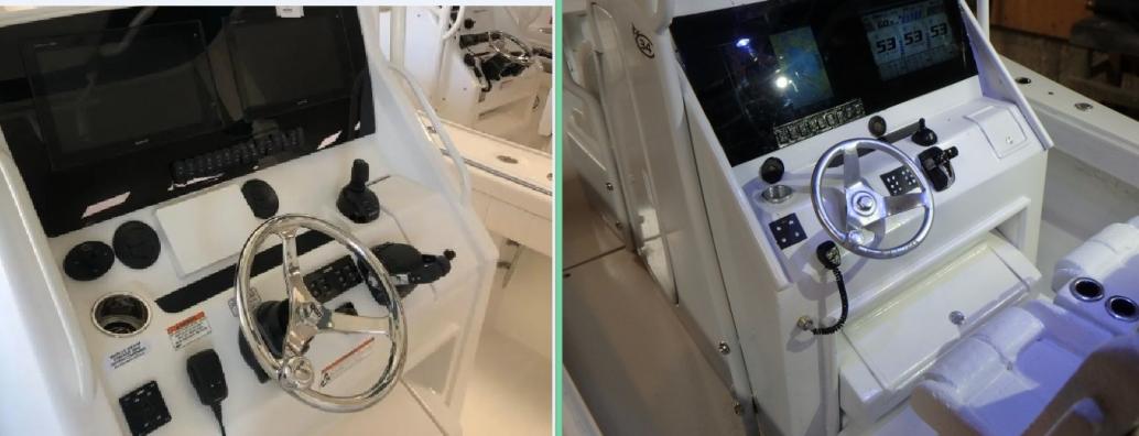

              Here's a picture that I hadn't posted on NDF - "1:1 vs 1:12"
Name:	Screenshot .jpeg.jpg

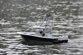

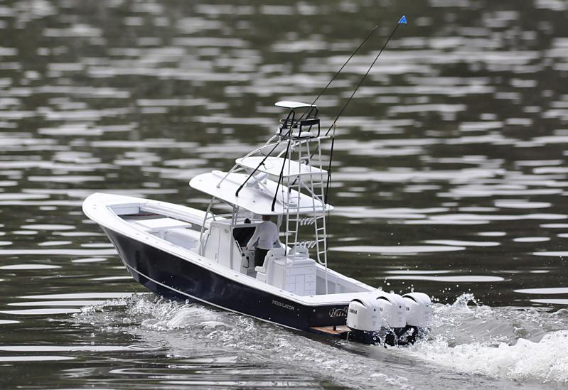

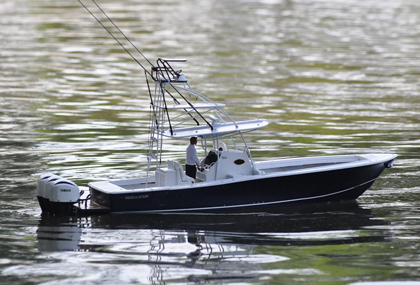

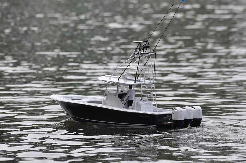

                Fine tuning the motors and props- closer to or at a scale 60kts!
                • Bob Gato
                  • 898
                  This is probably as good as it gets- the end of a work in progress...

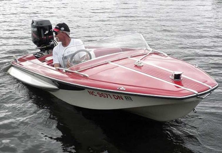

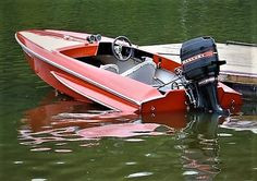

                      You Know "D"- I was thinking of doing a simple boat like a Glasspar G3 with an Evinrude 75... . In 1/12 it would be only 14" and since I've got this simple outboard thing down it might be fun and still afford the time to take care of the honey do list!!
                      Click image for larger version  Name:	3ed573b3e5375aac041e734f1567d9aa.jpg Views:	55 Size:	18.8 KB ID:	181021
                      Click image for larger version  Name:	g-3-glasspar-john-(002).jpg Views:	49 Size:	62.3 KB ID:	181022

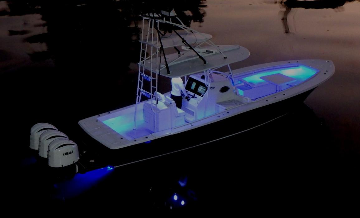

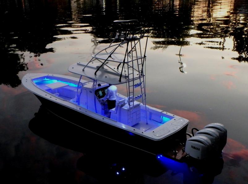

                        I have some night shots that I think might be enjoyed on this thread-BG
