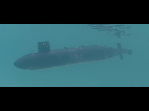

          Check our Matthew Homeier's dynamic diving 1/125 USS Narwhal from the 2024 Subfest redux. AFAIK fixed sail planes.
