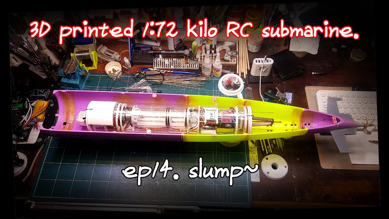

    Just watch Tiver21s latest YT video where he shows his WTC for his 1/72 Kilo. In the video he placed tire weights inside the WTC to impart roll stability. Shouldn't the weights be on the hull?

    Saw that too, not sure what advantage if any?

      Yes. If for no other reason than to get the fixed ballast weights as low in the structure as possible.
        I have seen weights added to a WTC, mostly in VERY old postings. Some would level their WTC, then add weight to a hull for any minor corrections. I would guess the thought process is moving the wtc around to different subs would be simpler, maybe keep hull weight down too. I do not know it does not work for my brain.
          Keeping the weight in the cylinder reduces the effectiveness of them. The further the distance between your center of buoyancy and center of mass, the more stable the boat.
