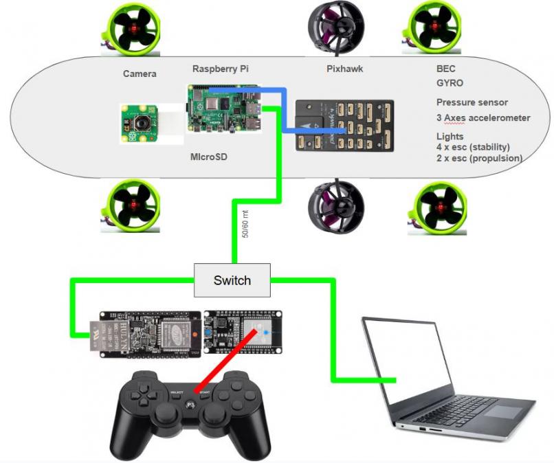

          Here is what I have considered at the moment as first instance.
          ​Main concern ...
          - no idea how to set the flight controller over the 6 motors (with ardupilot or betaflight)
          - worried for the Python code to send commands get back telemetry
          If you see a macro mistake on the scheme, I'll appreciate any comment

              TuptubBuilder, thanks for suggestion. bluerobotics.com looks very specialized place for my purpose.
              At the moment I'm still evaluating the architecture before to take a direction.
              ...considering to downgrade the electronic, kill the raspberry and turn into Arduino base and RS485 ... but then I have the problem of the video transmission...

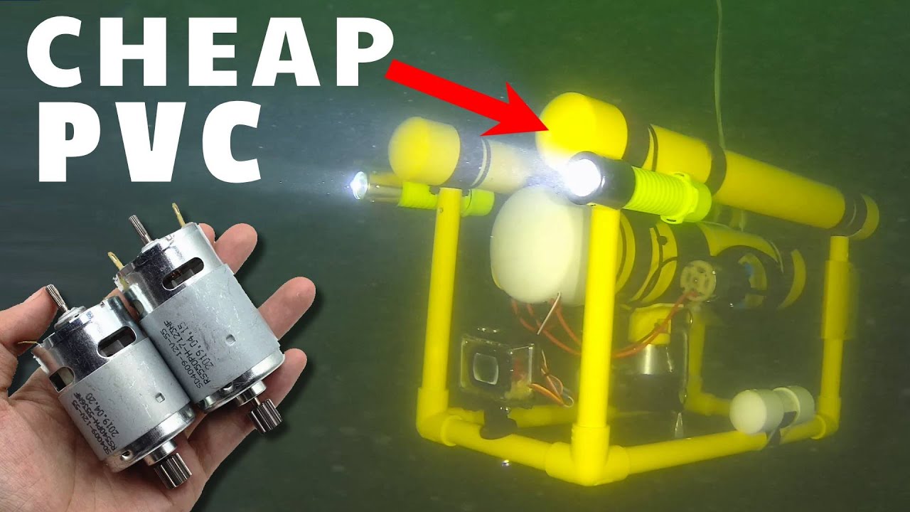

                  redboat219 , thanks for sharing ... I like the channel of this guy, he's playing with several interesting water toys...
                  - weird to see that DC motors doesn't suffer the water ... especially salt water!
                  - PVC pipe should be a cheap potential replacement to expensive acrylic tube; maybe I can test the resistance to external pressure by adding internal stiffening.
                  - I still have doubts regarding the video! ... He is using a normal PAL/NTFS output but I think it should work only for few meters over the UTP CAT5 cable. I've started to procure an extender :-) ...

                          For the tether I considered the LAN protocol to have only one cable, otherwise it'll be difficult to bundle 50 or more meters of cable.
                          Still convinced to keep CAT5 but I'm more oriented to RS485 rather than LAN because of costa and time for the software.
