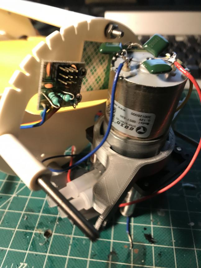

                        I managed to disassemble the boat, remove the old pump and got the new one ready. But I'm struggling following your directions on how to install the new pump. If you have any pictures of the pump as it sits in your boat that would be helpful. I don't know which direction it is facing etc. Trying to mount it vertically but there's not enough room as it bumps against the board of the servo connectors.

                          You can always relocate the board. It doesn’t have to stay at that spot.

                            I get that although cable lengths are somewhat determining where stuff goes.
                            I'm reluctant to make too many changes as it affects the weight distribution. Everything feels like brain surgery with this boat, it is so complex.

                              Cut the wires, move the board down a little bit where it doesn’t interfere anymore, and solder the wire back up with wire splice, and heat shrink around each solder joint. Moving that ounce of weight is not gonna matter. Do you have a soldering iron?
