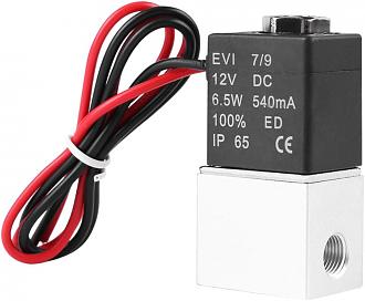

  • Sinksalot
    replied
    Here are two of the replacement pumps setups i have used in the Neptune. Got the all the stuff off Amazon. Also you don't need to get this pump, a smaller pump will do. It will just take longer to dive and surface.
    Intillab 12V DC DIY Peristaltic Liquid Pump:
    Click image for larger version  Name:	51mk+pI-27L._AC_SL1000_.jpg Views:	0 Size:	61.2 KB ID:	182854
    Keenso 12v Windshield Washer Pump and 2 Way Normally Closed DC 12V Electric Solenoid Air Valve 1/4" NP:
    Click image for larger version  Name:	61JCUMjp2hL._AC_SL1001_.jpg Views:	0 Size:	78.3 KB ID:	182856 Click image for larger version  Name:	512cG1OXcrL._AC_SL1000_.jpg Views:	0 Size:	89.5 KB ID:	182855
    Also if the Pump controller is bad and I am using 75mhz, or for people in Europe 40mhz. I use a Brush motor speed controller to control the pump with one of Bobs BLM - Battery Link Monitors connected to the receiver and pump, so if I lose signal it take control of the pump ESC and blows the ballast out bringing the sub to the Surface. You just need make sure when diving to stop the pump once you get the the point where the Neptune can dive using the dive planes. Its not a big deal
    Other people have used this stuff too.

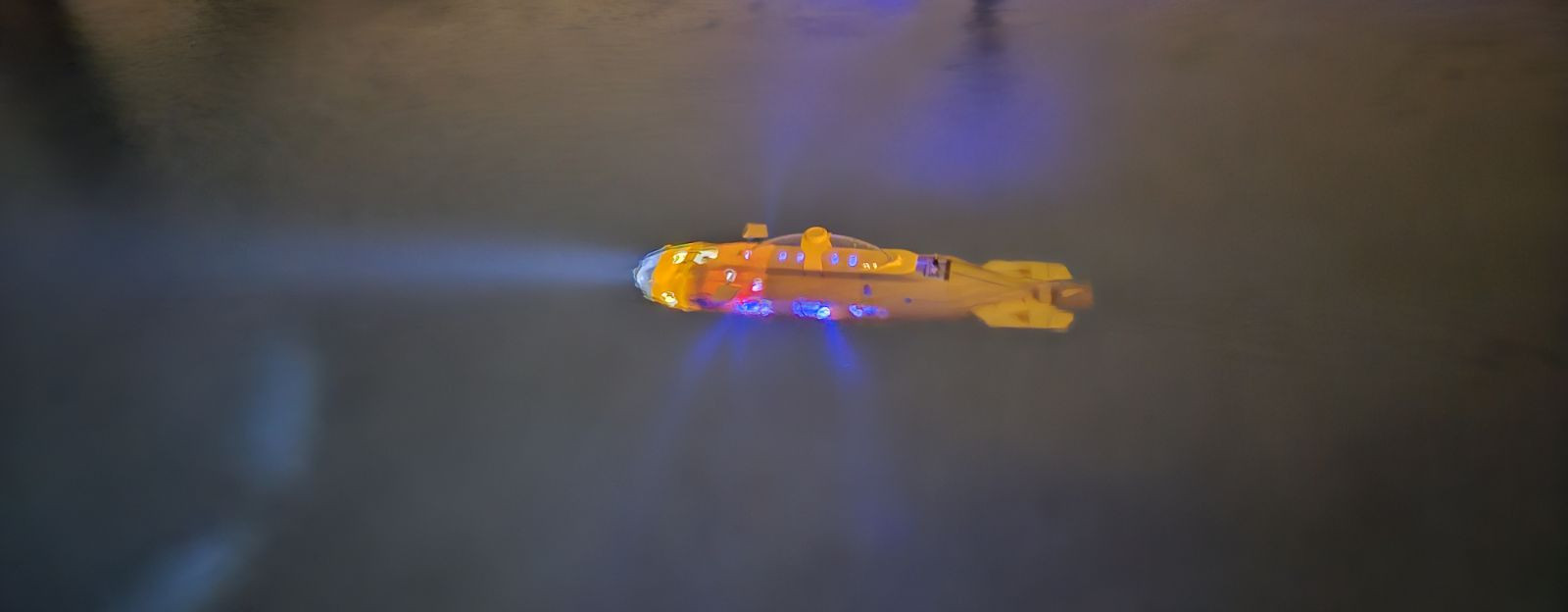

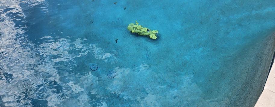

  • Sinksalot
    replied
    Originally posted by tifosi12
    Working on the sub. Meanwhile I managed to replace the prop and redid the electrical connections and the air lines. Still have to do the assembly of it all, which will be tight. But at least in a disassembled testrun all the functions were ok and the bag inflating/deflating.
    This made me think: I really love the simplicity of the inflating bag, filling it with water for diving/surfacing. Does anybody know of the electronic part required to control the pump? I assume it plugs into the receiver on one end and on the power supply line for the pump on the other. Probably some kind of relay. I'd love to use that for my next self made boat as a means to control the dive/surfacing.
    You look to being doing great with your Neptune. The main things that die on a Neptune are the Ballast pump controller and the pressure sensor that connects to it. I fixed six Neptune that I bought. Four said they didn't work and the other two were suppose to be working. But none worked. I was lucky I have found two new original pump controllers and sensors. I also upgraded the small prop, as its tiny, with a new a 62mm prop from the thunder tiger Seawolf parts. As for finding replacement electronic thunder tiger sub parts, they are dam hard to find.
    Here is my own person Neptune sub. Yes I know it looks like a Seawolf, but I gutted this Neptune and replaced the parts with Seawolf parts and added the bigger prop with a brushless motor, Lipo battery.
    Here is one I rebuild for someone. One picture is the sub as it was getting dark and the other is the Neptune 10 feet at the bottom of pool holding station. Running at 75mhz
ID:	182849 Click image for larger version
Name:	10 feet sub.jpg
