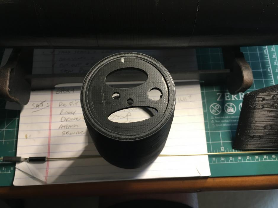

            Click image for larger version  Name:	134863A5-D5FD-4AE6-A117-1A4D37DA212D.jpg Views:	0 Size:	94.8 KB ID:	180454 This bulkhead may be trapping air.
              https://forum.rc-sub.com/forum/build...tilus-drydocks
              Agreed, I previously tried to vent it better, will be looking at it again.
