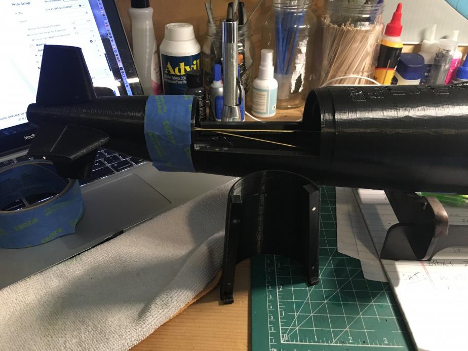

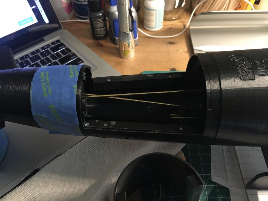

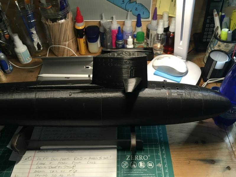

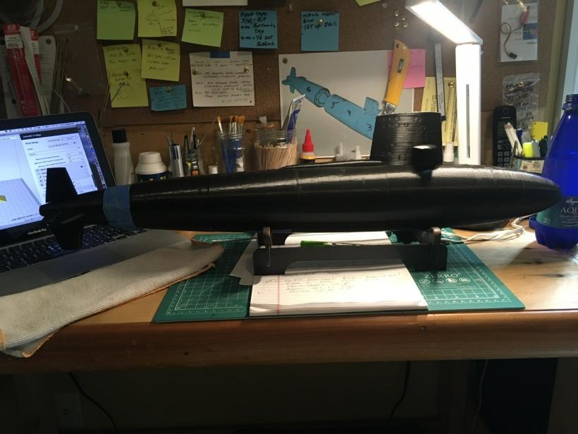

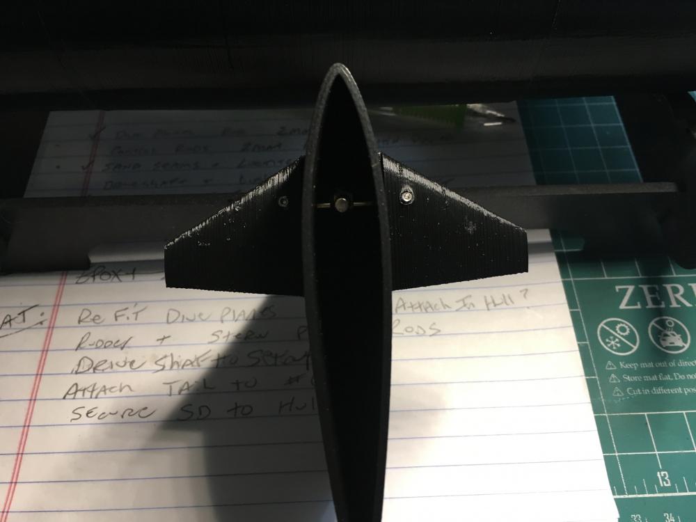

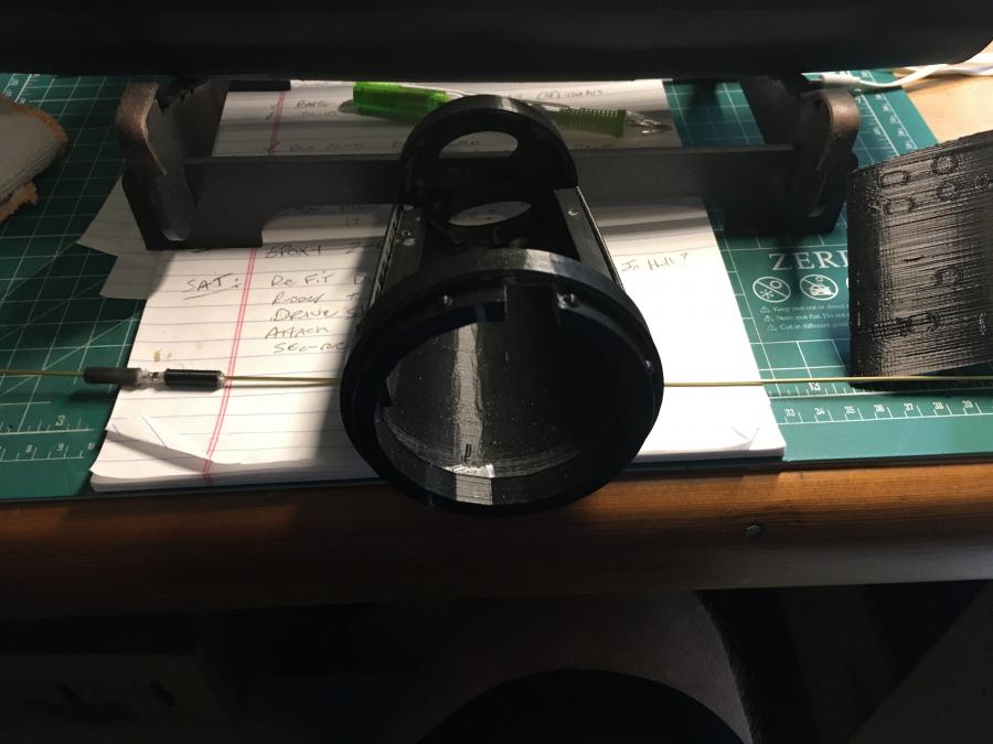

    I have finished printing The Skipjack. I printed in 1:96 to accomodate my 2.5” Subdriver. I am now installing the mechanics. The Tail assembly is not yet attached as Drive shaft and Control Rods are being routed. Click image for larger version

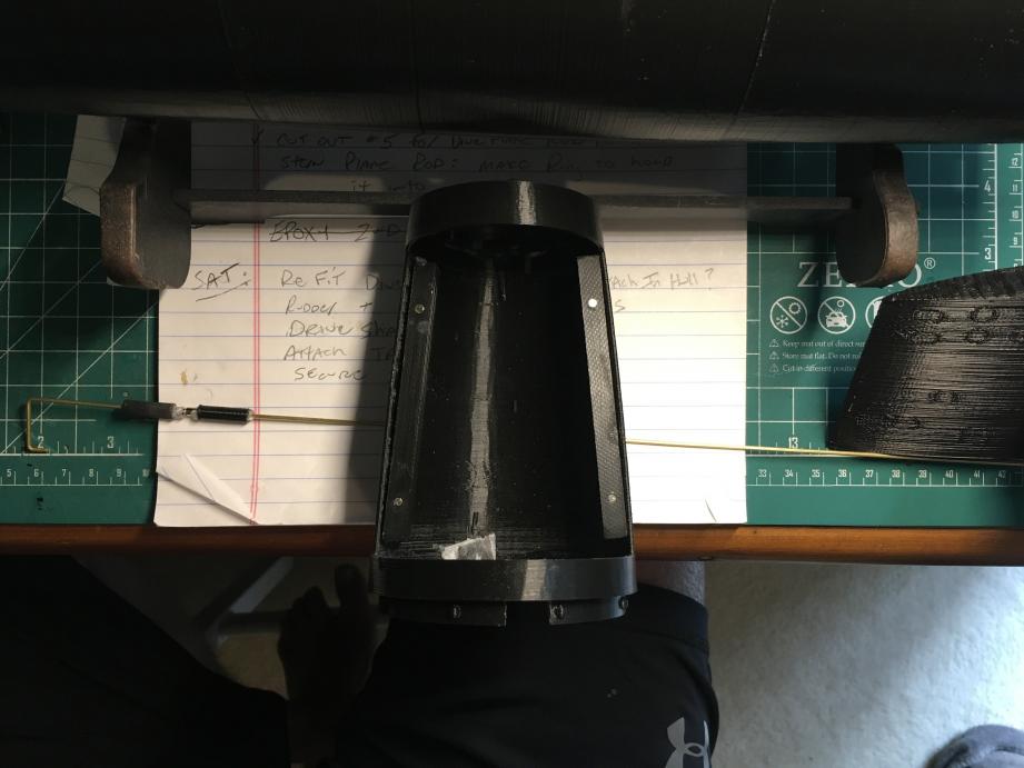

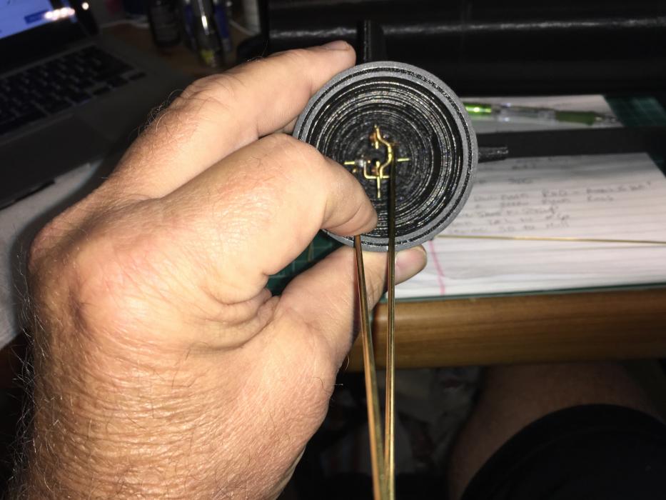

    At Bobs suggestion I designed a hatch to allow access to the Driveshaft Dogbone and Control Rod Magnetic Connectors. I also fabricated a guide for those as well. Click image for larger version

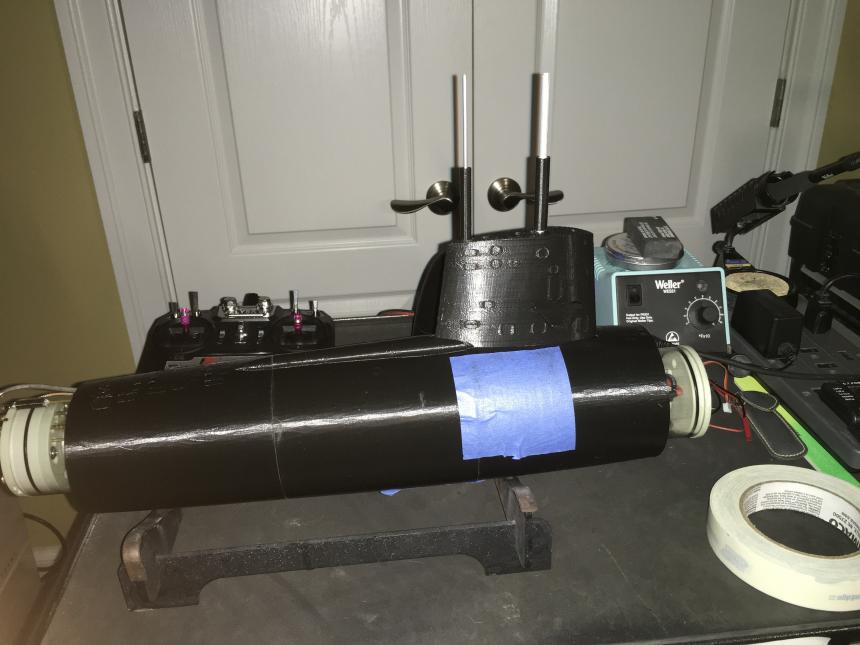

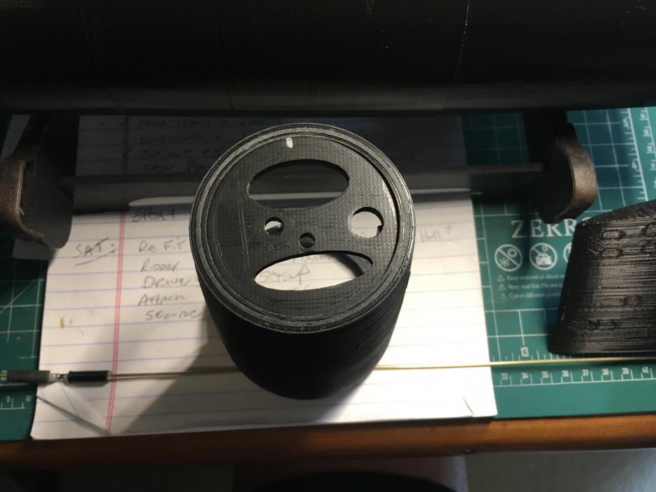

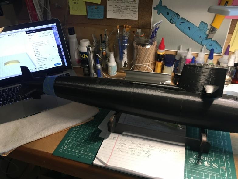

      One thing I learned was in scaling the Bayonets. Do not change the thickness as it elongates the “beads” that go into the “locking channel”. Here you see one of the Bayonnet Ring. I notched the Ring to allow the Dive Plane rod to fit above the SD Cylinder. All Cylinder Support Rings and the Bayonets were sized to hold my 2.5” Cylinder. I will be using Automotive Sandable Primer and sanding after Trimming.

        I must say I am amazed at how well the Bayonet System works. I also oversized the Rudders for better agility. I used Loctite Gel, then West Marine System Epoxy to adhere the Hulls. The Loctite Gel was recommended to me for PLA since it “reacts” with PLA for a strong bond.
