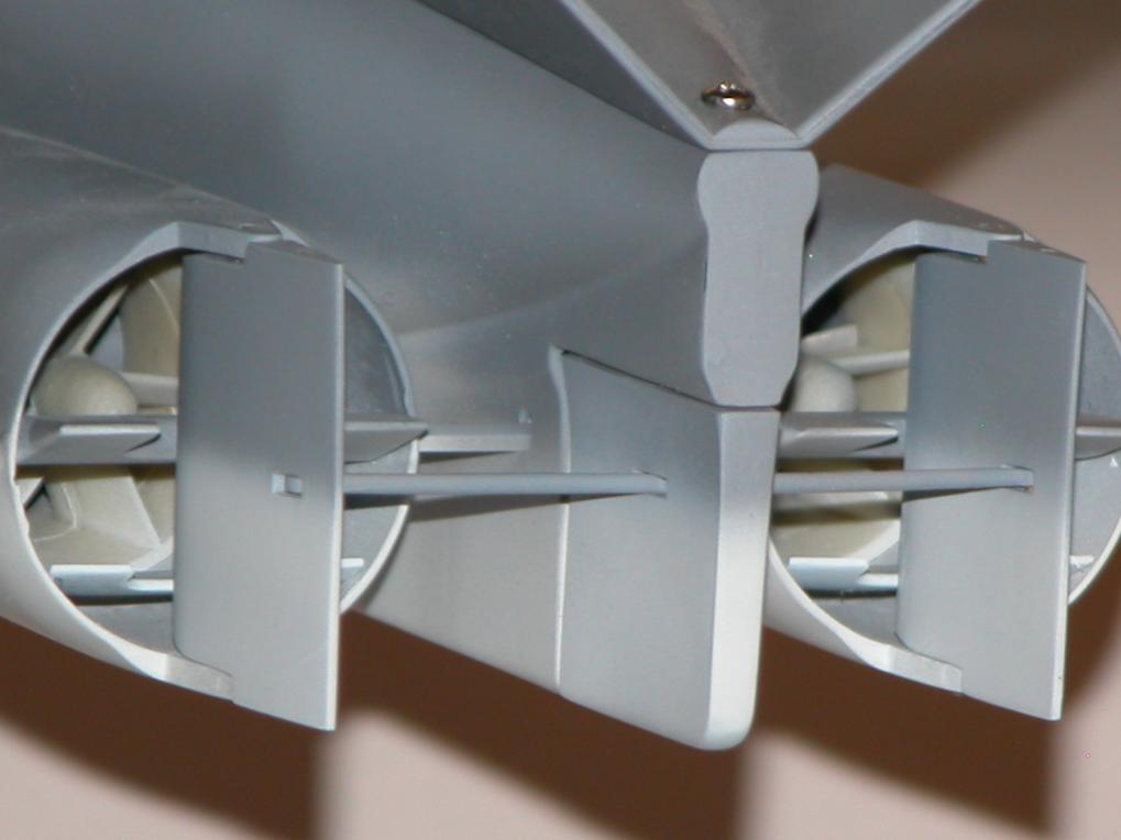

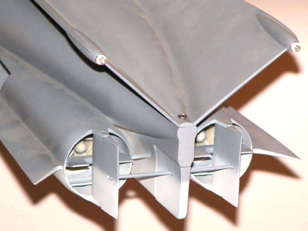

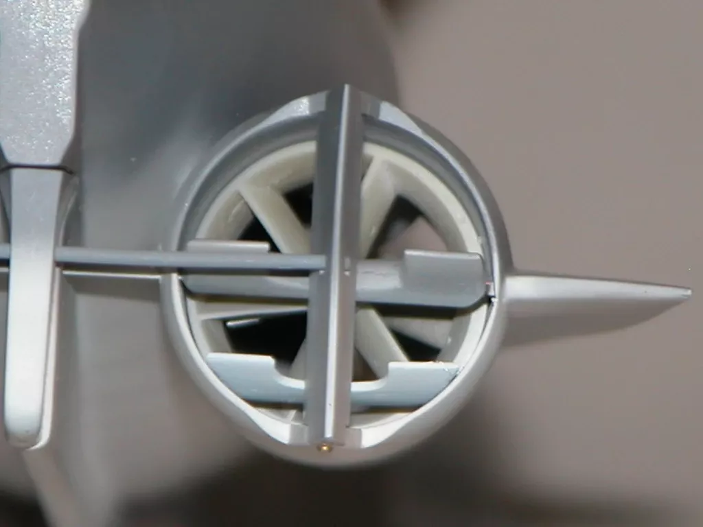

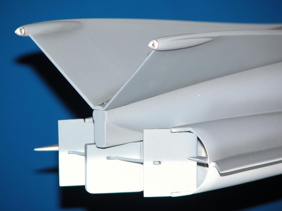

    Nope. The 'neutral' position of the stern planes is as you see in the photo. This is their position with the boat at a zero pitch-angle and the stern plane servo centered.

    • wlambing
      • Nov 2020
      • 389
      From the pictures it appears that neutral is at a slight rise angle, not down. This will tend to hold her nose up as she proceeds through her mission.
        • 13869
        Correct sir. Needed to counter the shovel-nosed SEAVIEW from plowing down at any significant submerged speed.
