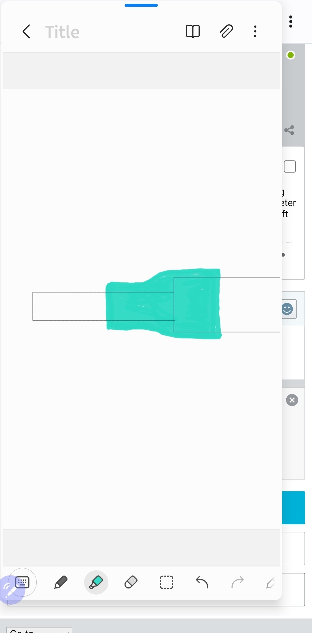

Beginner question! Sealant!
Name:	Screenshot_20220811-213351_Samsung Notes.jpg
    Alternative sealing is to use a short length of silicone fuel tubing with an internal diameter slightly smaller than the outside diameter of your drive shaft. Slip the fuel tubing down over your drive shaft then onto the end of the stuffing tube.

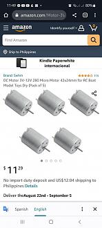

                        Looking online for a small electric motor now. The ones I have are 1.25”x1”, or 3.175cm X 2.54cm.
                        I do not mind if the replacement motors are slightly slower. The ones I have used are too fast for the scale.
                        Recommended sources for replacement motors? Recommended specs?

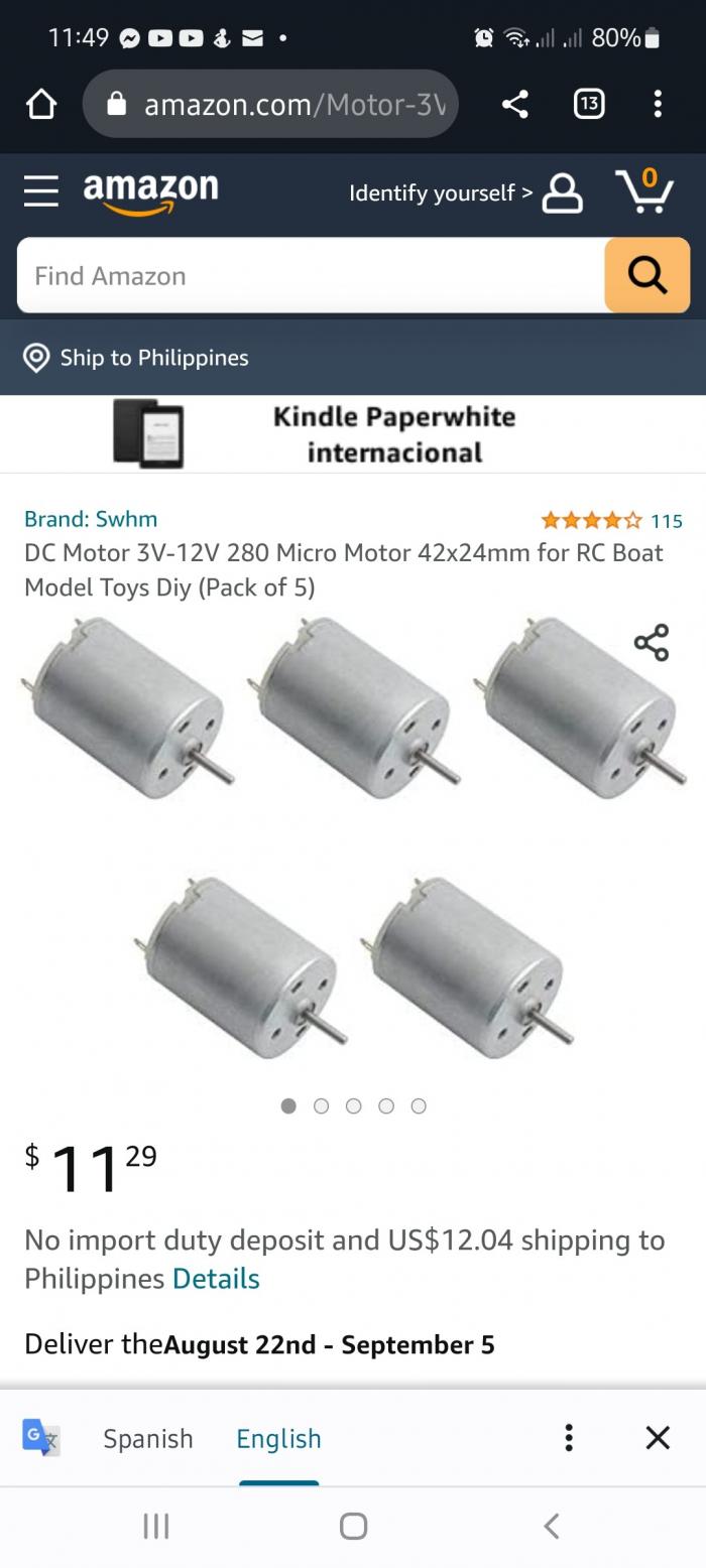

                          Any photos of the motors?

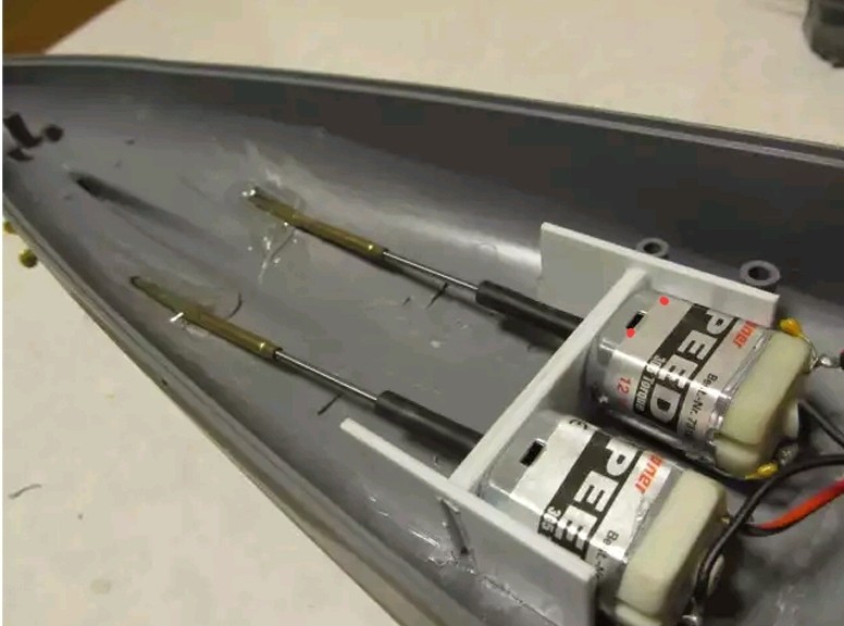

                                Nonproportional throttle with differential steering. Stuffing tube doesn't have bushings at the ends to act as stand off bearings that also help contain the grease.

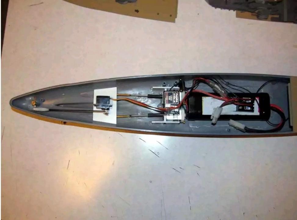

                                Personally I would rip the old stuff out except for the stuffing tube which you already JBWelded in place and get new motors, a 9gm servo for the rudder, a brushed motor esc, 7.2v lipo, and a 2-3channel 2.4ghz radio.
                                something like this, Click image for larger version
