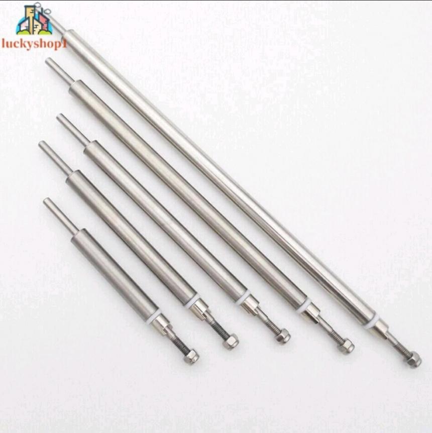

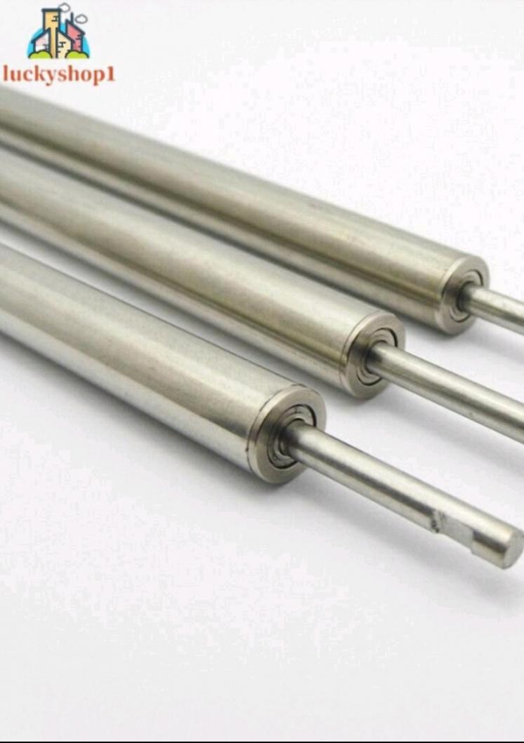

      As David said, You need a stern or stuffing tube. Click image for larger version  Name:	Screenshot_20220728-074930_Shopee.jpg Views:	0 Size:	58.2 KB ID:	163209Click image for larger version  Name:	Screenshot_20220728-074956_Shopee.jpg Views:	0 Size:	54.5 KB ID:	163210

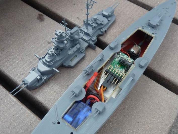

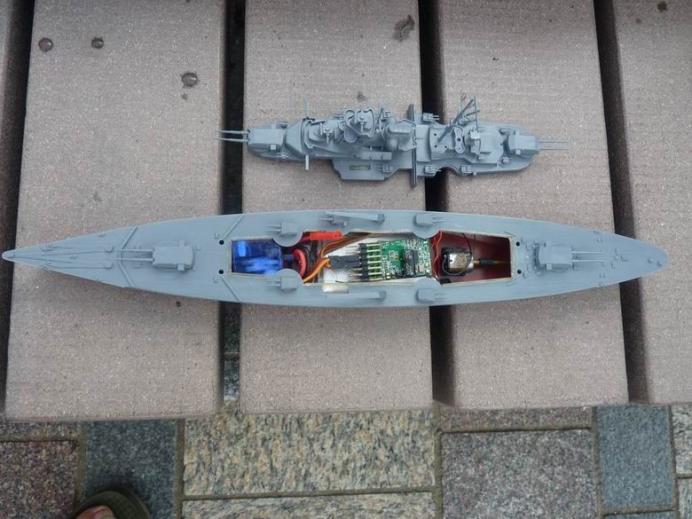

          Stuffing tubes are usually epoxied in place. You can attach the deck to the hull using rtv silicone but most glue it place then cut access holes on top of the deck under the superstructures.

              1/4" tall hatch combings, or if flush-mounted a gasket made of RTV -- lay down a bead on the deck flange, coat the lid with Vaseline, then compress onto the opening and wait for the RTV to cure. Instant in-place hatch gasket.

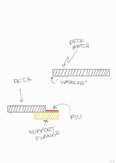

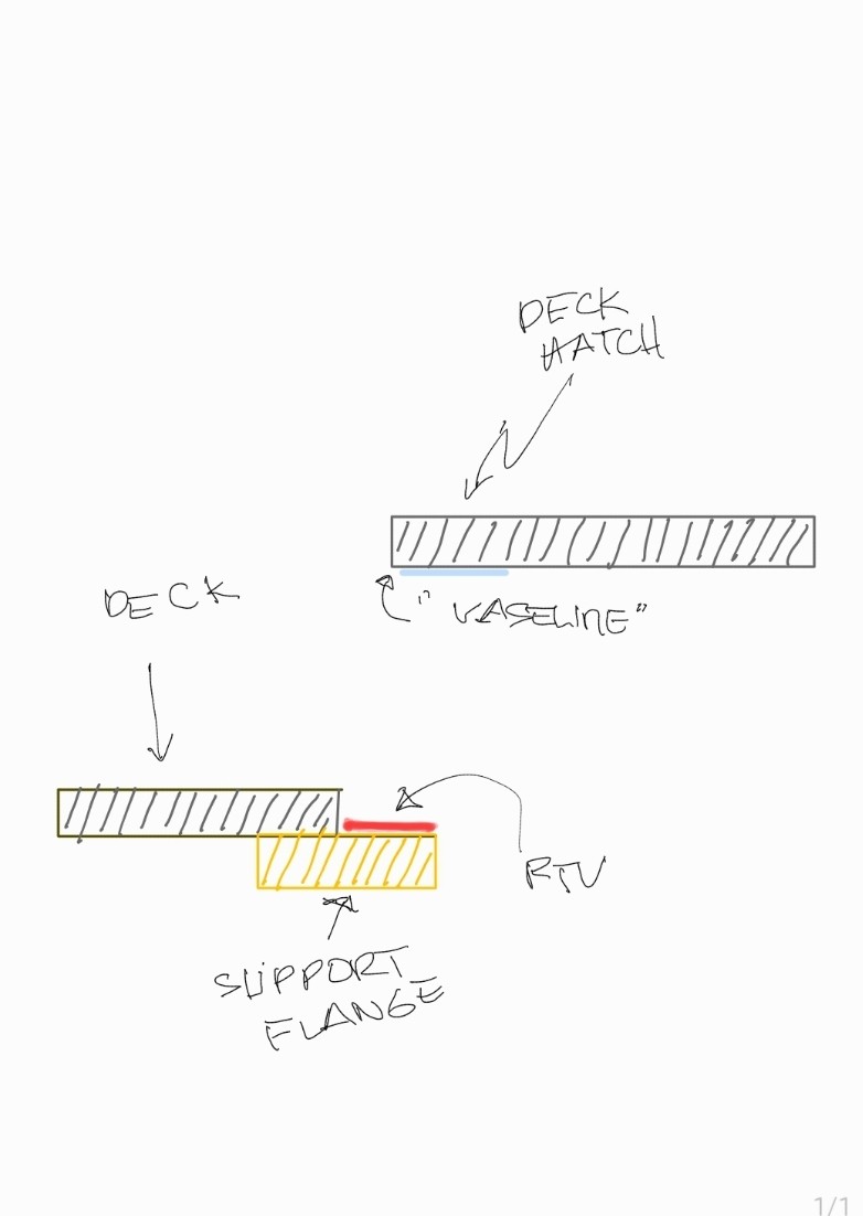

                That being said, why would one apply vaseline to the top of the RTV?
                From what I understand, I am to cut a portion of the deck out, create a "lip" that sticks out into that gap, apply the RTV onto that lip so as to create a hatch gasket when I push the cut out portion of deck back onto that lip. Where does the vaseline come into play? And does the RTV need to be reapplied every time I open that access panel?
                Dom
                  So that you don't inadvertantly "glue" the deck hatch on to the flange. The vaseline prevent the RTV from sticking to the underside of the hatch.
                  Click image for larger version  Name:	Screenshot_20220729-123659_Samsung Notes.jpg Views:	0 Size:	48.6 KB ID:	163244

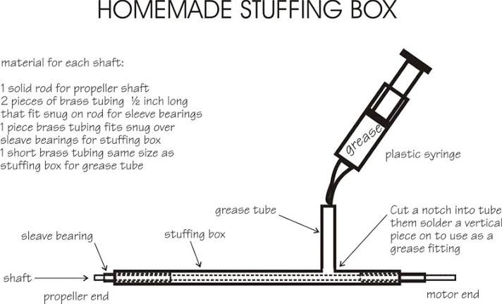

                            Questions.
                            - did you apply grease inside your stuffing tube?
                            -does you stuffing tube have bushings at the ends that acts as bearings and standoff between the shaft and tube to contain the grease?
                            -Are you using a solid shaft or a coiled wire flexible shaft? A coiled wire shaft could act like an Archimedes screw that draws in water when the motor runs in a particular direction.
