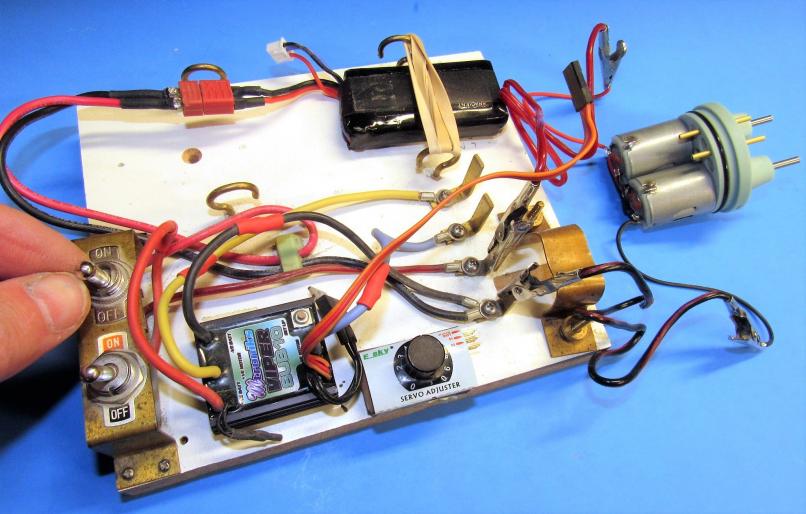

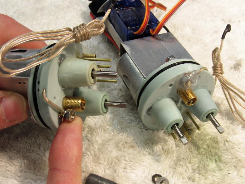

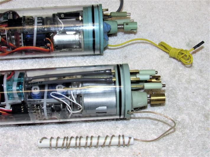

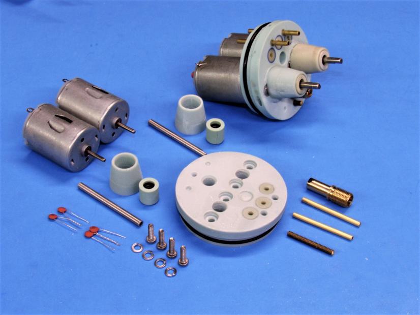

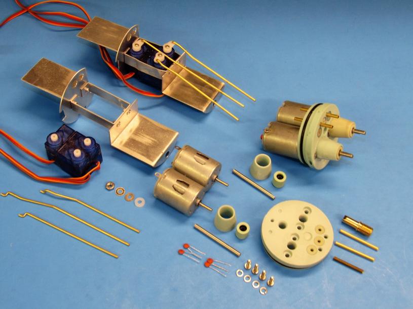

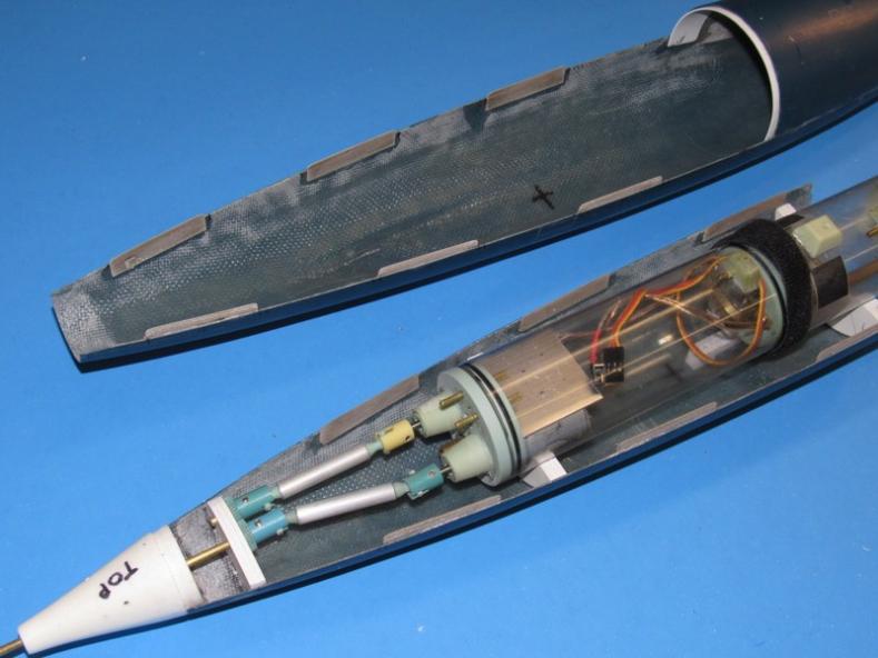

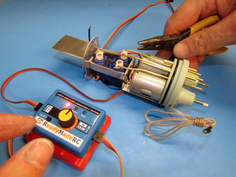

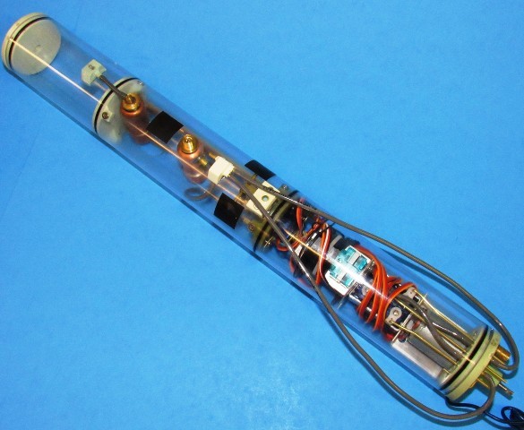

    How did you manage to squeeze in 2 280 DC motors into the 2" SD? The 280 motors have an outside diameter of 24mm, so 2 of them side by side is 48mm. Given the walls of the SD to be 1.5mm thick that leaves an nside diameter of 47 mm, a 0.5mm excess both sides.
    "All hands rig for depth charge!"
    • 13685
    By squeezing the motors in there.

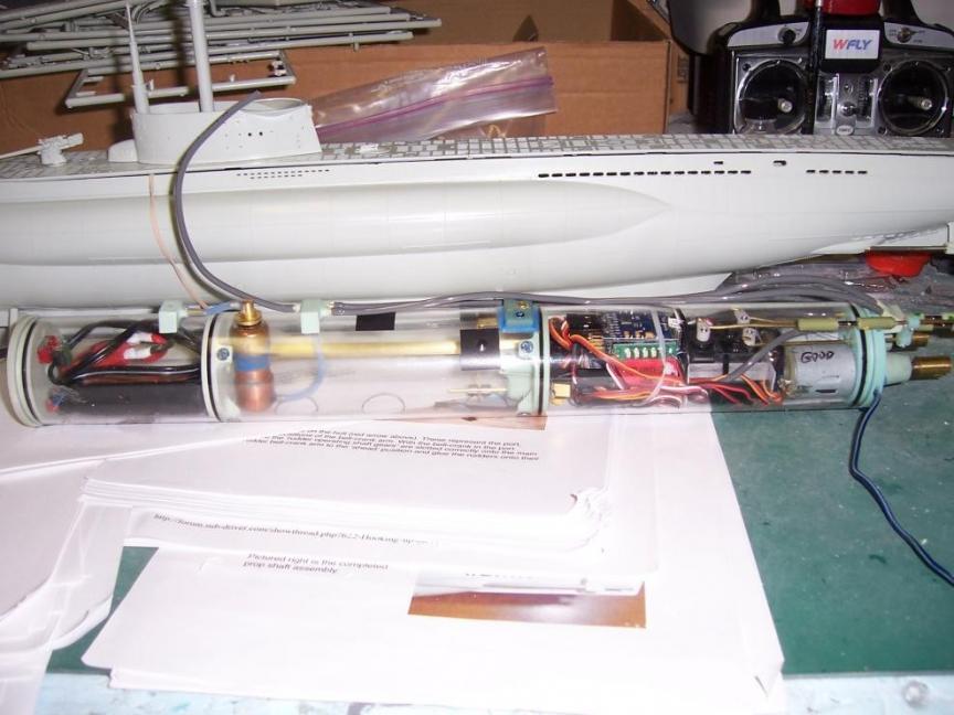

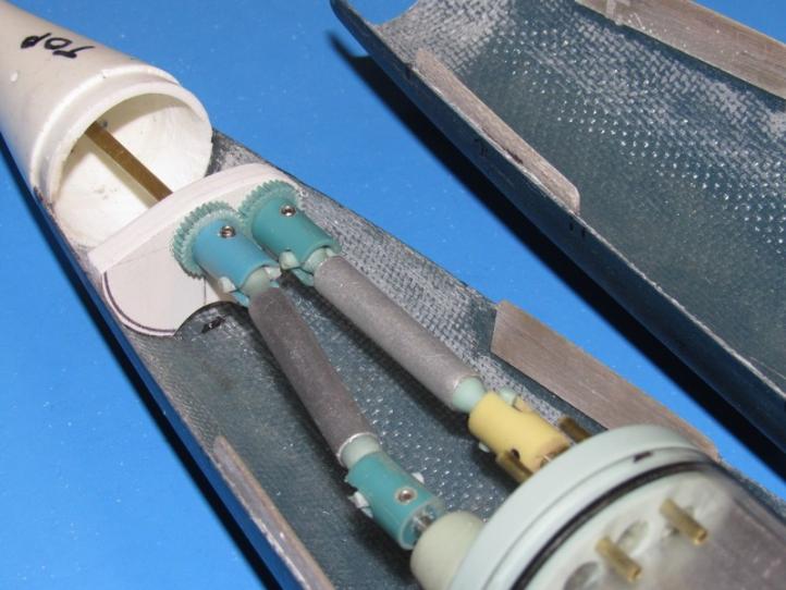

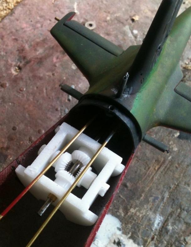

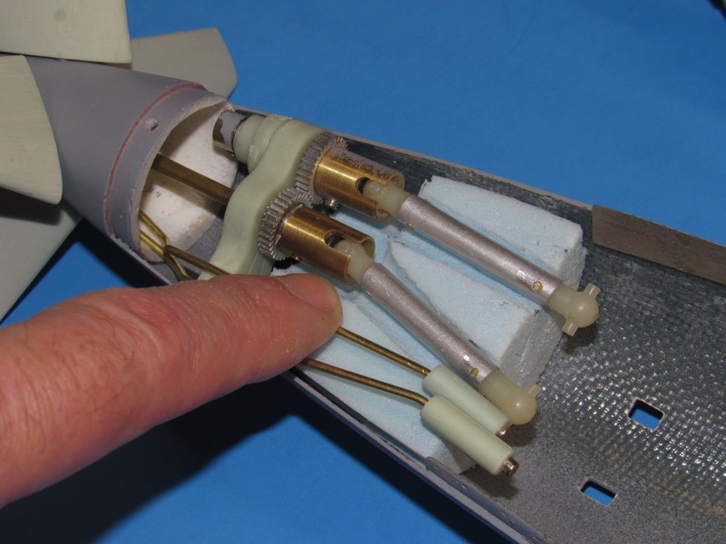

                      Another question, how come with the 2" SD for Scott 's 1/96 Beluga you used a single motor coupled with a countra rotating gear system yet with the 1/96 Albacore you used 2 motors? Click image for larger version
ID:	158353Click image for larger version
                        • 13685
                        I have yet to assemble my BELUGA kit. The one you see in Bob's custody is Scott's work, not mine.
                          • 1570
                          That gearbox is slick.
                            • 13685
                            Yes, it is. Scott Terrey is an excellent model builder and engineer. I've had the pleasure and honor to have collaborated on a few projects with the guy.
