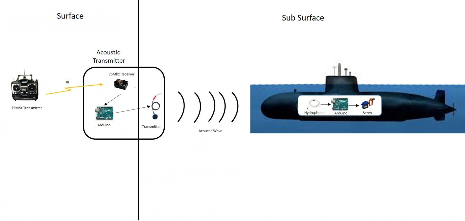

                    This is the architecture I was thinking could work.

                      You could eliminate the radio and just hook a handheld game controller directly to the arduino.
                        You are absolutely correct, I just wanted to make a package that could be used with any system and keep it comfortable for the normal RC user, not always a gamer :)
