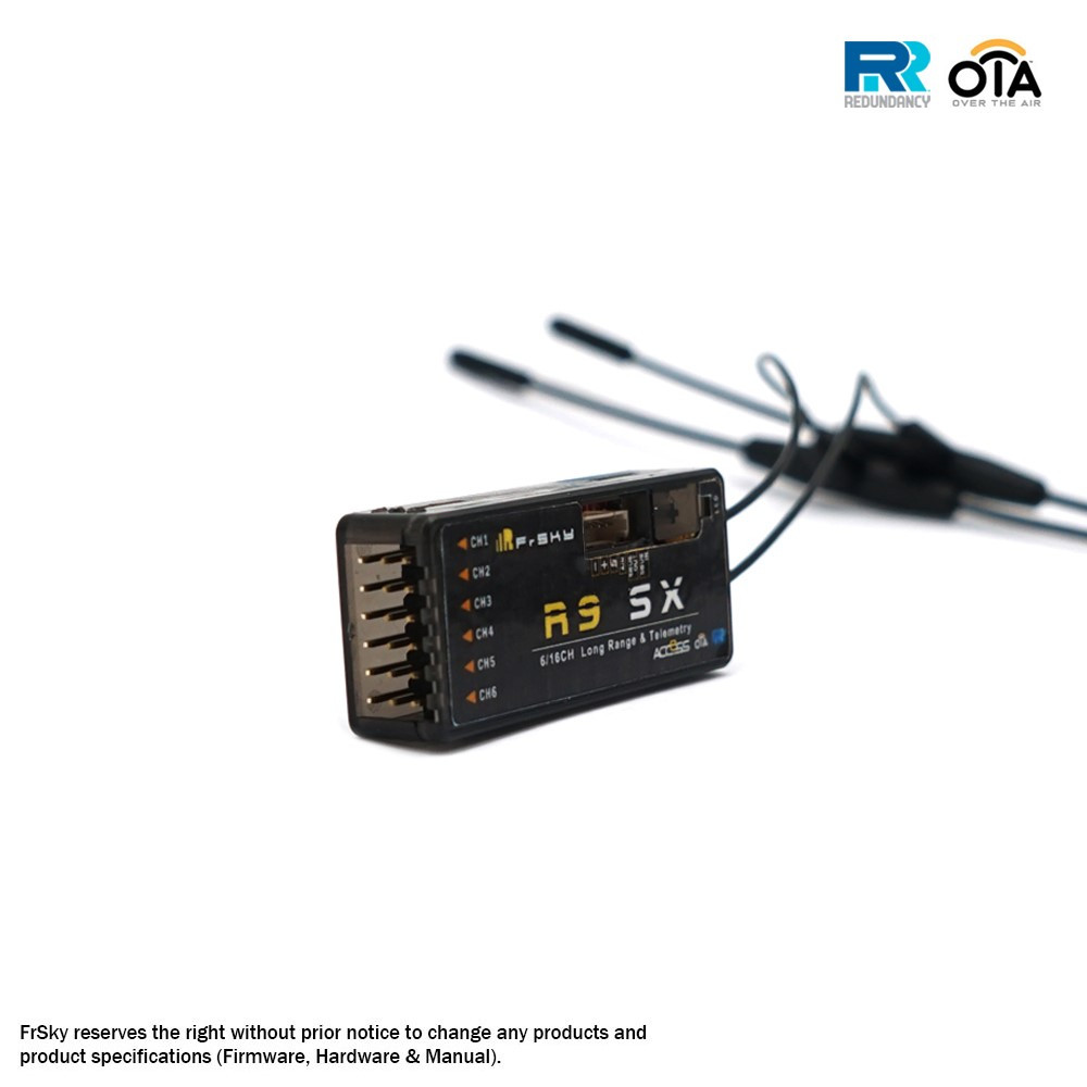

                    Ed,
                    Click image for larger version  Name:	R9SX 6.jpg Views:	0 Size:	80.7 KB ID:	178231
                    Not sure how familiar you are with 6 channel FrSky R9SX receiver, but I have a question about the antenna system. It shows it has two antennas. I am assuming these antennas remain INSIDE the cylinder, and do not have to be installed outside?
                    "Firemen can stand the heat."
                    SPECIAL NOTE:
                    Ed,
                    I Just emailed Bob, and he confirmed that the receiver and antenna are inside the cylinder. So, I just purchased the FrSky X-18 Transmitter and the R9SX 6 channel receiver from Bob. WOW! Looking forward to this new technology! Thanks again for all you help Ed!
