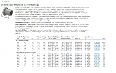

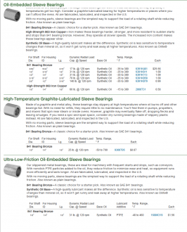

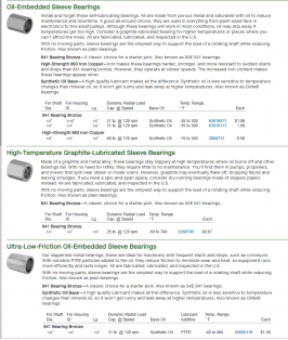

    If you reside in the USA, McMaster-Carr. Shipping is expensive so I batch my orders. Click image for larger version

      You are my hero of the day, good sir: not only am I in the US, I can actually drive to their facility and pick up orders as I'm local to their warehouse.
