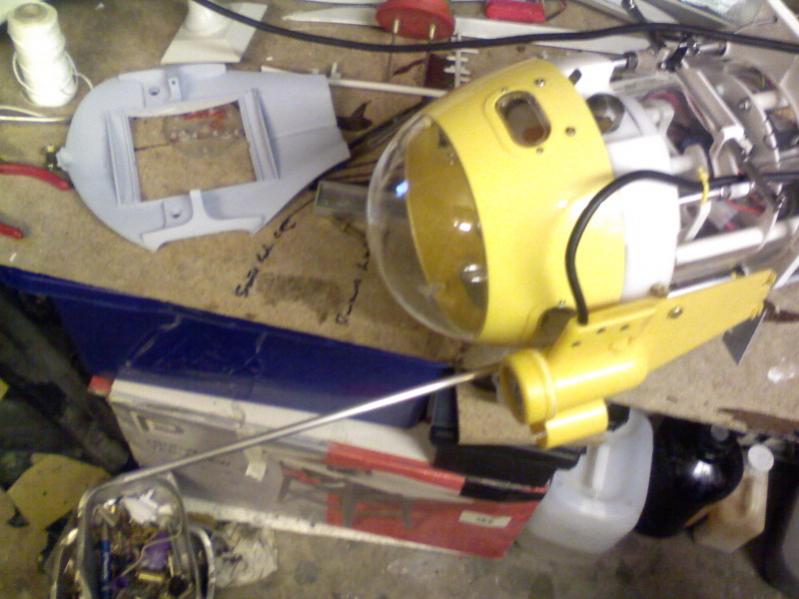

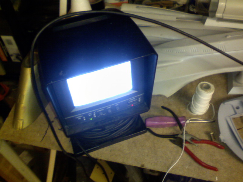

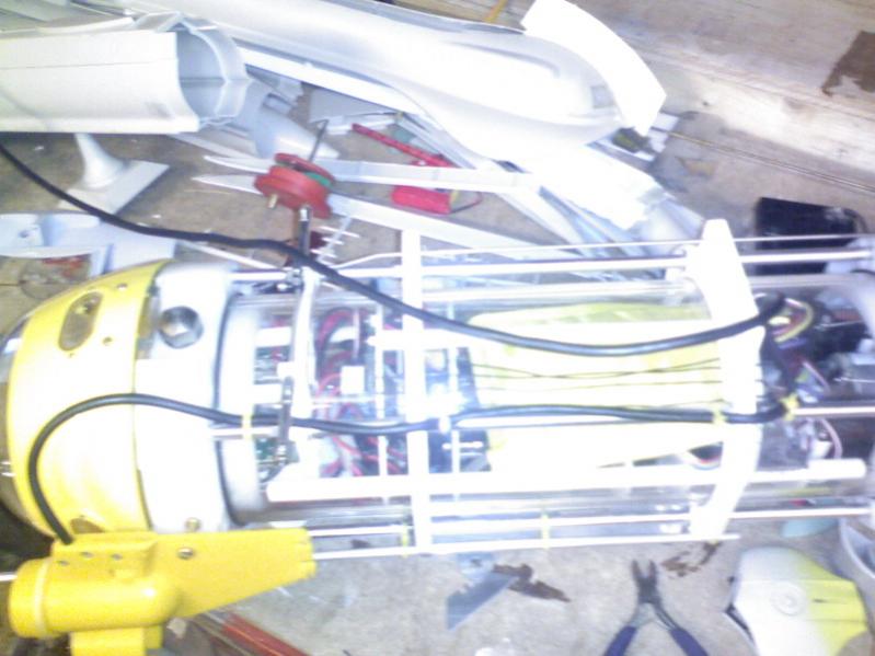

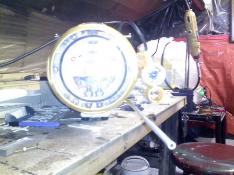

              Hi Guys.
              Only lost one boat,it was a surface vessel,I came up with the following.
              One thunder tigre neptune with a 0lux camera,length of tube attached to SB1 carrying a grapple made from three sea fishing hooks with a float attached,sliding fit in tube and a spool of twenty pound fishing line.
              The camera was cheap on offer at maplins comes with a twenty metre cable power supply and minitor.
              SB1 is tethered so not much chance of that getting lost.
              Spent two days looking for my boat but I got it back.
              Ray

                • 14012
                [QUOTE=RAY;2794]Hi Guys.
                Ray
                Now THAT is neat!
                Did you use float to help buoy the coaxial cable? What was the maximum depth you could maneuver with the umbilical? And how was maneuverability overall with the umbilical?
                Details, ******, I want details!
                Well done, sir!

                    Hi David.
                    Details you shall have.my lost boat was in about twelve feet of water,I saw it go down but sods law they never go straight down hence two days to find it.
                    The SB1 has been called a toy by a number of modellers I prefer to call it a tool, the ready made virsion comes with poor radio fitted,if you buy the kit and good radio it costs about the same, and you know its going to work.
                    It will happily pull the coax without any floatation,it will also go down beyond ten metres.
                    You have to put a float on your grapple in case it comes off what you have attached it to,you dont want to be pulling the bottom of the lake up.
                    The camera and monitor will run continuous for at least four hours.
                    The spool of line is a standard spinning reel job that fits on a spigot, once you have hooked your boat (prop) or something just back off,it will unwind all the way back to you.
                    Just remove spool from SB1 fit to reel wind it in,spool of line and grapple ready to go again....KISS.
                    And I for got to add,I had as much fun recovering my boat as I would running it,if the navys can do it real time why not we do it,model subs are not cheap.
                    Ray
