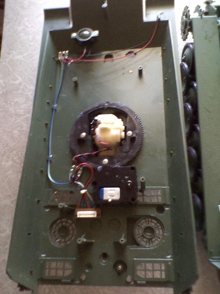

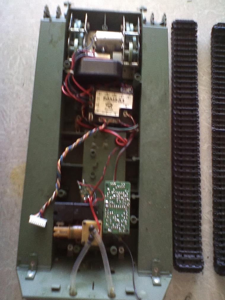

        Okay I had to pull the tank apart for spraying and detailing so I thought for those who have not seen the inside of a R/C tank I would describe the tank we will be working on. The R/C setup in all tanks is mostly similar to this tank.
        Here is the inside of the Heng Long Panther G we will be working on.
        You will see starting at the rear of the photograph, two plastic tubes going into a unit. This is the Smoke Unit which you fill with the normally supplied smoke oil. Be very careful when you do this as too much oil will burn out the copper wire in the unit that creates the smoke. I use the stuff they use in electronic cigarettes.
        Next to it is the radio circuit board.
        Moving downwards is the MFM or multi function unit, the main control unit for supplying power to the turret control, motor running and speeds like an esc, sound, you will see a small speaker attached by wiring to the mfm.
        2 brushed motors with gear boxes and lighting functions if the tank is equipped with an IR setup.

        The turret.
        You will see in this photograph a small motor housed in a unit which fits into the Turret Ring.
        This controls the rotation of the turret from left to right. It also locks the turret when it reaches it,s longest turning circle so the turret just does not go round and round.
        In the middle of the turremt ring is the unit which controls the Air soft mechanism for the loading and firing of the plastic 6mm yellow balls from the cannon.
        It also controls the up and down movement of the barrel of the cannon and wiring for the lighting of headlight and machine gun.
        All main parts are replaceable if something goes wrong with it appears no shortage of spares. Upgrades using metal like gearboxes,wheels,suspension,tracks and various body bits but BEWARE, I upgraded a Tiger 1 Heng Long brand which I purchased for 199.00 Aussie dollars and by the time I had finished the Upgrades it owed me 700.00 roughly but boy didn't she look the good. I have since sold her and that was that.

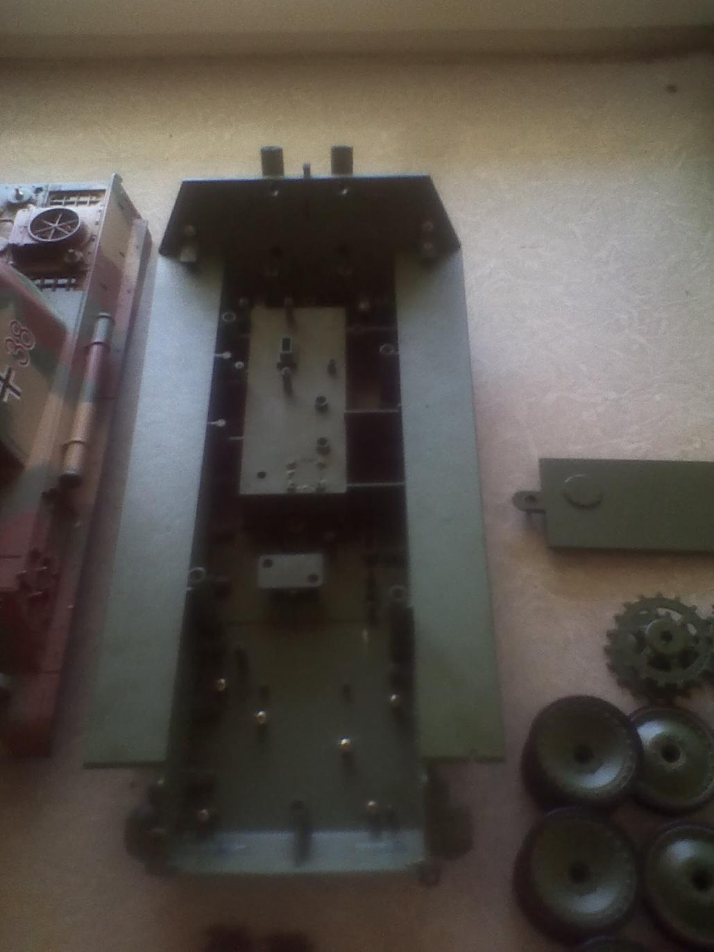

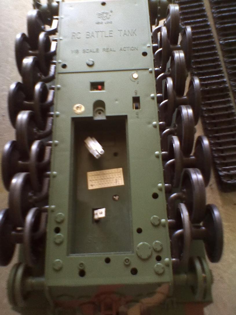

        Moving on, the hull underneath.
        Frequency crystal holder, 7.2V nicad battery holding position, On/Off switch, in Red Smoke Unit On/Off switch and the White circle is the Volume control.
        So there you have it. I hope this helps some of you now in the understanding of how our Panther G functions.

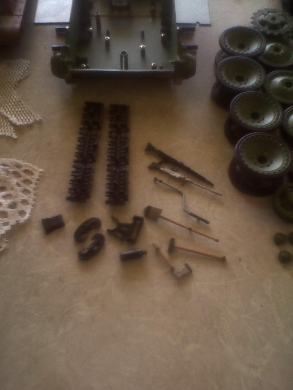

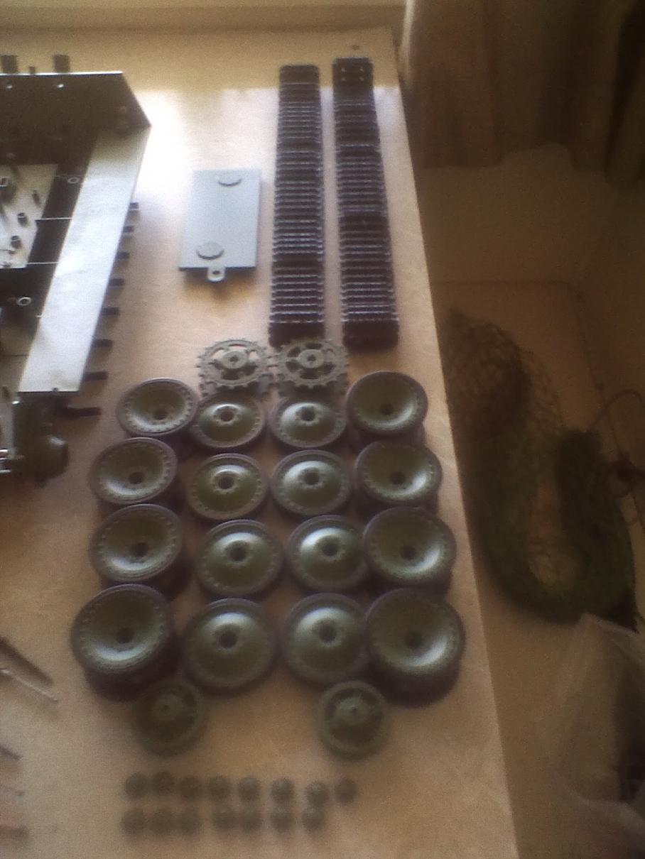

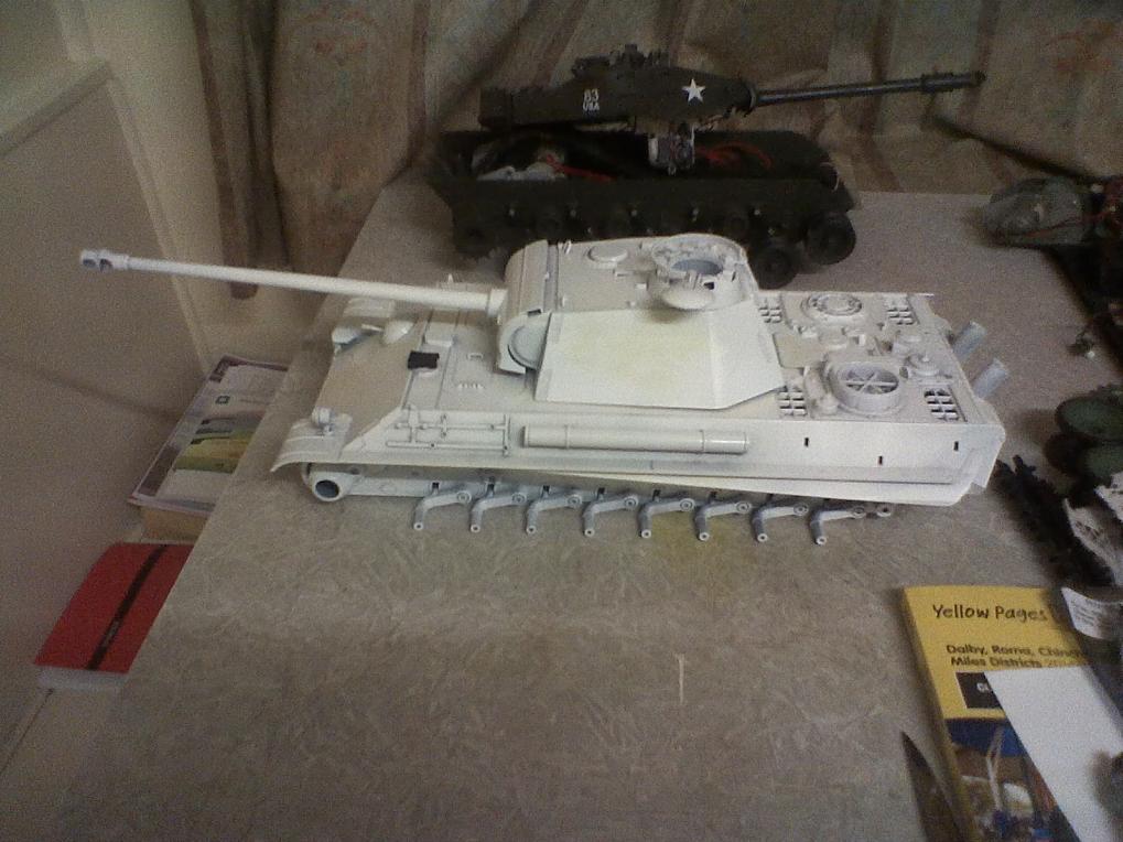

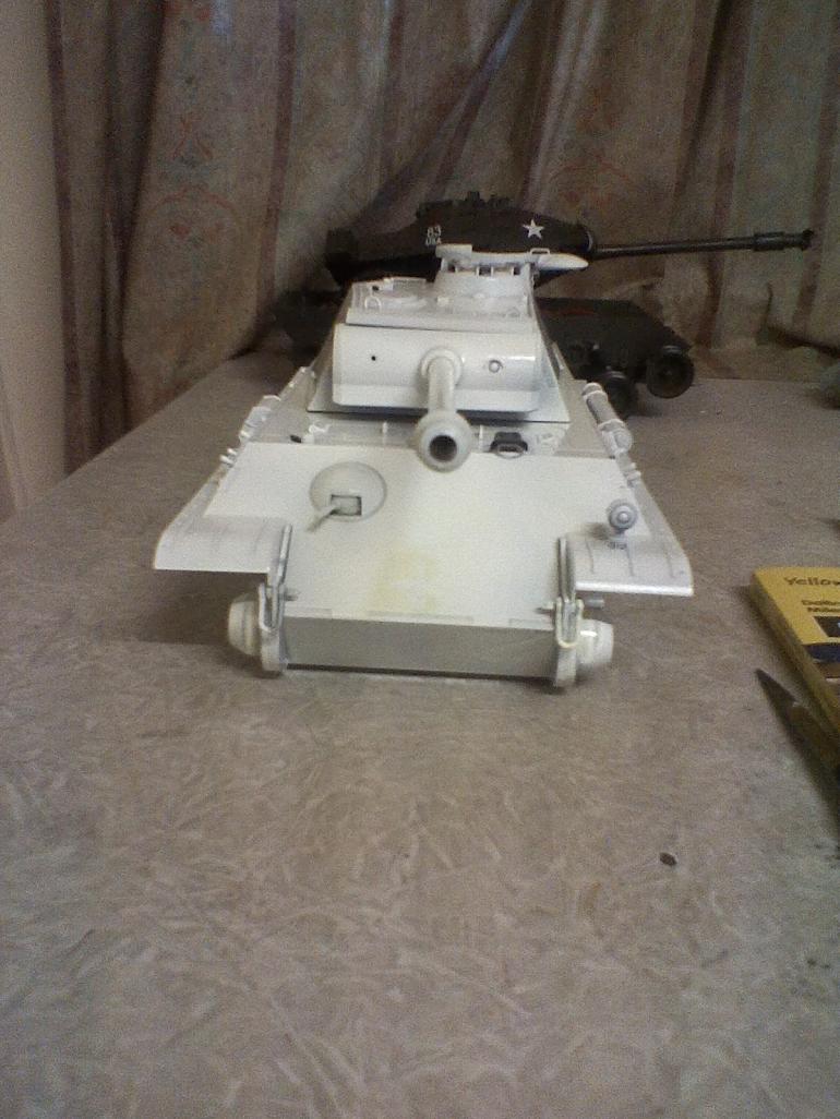

            Good morning to fellow modelers once again.
            Continuing on with our Iron Coffin the Panther G.
            Here you see the wheels, tracks now removed from Hull. Looks different bare haha.

            Bottom of the hull stripped bare
            Some of the tools, jacks, air intake etc.
            Top hull and what I will be using as templates for some of the camouflage templates.
            Now she is stripped and ready for painting, I thought why not so I am going to add some metal upgrades.
            I have a mate in the UK who will be taking of the following.
            Crew
            Correct decaling for the Panzer group that we are modelling.
            Whatever else he comes up with.
            I am in charge of the painting including crew.
            Upgrades to be ordered, metal gearboxes, metal tracks and drivers and sprockets, brass mesh and grilling and other metal upgrades for realism, chains, towropes, buckets, German helmets etc.
            The reason for gearbox upgrades are because of weight. When I first got the tank, after a few runs I noticed a slip sometimes from the Nylon gearing. With the weight we are going to add including the battery, I don't think a Nylon gearbox set up will last too long so that is why an upgrade is necessary in this instance. Cost 38.50 plus postage.
            Okay so Remember Rome wasn't built in a day haha so when things happen I will continue.
            Cheers for now - Mcgowan1

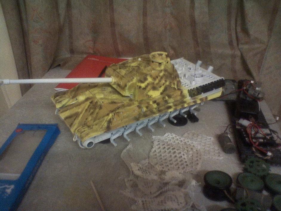

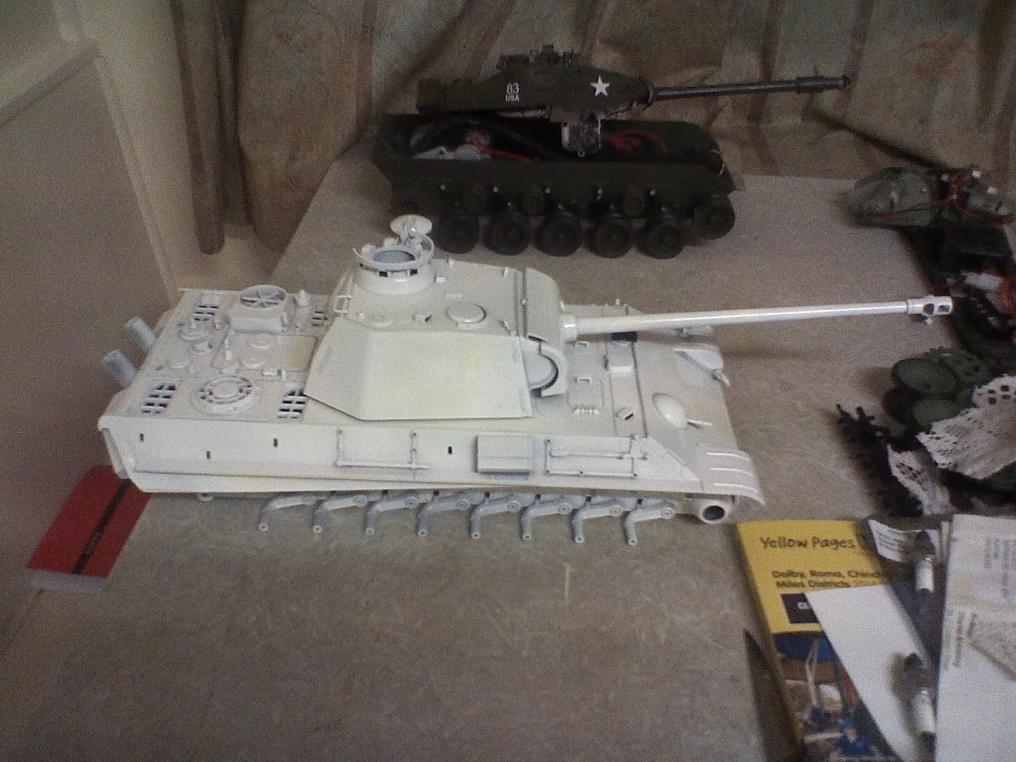

                Hello fellow tankies and modellers, this is just a quick one.
                Here is our Panther G with it's first coat of winter camouflage.. There will be a small break now while I order some paint and parts as discussed previously.

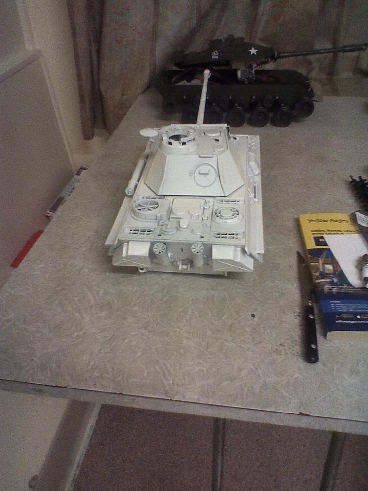

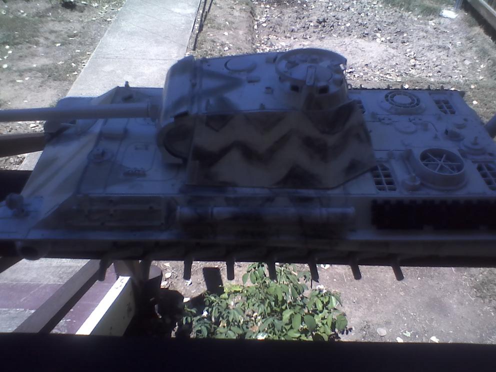

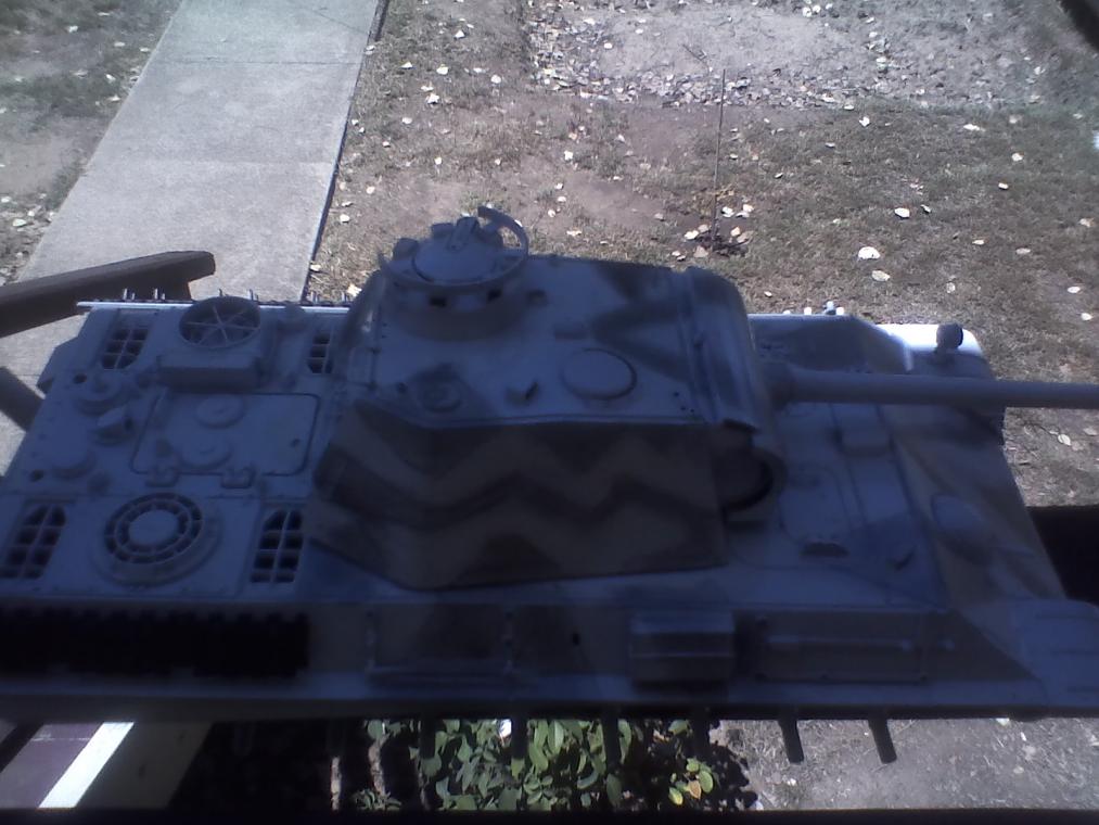

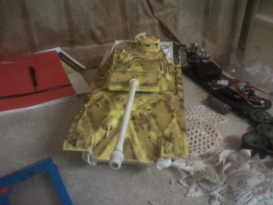

                  Hello once again, continuing on. I have started work on our cammoulage pattern. It will be a Panzer group in Winter, Warsaw Poland, 1944-1945.
                  I always start my camouflage using a pencil. When I an happy with what I am doing, I fill in the pattern and then use my finger to rub in the pencil work. I do it this way because if any errors are made I can erase them and then correct or rework the pattern I am trying to achieve. When happy I have a ready made pattern to paint over. This works for me 100 percent on the tanks.
                  Rear view
                  Front view
ID:	90277Click image for larger version
                  Right and Left views
                  Okay hope you can see the pictures OK, if not let me know and I will try again. More pencilling will be done when I paint the parts I removed and the accessories I will order in white. McGowan 1.

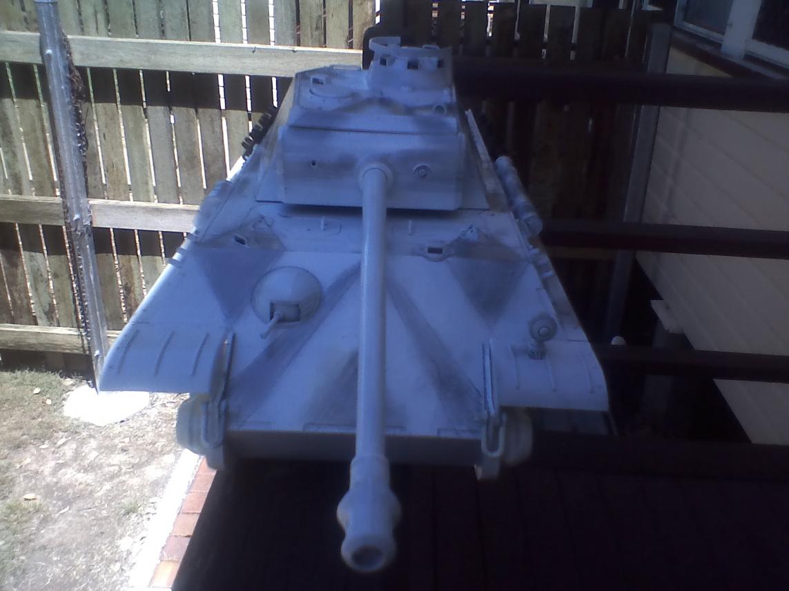

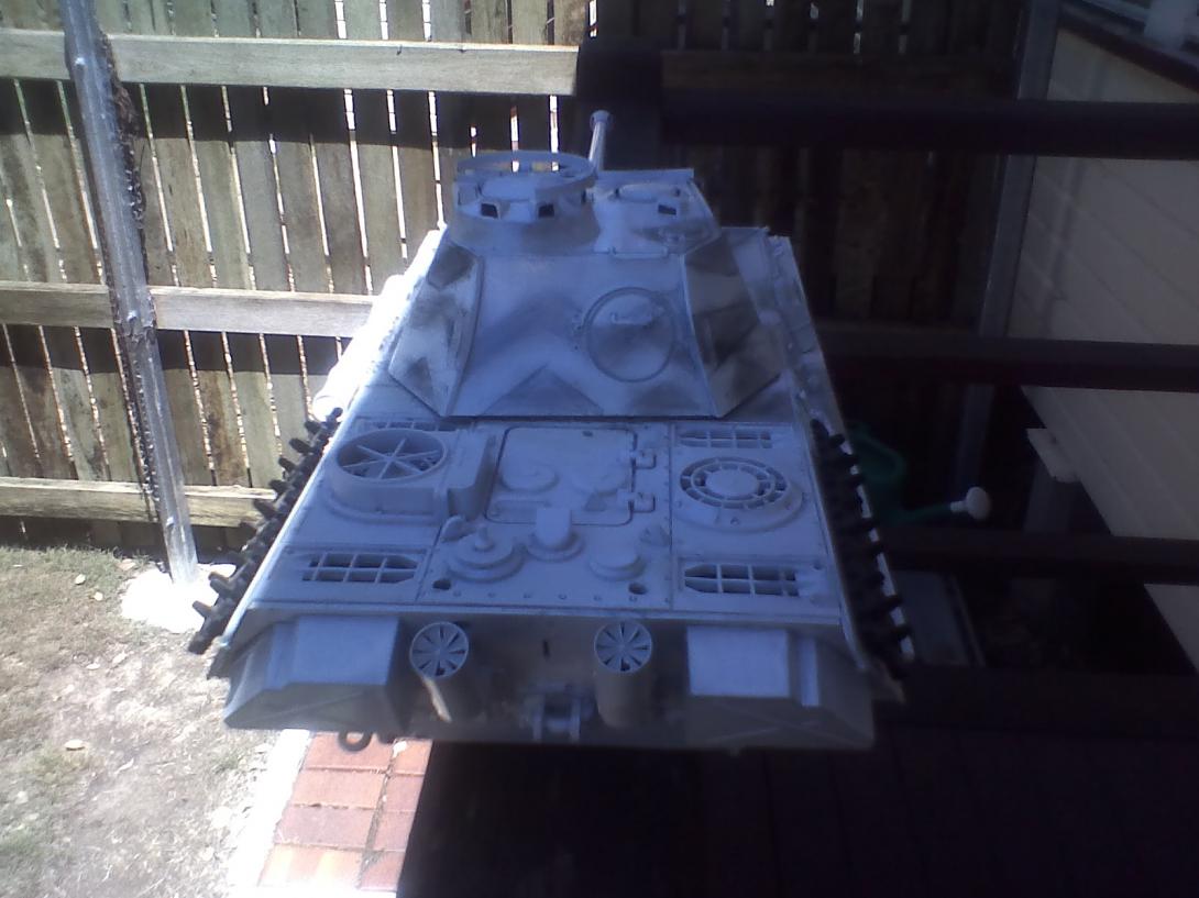

                          Continuing on here you will see the camouflage pattern start to be worked, the lighter areas will be done in olive to tone in. You can see the patters starting to emerge now. It still has plenty to go haha but will start more mixing of colours as we move on.
ID:	90280Click image for larger version
                          There you are for the moment. Cheers.
