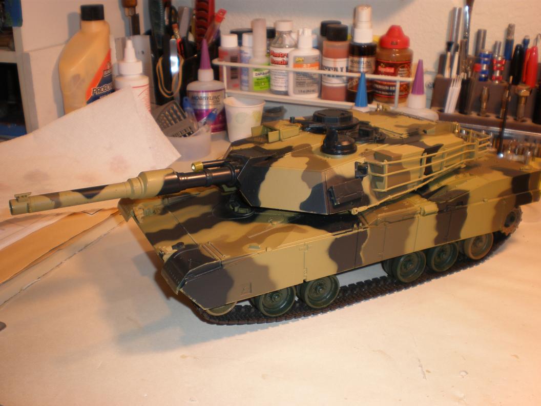

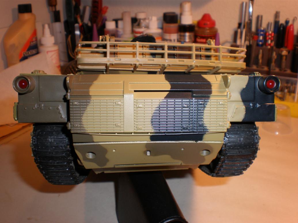

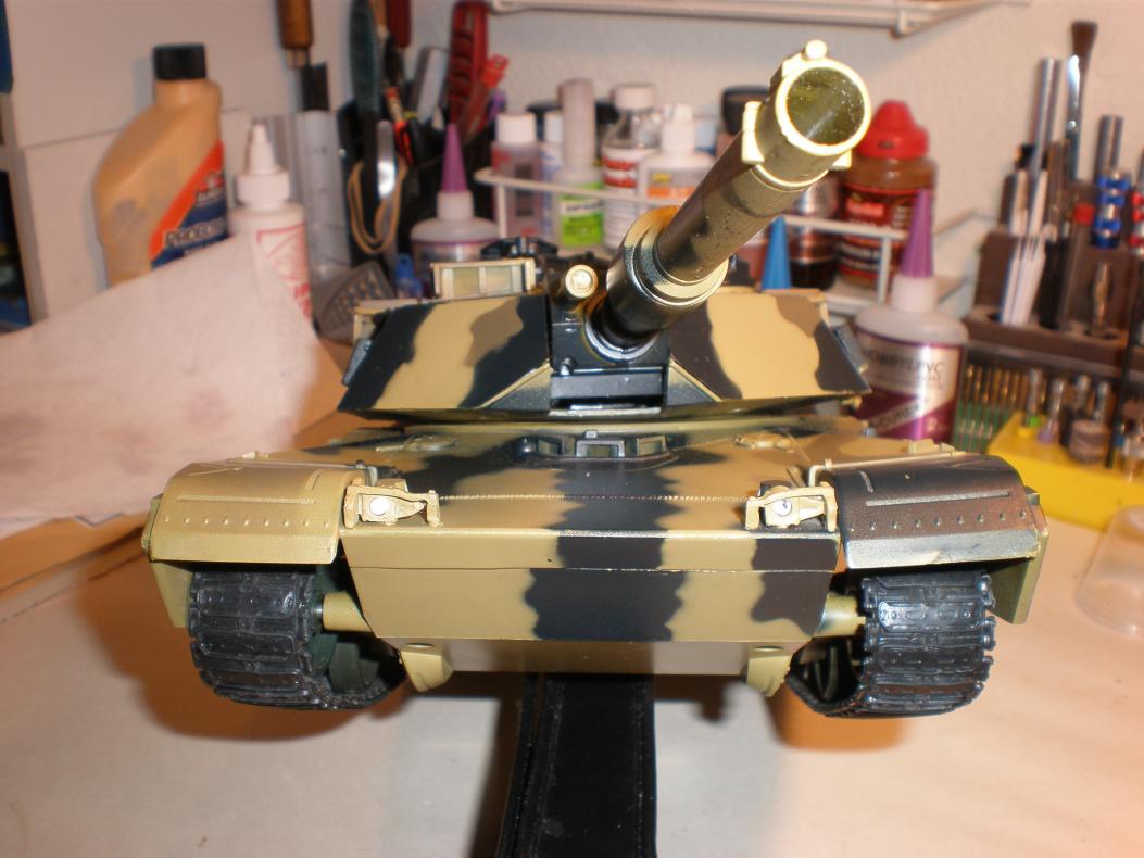

      G'Day CA, and all!
      The first Leopard arrived yesterday! Came to me at under $20US, including shipping!
      Pretty complete except for the controller and battery charger! Both readily available
      pretty inexpensively!
      Some photos of her as she arrived:
ID:	91035Click image for larger version
ID:	91036Click image for larger version
ID:	91038 Click image for larger version
ID:	91037Click image for larger version

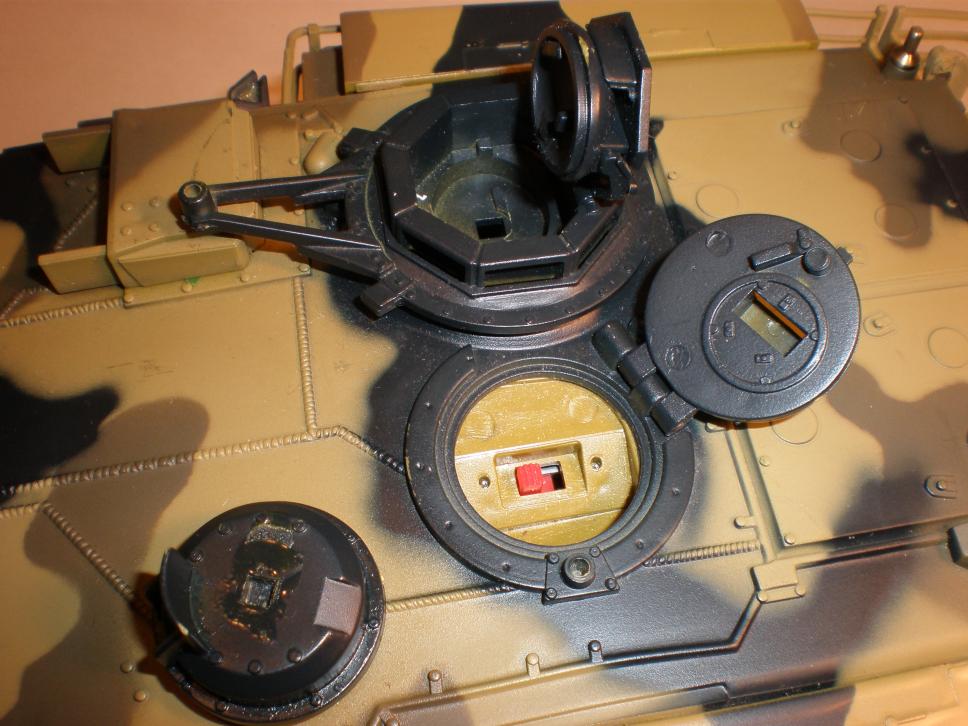

      front left side rear right side top
      Not in bad shape at all, except for a couple of "bits" missing from the top of the turret!!

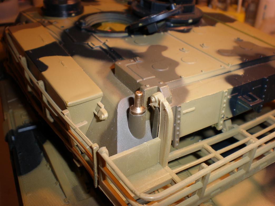

      There are short brass "rods" at each of the rear corners which, I'm guessing, have something to do with antennas?
      This is the left rear corner:

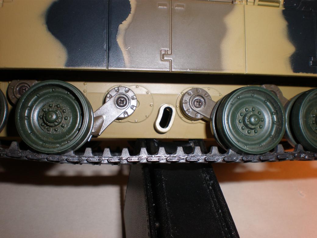

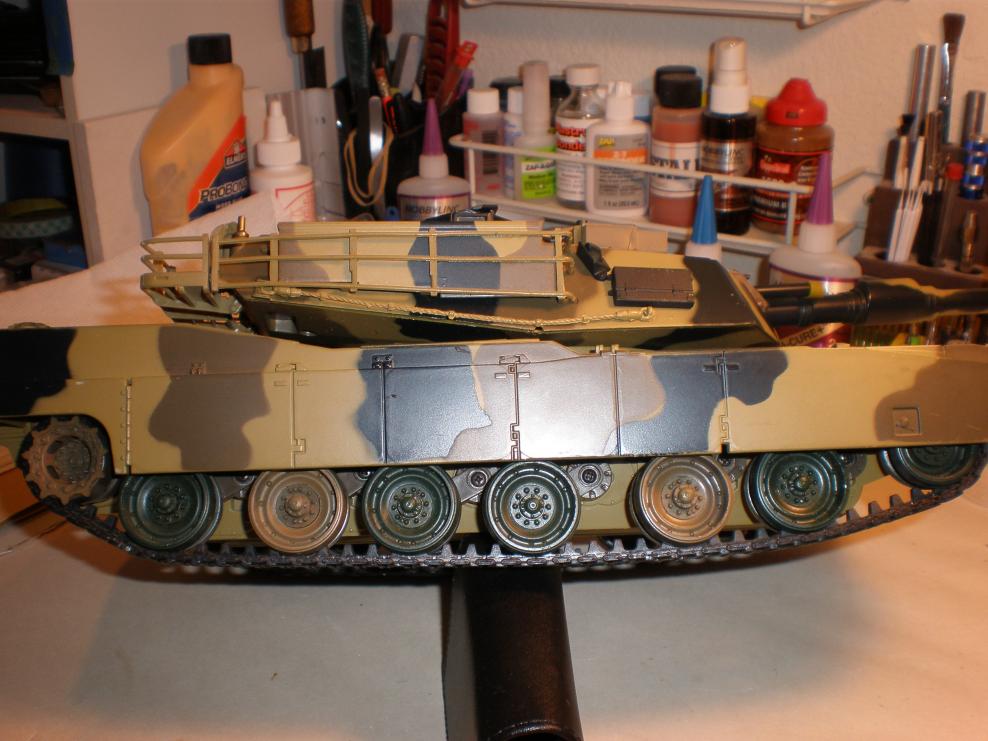

      She's also missing a track idler from the left side:
Name:	missing idler.jpg
      Other than that, I'm pretty pleased with her!!
      The internal NiCd battery appears to have some power left! When switching her to "ON", the
      "headlights" flash in an amber color, and the rear "brake lights(?)" flash red. Not exactly sure
      what that signifies, as she didn't come with a manual, either!

            The Brass fitting showing is an Antenna mount with a detachable wire Antenna which looks like you will have to get or make.

            The Idlers are at the end of the tracks. At one end you will see what they call the driver and the other end the Idlers
            Looks like you have a SUSPENSION spring missing from yours as your wheel is in the wrong direction. Take a look at the SUSPENSION arms of other wheels, all wheels must be in the same direction, your one is backwards.
            So when you do your FIDDLIN look at the way your wheels are set up and note the Drivers which are attached to your gear box at the Front of the Tank and then, the Idlers which just balance out the whole track affair at the Rear.

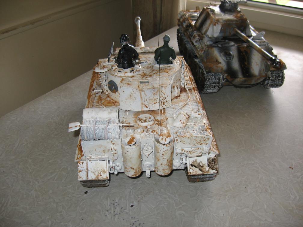

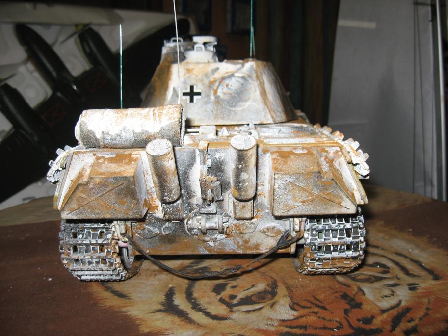

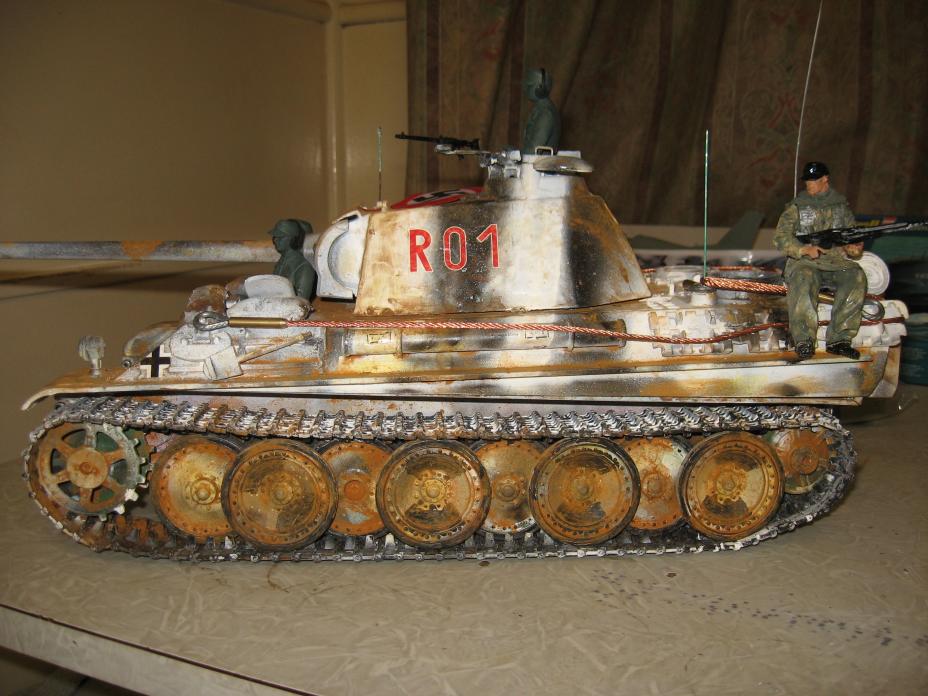

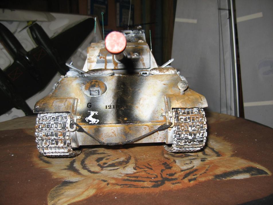

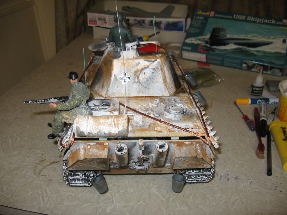

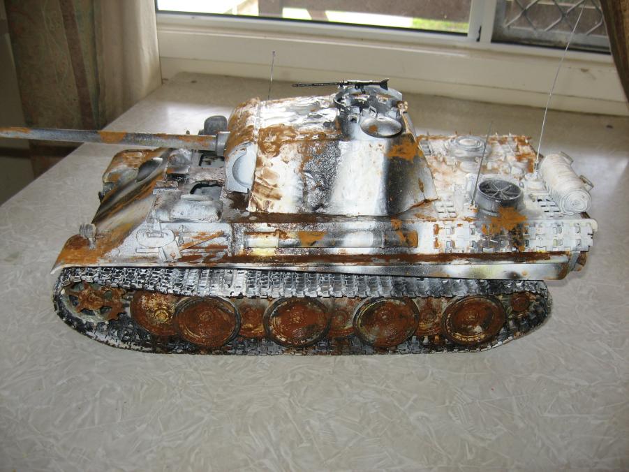

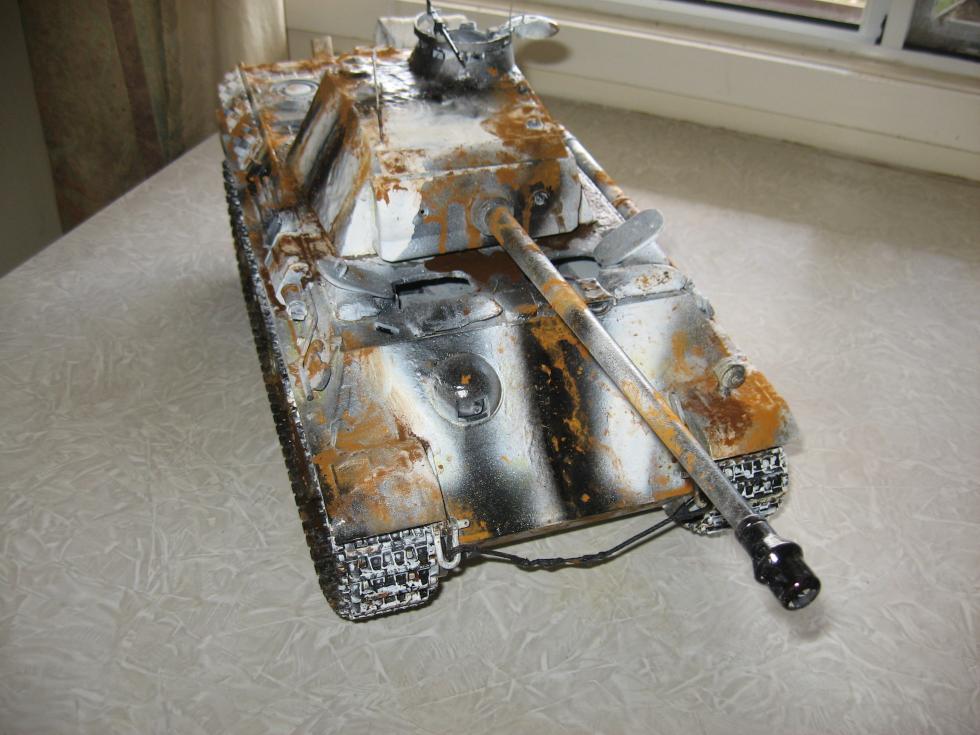

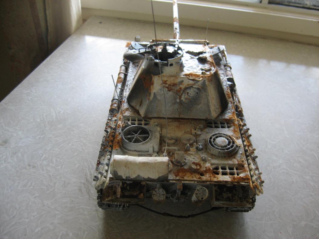

            In answer to Vice Admiral Trout's question. I just use water from the tap, put into a spray bottle, place pads where I want them and then, check now on the pads and give them a spray if I think they are drying out. You will notice the pads start to rust and this is when the MAGIC happens.
            Here are pictures now of our Panther G and the Tiger 10 all completed as far as painting and rusting are concerned. I can now go over areas if I think there is too much rusting with a wet rag or whatever is at hand and wipe off what I think is too heavy.
            All in All from what you see in the pictures the process was started 4 days ago, Sprayed now and then with water, then the pads were removed and the models were left to dry.
            Remember to do one side at a time and perhaps leave the top of your model until last to get the water/rust run effect.
            I will now spray with clear when finished drying properly.
ID:	91046Click image for larger version
ID:	91047Click image for larger version

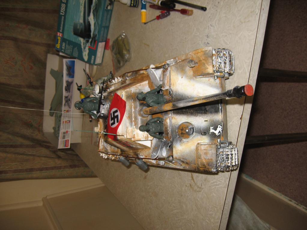

            Our Panther G.

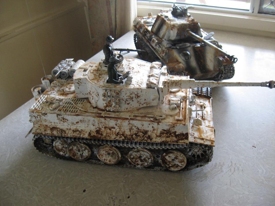

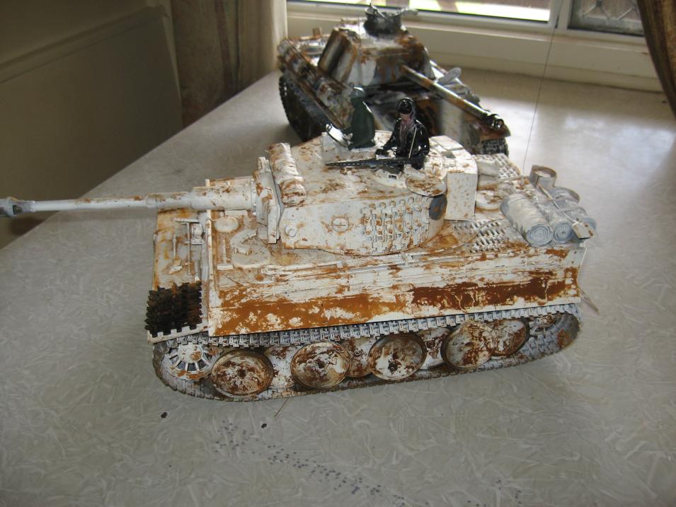

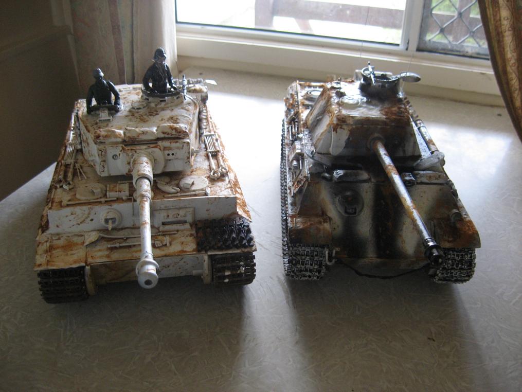

            Tiger 1 and last picture the two tanks together in their Winter/Rust Camouflage.
            Now for the Tiger 1, I had some of the white spray paint left I used on the Panther G, so I sprayed her in white, added the rusting and cost 6 steel pads less than 2.00 and that is the final result. No more, except foliage and decaling will be done to both tanks as far as painting goes.

              My Apologies, I did forget to mention the Rusting on the tanks is still wet so a lot of what you see will change colour as drying out.

                One entire wheel is broken off of the left side!!
                It appears that the wheel was hit on the side, at some point, and broke off of the the link!
                I have found them on the web, pretty cheap, but the shipping costs from the U.K. are crazy!!
                Oh, well!! At least I know that they're out there!!

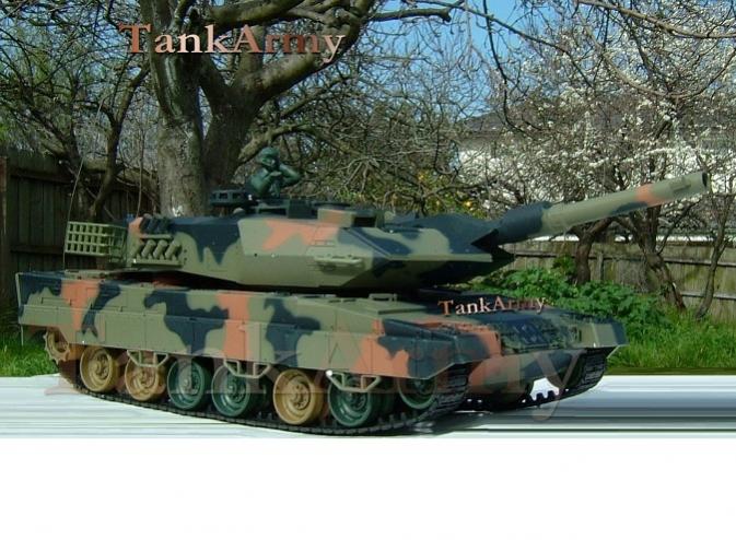

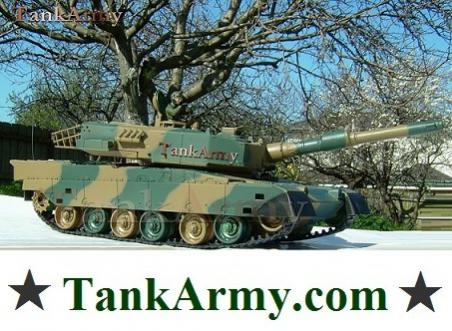

                  CG I just noticed the words Type 90 Leopard. There is no such tank it will either be a Leopard or a Type 90 used by the Japanese self defence units.
                  Looks like you will have to wait until the other arrives to sort it all out. I checked everywhere and sorry controller must have gone to the tip. I hate it when that happens. A good piece of equipment not being used then all of a sudden someone needs one.
                  Ah well. Now I will post these three pictures for you to look at seems they or you are getting confused with the different tanks.
Name:	Leopard one twenty fourth scale..jpg
ID:	91053Click image for larger version
ID:	91054Click image for larger version
                  LEOPARD ABRAHAMS T90 OR JAPAN 90 all these are 1/24 scale.
                  Now the wheels will be similar or the same so make the best out of 2 if you can, that might be the way to approach it.

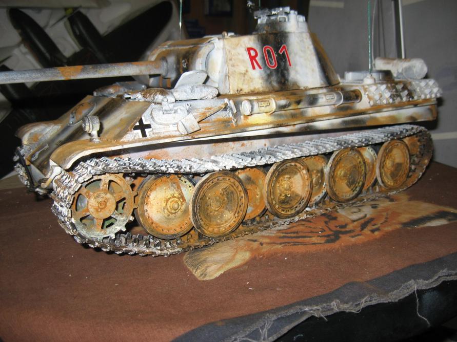

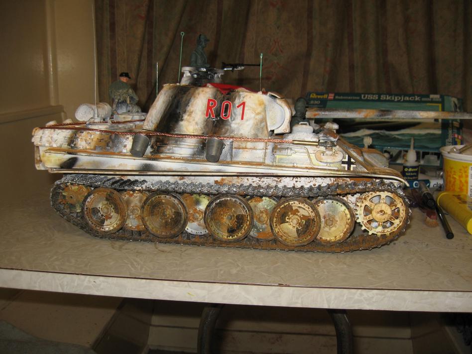

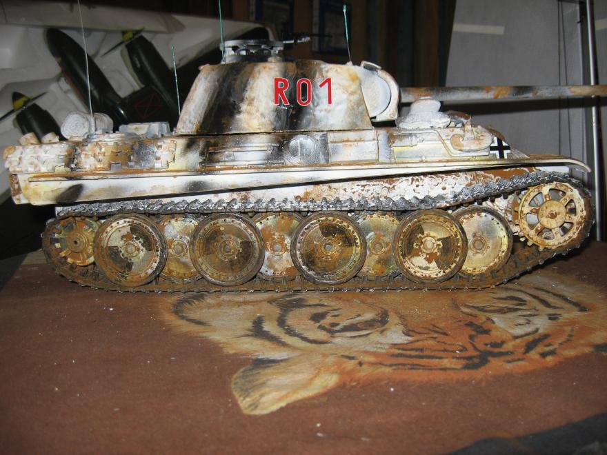

                  I finished rubbing down the Panther G and also I have put on her Decals which to my delight arrived in the mail this morning.
                  Here is how she looks now.
ID:	91056Click image for larger version
ID:	91057Click image for larger version
ID:	91058Click image for larger version
                  There she is as of tonight 7th April.
                  You might be getting a bit sick of seeing it in its different stages with only slight changes but I am sorry it is the only way I can show you what happens on the build.
                  I have checked out with my Dealer and other places for her Upgrades and Cammo so I promise you, you won't see her again until she is completed. I cannot screw down the top hull yet as I have the new improved smoke system coming for her and once I fit that and check it's operation I will screw down the top hull and commence with the foliage.

                    The second tank I purchased on Ebay was advertised as a Leopard, but a photo shows the manual
                    for a Type 90, so, being a complete newbie to the tank scene, I just assumed.......... Hmmm! There's
                    that terrible word!! Hah!! I do thank you for the clarification! Comparing the photo to the ones that
                    you posted, appearance-wise, it looks to be a 90!!?? Or, not!!! Hah!!
                    The only "mishaps" listed for this model was that she has a broken track, which was stapled back together,
                    and that the barrel seems to be "jammed"! Otherwise, it looked to be in pretty decent shape!!?? We shall see
                    upon her arrival at my doorstep!! Hah!! Will update you when I'm able to!

                    The Panther G is looking really good, Sir!! "Wintery", she be!! Quite nice!! I like it a lot!
