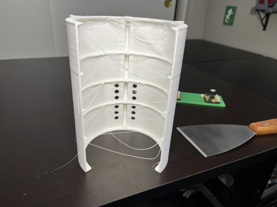

    I knew coming in that I was going to have a few printing issues. One was going to be the wall thickness. The original STL files at 100% size has a 3mm thickness. I was very pleasantly surprised that at the 65% size that I am printing the walls came out to 2.20mm, which turns out to be great. Looking at the photo below.
    You see that I am dealing with some stringing, which again is no problem. I chose not to use any supports in this piece (which was my test piece) to not only save on filament (310' down to 134') and also bring the print time down from 23 hours to 12 hours. The little amount of time cleaning up the strings is worth the savings in time and materials.
    Other than that the overall piece looks great! I would say that the reduction in size for me is going to build into a really nice Seaview and the money spent on the files very much worthwhile for me!! :.)

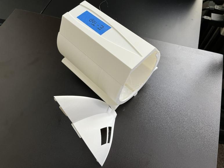

                    I have a few more photos of my Seaview build progress.
                    The photo above shows 3 new sections that I finished up yesterday. The first part that I built (Previous photo) with all the stringing from the printing, was just not satisfactory for me. I made the decision to build all future parts using any and all supports required. The extra filament and time that it takes to DO IT RIGHT are well worth.
                    The photo above shows the bow section parts starting to come together. One of the nice things I noticed about each part has the part name printed on the inside of each so that you know what the are. Nice touch. I am very pleased with hown the parts are coming together.
