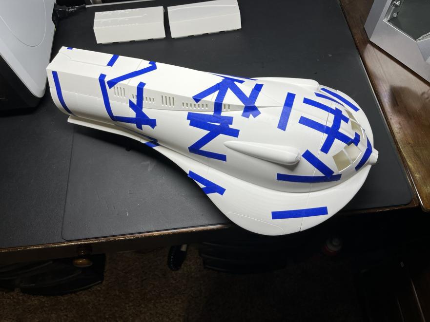

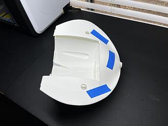

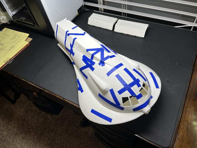

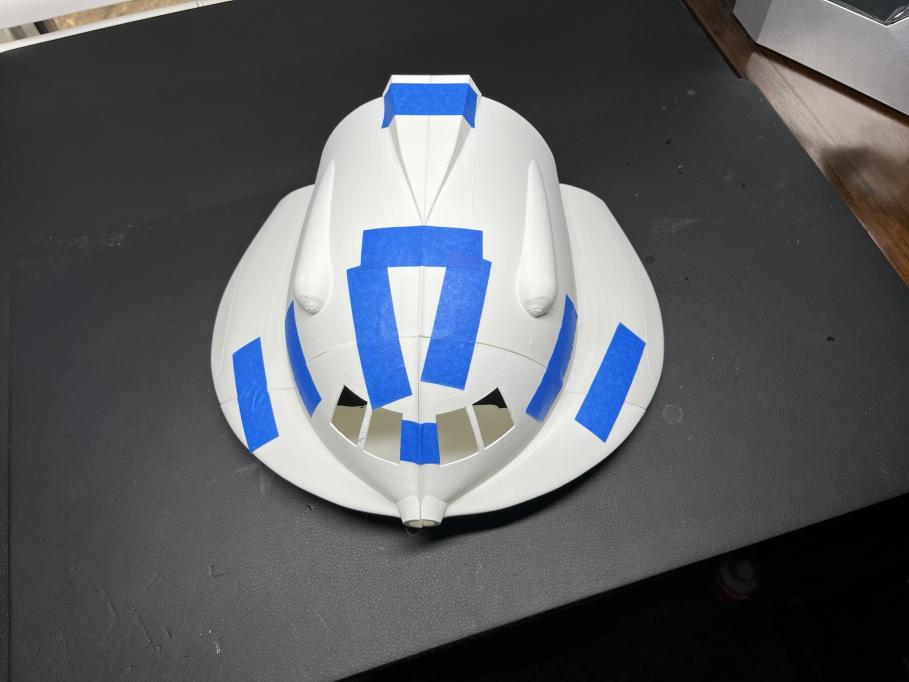

      After 40 hours of printing time, I now have the bow section complete.
ID:	176563 Click image for larger version
      All four sections came together very well. Ounce it is glued up, it will require very little filler.

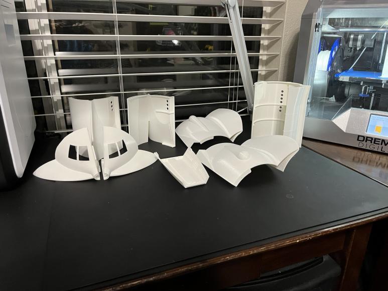

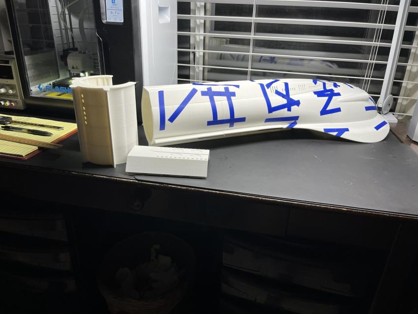

        Work on Seaview today..
        The parts are starting to pile up! I made the decision to go back to supports. As mentioned before I was getting a lot of stringing and the overall finish just did not appeal to me. I have had to add 4 to 6 more hours to the run time and additional PLA to the parts, but the final results are much better.

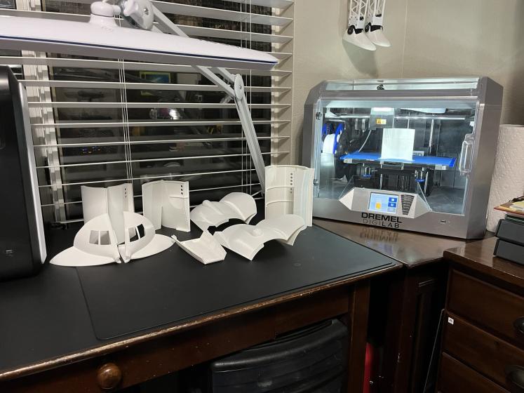

              Progress report on Seaview.
              I do hope you guys are not getting tired of these little reports with not much showing!
              The major hull parts are taking between 20 and 24 hours to print, so major progress is a little slow coming.

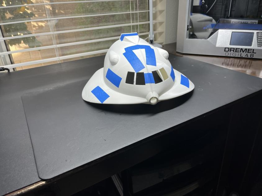

                        Just another photo show the progress on my Seaview!
                        More to come. I would like to get all the hull pieces completed before I start glue up..

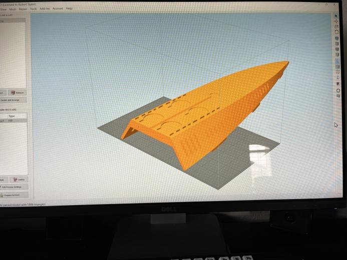

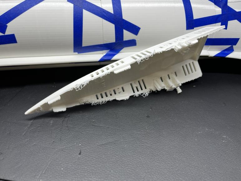

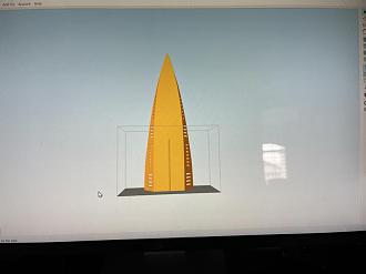

                          Just a little in sight into the printing process of the Seaview.
                          Click image for larger version  Name:	SEAVIEW 10.jpg Views:	6 Size:	43.2 KB ID:	176729 Click image for larger version  Name:	SEAVIES 11.jpg Views:	25 Size:	34.3 KB ID:	176730

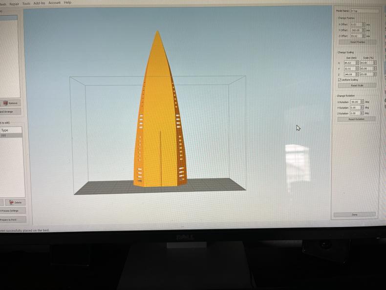

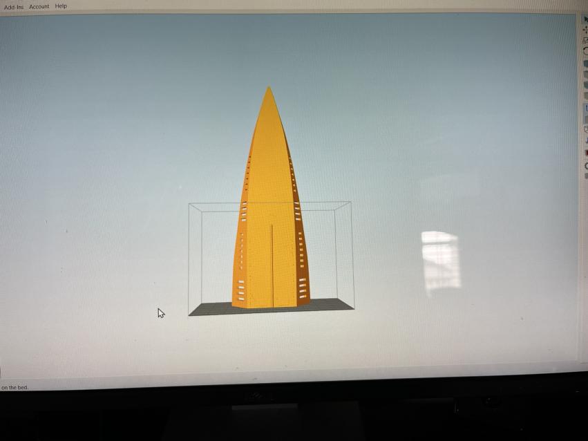

                          When downloaded H-upper or top. I could see right off the bat that I was in trouble. The photos above are showing 100% size. I thought well OK, no big deal, we need to reduce it down to the 65% No problem right! Wrong!
                          Click image for larger version  Name:	SEAVIEW 12.jpg Views:	6 Size:	42.1 KB ID:	176732

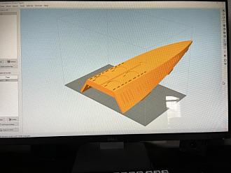

                          This was scary now, at 65% the "Z" axis was still to tall, and was not going to work. Then I really got lucky!!
                          Click image for larger version  Name:	SEAVIEW 19.jpg Views:	5 Size:	52.2 KB ID:	176733
                          I loaded it in the horizontal position on the build plate, and it just barely fit, and I am printing it as I am getting ready to post this.. Just a short shot at some of the challenges we can sometimes run into with 3D printing!
                          NOTE: This part did not have enough supports, and it failed...
                          "Firemen can stand the heat."

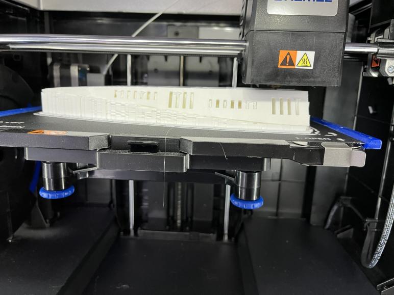

                            Here is a short video of the 3D40 printer in action printing the top piece from the above entry!
                            Video link
                            https://youtu.be/QMPgMUYLNXM​
                              Click image for larger version  Name:	SEAVIEW 21.jpg Views:	20 Size:	58.6 KB ID:	176787 The photo above showing the part layout before printing came out bad.
                              The part did not have enough supports in some of the critical areas. That produced the stringing.
                              Click image for larger version  Name:	SEAVIEW 22.jpg Views:	0 Size:	52.9 KB ID:	176789
                              I added the additional supports, and repositioned the part on the printer bed, this time we have a perfect part.. OK! We can now move on to the next challenge on this build.
