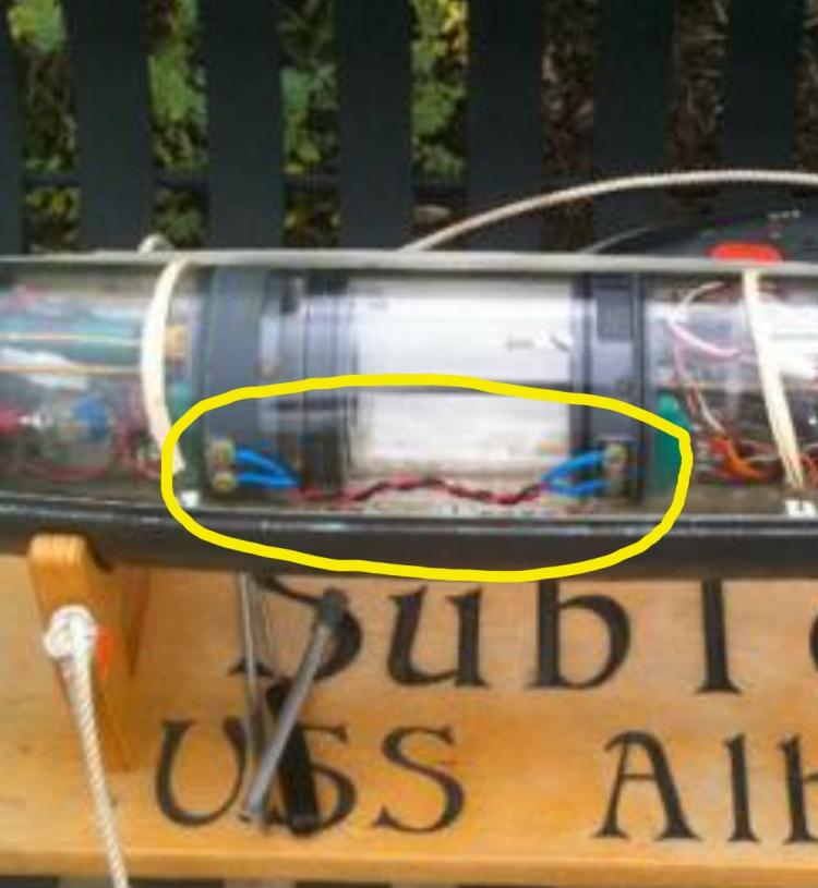

                    • 3662
                    External power cables?
                      • 1634
                      Before the idea of a tube for cables inside the cylinder.
                        • 2620
                        Wouldn’t be able to run any cables internally with a piston tank sized to the wtc
                          • 1634
                          Read what I said.
                            • 2620
                            I did, but I don't understand it.
