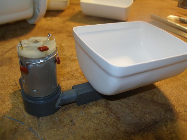

        This could help.
          • 13852
          Recommend never using the kit supplied, vacuformed WTC (or, as I dubbed it ... to Skip's horror... the Sink-o'-Matic). Put a proper SubDriver in there, Bob!

                    I
                    I agree with Dave. I used Skip's system since he provided the boat as a turn key. And it worked adequately after I lengthened the Kits Ballast tank by a 1/2in providing the needed internal volume. But I think ideally a WTC is best way in my inexperienced humble opinion. I will say I never had a casualty operating the model using skips set up, But a WTC is the best way.
                    I like to someday convert her to a WTC and to a contra rotating prop Phase IV. arrangement.
                    Steven
