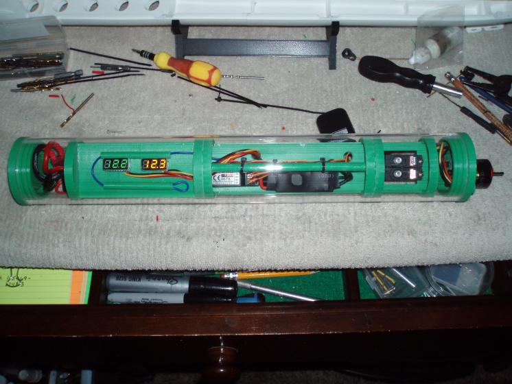

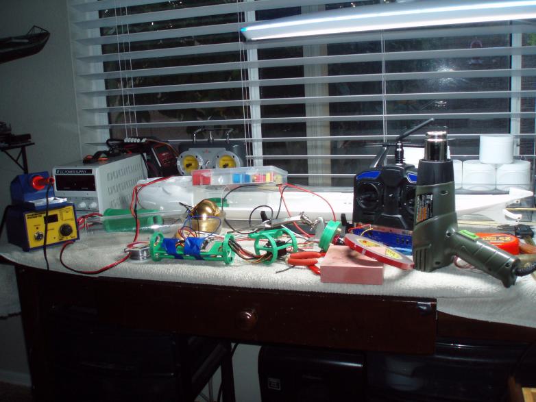

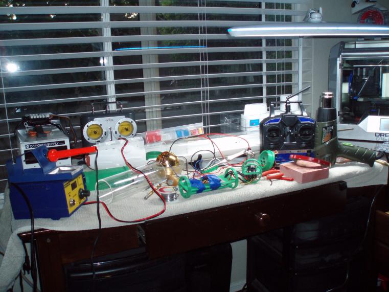

            Today I located and installed all the electronic components onto the mounting trays.
Name:	SM UC 5 U-BOAT 34.jpg
Name:	SM UC 5 U-BOAT 49.jpg
            I also installed all the wiring and soldered up all the required connections to complete a total control circuit! Here to report everything is working!! As you can see this is my work bench and it is a meaningful organized workstation and has served me well!
            "Firemen can stand the heat"

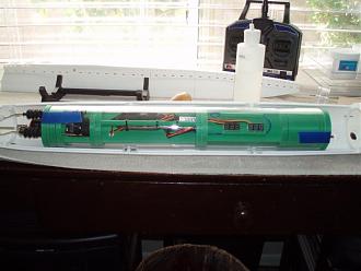

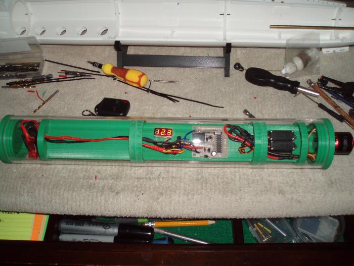

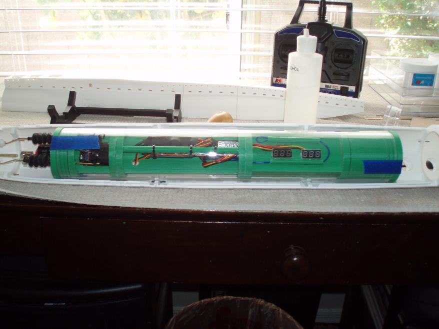

              Tonight, I completed all mounting of the electronics and connected and soldered all the control wiring!
Name:	SM UC 5 U-BOAT 51.jpg
ID:	166518Click image for larger version
Name:	SM UC 5 U-BOAT 50.jpg
              I also mounted digital voltage monitors at the battery only and at the on/off remote only! Overkill, might be, but I like to know what my operating voltages are, plus it looks good!
              All I have left to do is run my prop shaft and run the rudder and stern dive plane linkages. I will be using 1/16' brass rod and using bellows to seal the linkages.

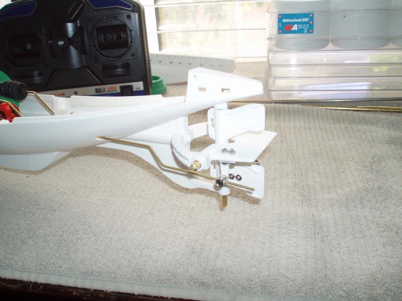

                  Today I worked on the control surface linkages.
                  ​ Click image for larger version  Name:	SMUC 5 U-BOAT 56.jpg Views:	0 Size:	60.2 KB ID:	166688
                  SM UC 5 U BOAT 1 - YouTube
                  https://youtu.be/CZe7EFBKK0g​​

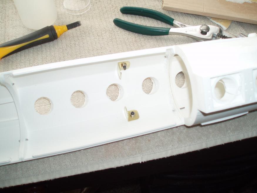

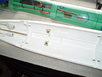

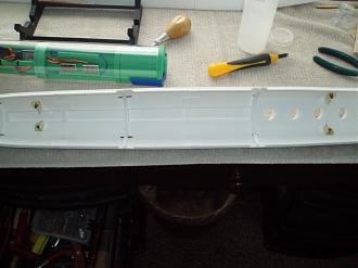

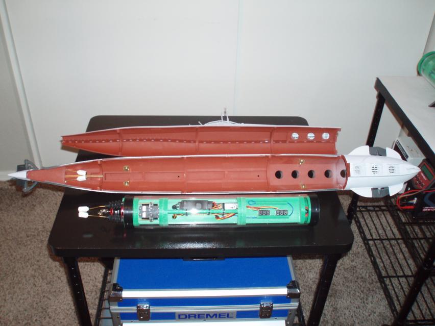

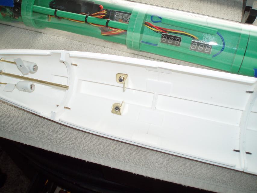

                    Today I fabricated the brass WTC horizontal hold down brackets!
Name:	SM UC 5 U-BOAT 56.jpg
ID:	166928Click image for larger version
Name:	SM UC 5 U-BOAT 57.jpg
                    These brackets are installed towards the bow and the stern of the bottom hull! They will hold the WTC from moving horizontally in the hull!

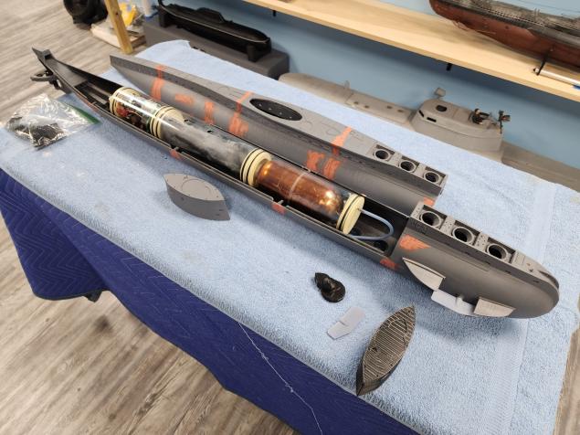

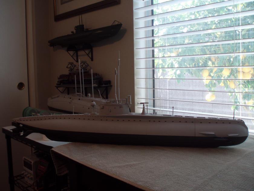

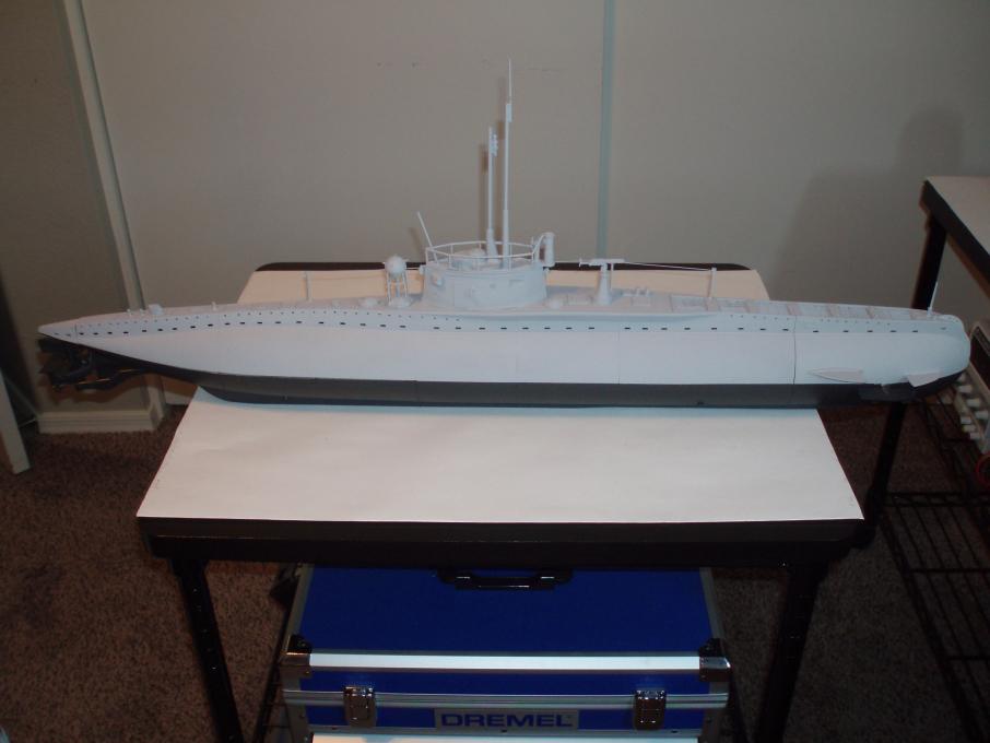

                      The SM UC 5 U-BOAT is complete!
                      Click image for larger version  Name:	SM UC 5 U-BOAT FINAL 1.jpg Views:	0 Size:	60.0 KB ID:	167711
                      Click image for larger version  Name:	SM UC 5 U-BOAT FINAL 2.jpg Views:	0 Size:	53.1 KB ID:	167712
                      Click image for larger version  Name:	SM UC 5 U-BOAT FINAL 3.jpg Views:	0 Size:	43.7 KB ID:	167713
                      Still needs some final touch up paint work and final clear coat. Other than that, this project is complete!

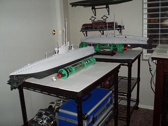

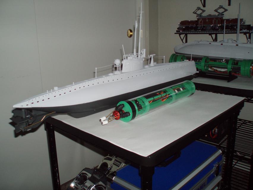

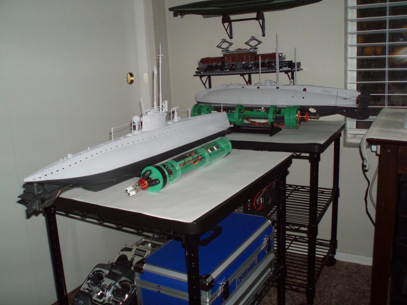

                        I took some last photos of the SM UC 5 to show it with the Holland!
Name:	SM UC 5 U-BOAT FINAL 7.jpg
ID:	167723Click image for larger version
Name:	SM UC 5 U-BOAT FINAL 6.jpg
Name:	SM UC 5 U-BOAT FINAL 4.jpg
                        I am really like to build these pre-world war ll (1800's/ early 1900's) I especially like studying the concepts and history of these boats! I have a gentleman that goes by Karlou on CGTrader that is working with me to do up some more STL files of this type of boat! Thats it for this boat, onward to the ICTINEO build!

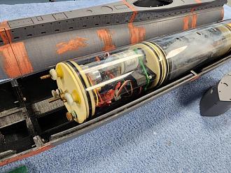

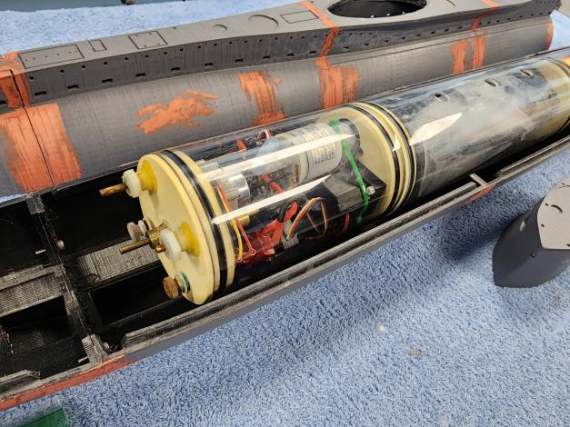

                          #42
                          Great build love it.
                          I just ordered a UC-5 from Bob, will be here Friday can't wait to build her.
                          She is a 3d model from Karlou on CGTrader.
                          I like to chat with you about building her, Onces I get started on her.
                          Bill
