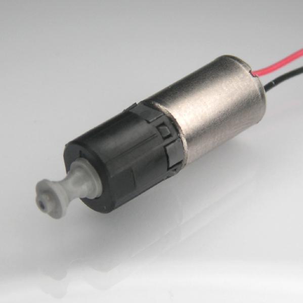

      I found some 6.mm dia. Gear-motors, but they are kinda expensive and they are in U.K. so there would a large shipping charge also.
      I have not figured out the shaft coupling on them yet, tho.
      So ordering them may be a Gamble.

          those motors from the uk sure do look nice.
          Jim

                    I almost ordered some of the 6.mm Gearmotors, from UK, but when rechecking the Specs on them I found that the gear-ratio is an Unbelievable 25 to 1. (I first read it as 2.5 to 1)
                    So I think the prop speed would be too low. :(
                    So I'll be searching more, for a good motor to use. :confused:
