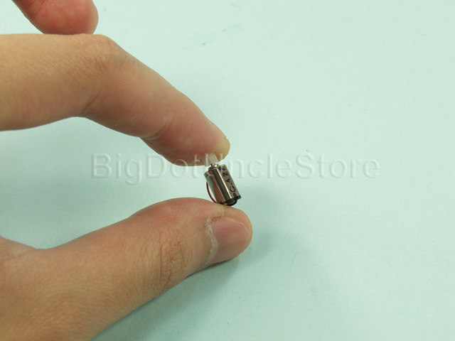

                    Micro Motor:
                    Purchased from eBay.
                    Click Pic:
                    Rick L.
                    • deepseadiver
                      • 297
                      this looks like an ideal motor for the torpedos, im looking for some tubing that i may be able to find with threaded ends i know some one that works with plastics that may be able to help out. this way the torpedo, can be un screwed into two pieces. But i like the one thats on youtube were he has made his from scratch displaying it in the bathtub, running it for the first time. I have written him for were he has gotten his supplies but no responce so far.
