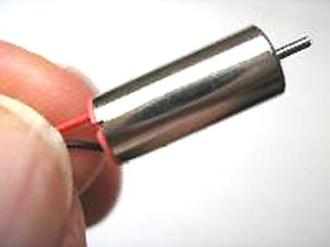

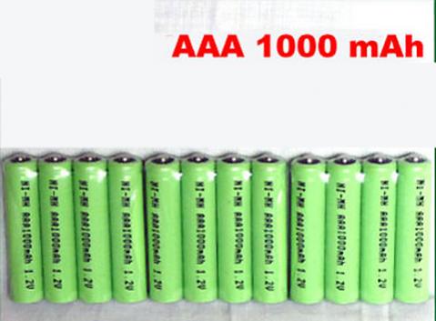

                    I found that by removing the insulation-sleeve from AAA rechargable batteries, they fit perfectly inside a 7/16"OD brass tube, so that will be my power-source for my torpedos. :)
                    I'll only need 1 battery per torpedo so the sleeve removed is no problem, I can use the torpedo's tube as the negative conductor.
                    Rick L.
                      • 2642
                      #175
                      Will that give you enough poke? Most motors need 3 volts at least to produce reasonable power and torque.
                      • toppack
                        • Nov 2008
                        • 1124
                        #176
                        I think so, these 7.mm motors I'm trying are turning a very high RPM at 1. volt with no load. If I can keep the prop-shaft-seal friction low (going to try 2 O-rings, with silicone-grease between them, first), that 1.2V battery should do the job.
                        Rick L.

                          Rick been there done that,
                          and it flopped. Thumbs Down
                          My electric torpedoes had one big problem - flotation
                          You will find you need as Andy put it - around 3 volts for enough torque transfer to the prop in the water. This is where the weight problem creeps in, along with torque roll which in my scale was too little to have counter-rotating props (which I countered to some degree with weight distribution and fin set up.
                          Back in the 90s there was a couple of great large scale (1/24 and 1/32 i think) electric torpedo kits you could buy - no more of these around - these were works of great craftsmanship, counterrotating props etc etc, the real deal.
                          Why do I like gas-
                          Its simple.
                          There is no flotation problem
                          There is no battery requirements
                          There is no bearing
                          There is nothing on each shot to water proof
                          There is no kill switch requried
                          There is likely (awaiting confirmation from David) no or very little ballast impact on the boat.
                          The latter problem is potentionally huge with a battery (weighty torpedo).
                          Don't believe me do this test:
                          Take a sub that you operate regularly. Take her down in to PD. (Tank should be full of water.
                          Take one AAA battery plant it via rubber band on the nose - what happens to your trimmed out boat? Its now a little nose heavy - ok multiply that by say a factor of say 8 to represent 4 medium to small type 3 v powered electric torpedoes - you now have a boat that when "armed" is in a completely different ballasted state to when not loaded with torpedoes.
                          To over come this you need some way of equalising the weight of the loaded tubes when the tubes are unloaded. Its not impossible but the only way I did this was by making the torpedo overscale in length and made each torpedo positive. I had a separate tank on board to pump in /out water to counteract the release of each torpedo.
                          In short the system was complicated and craptacular; and was uninstalled from my Permit PDQ.
                          Rick, stop flogging this dead horse mate - IMO you are wasting your time and resources.
                          Just wait for the system - David will answer my question list (he is kind of busy):) and you will be blown away as to just how good the system is.

                              I really appreciate the suggestions, But I've seen battery powered, single-prop, torpedos that work and operate the way I want mine to. So I know it can be done.
                              Now wheather I'll be able to construct them with one good hand is another concern but i want to try for several reasons. The biggest ones being that I like to create my own designs and fabricate them and the other being that I know I'll not be able to afford David's creation, since he's going to be very proud of it, and rightfully so. :D LOL
                              Thanks,
                              Rick L.
