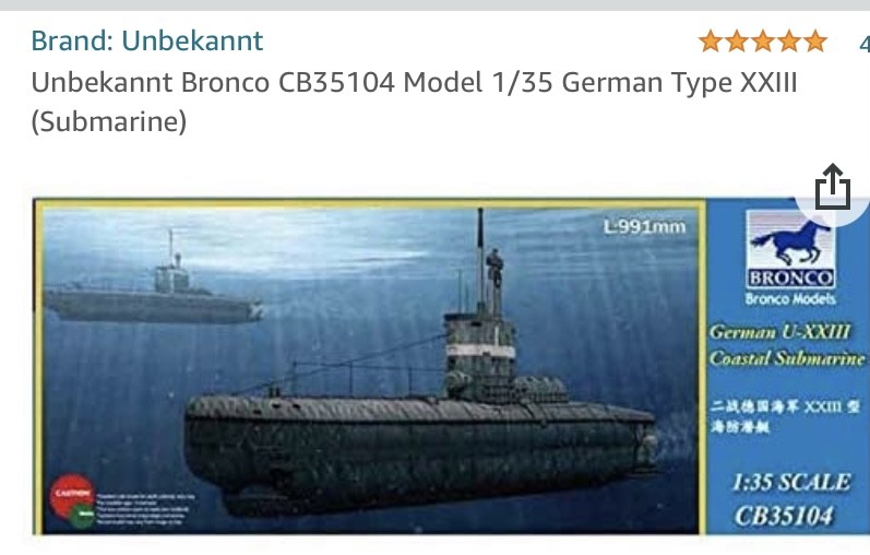

    I just found and ordered the last Bronco (edited) Type XXIII on Amazon. Maybe one day I’ll find a WTC for it. Guess I’ll put it on a shelf until then.

    Click image for larger version  Name:	DE94D6D6-AA43-4CD5-A965-4DD4A95BDFEB.jpeg Views:	0 Size:	72.1 KB ID:	155352 Thanks. I meant Bronco. I’m an idiot.

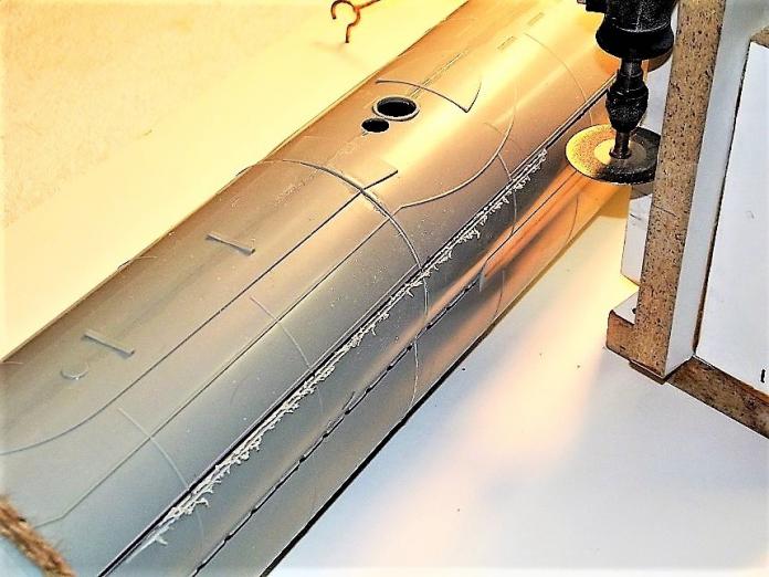

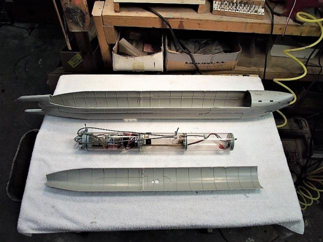

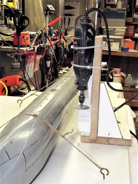

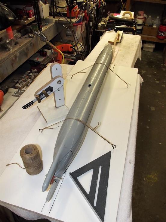

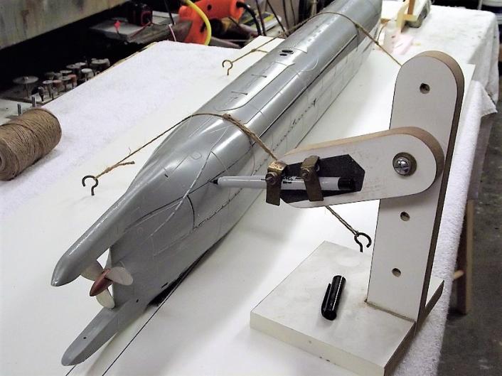

                    You still have to make a new cut in the hull with the Maximus Modellbau system. It would’ve been better if the system was designed to use the existing hull split. Also it the system provides no separate control option for the forward planes. The system is also designed to control the rudder with external linkage. That’s cheating.
                    The “dreaded” long horizontal cut is the all around better way to go. Just my two cents.
                      (pussy!)
                      Yes. I ruined a Seaview trying that once. Not again.

                          Looks like a Medieval torture device.
