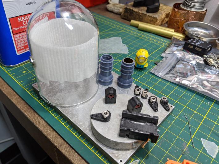

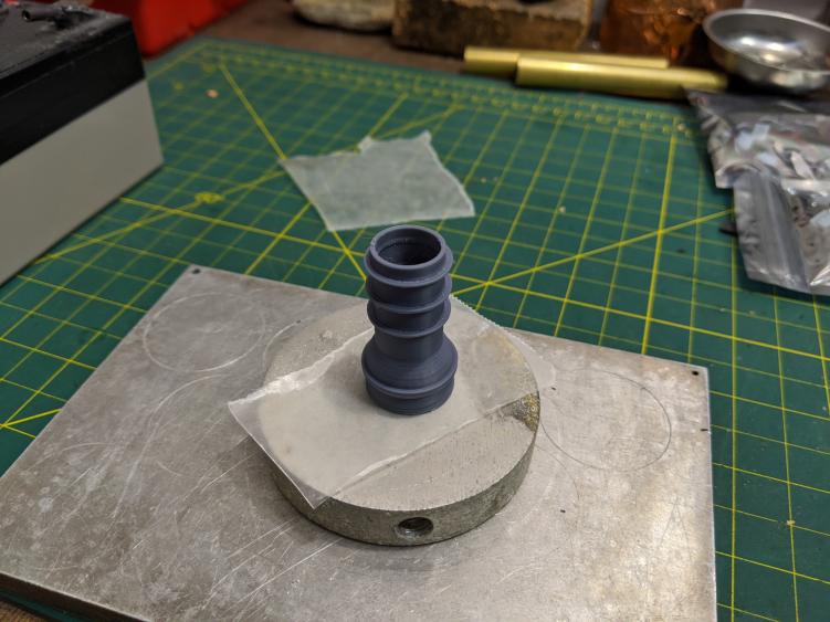

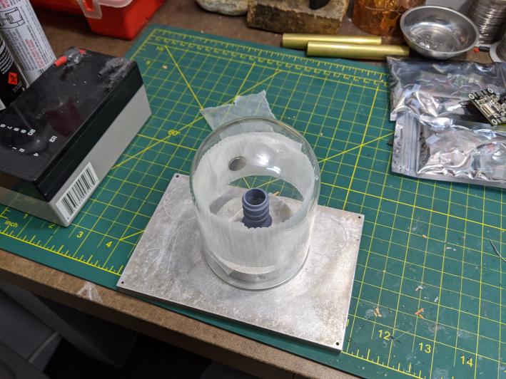

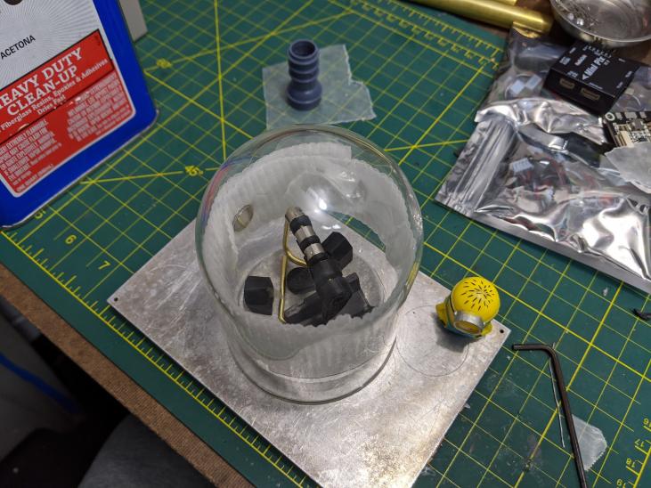

    It occurred to me AFTER the meeting yesterday, if it's still possible, you may want to give all those ABS+ parts an Acetone Vapor Bath first.
    1-It will smooth it out. aka less finish work
    2- It will greatly strengthen the parts. The vapor gets between the filaments and fuses them.
    I vapor bath ALL my ABS+ parts when feasible.
    You may be past the point of the hull if you joined the individual pieces already, but consider trying one section or so in the future to see if it's worth it.
    I time it 15-18 minutes.

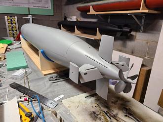

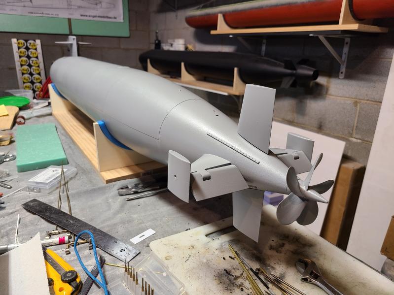

    Too late...
    But it's OK. It will require minimal fill and sanding work as it is and the primer locks it all together as well. I have never tried the acetone bath thing so I may have to give it a try on a smaller part.

            Is that a coffee filter that you soak in Acetone and then hold to the cover with magnets?
            No, just a paper towel, that's what's soaked with acetone.
            v/r "Sub" Ed
