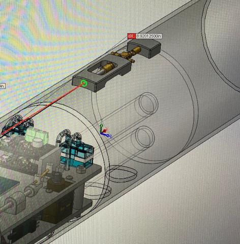

                          Currently, I’m making a new vent valve assembly that will be mounted on the top of the tank and have a pushrod connecting it to the ballast servo pushrod exiting the forward end cap. Was originally wanting to avoid this as it adds slightly more complexity to removing the forward end cap.

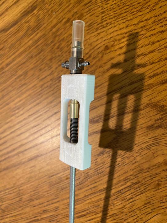

                            New vent valve for the main ballast tank.

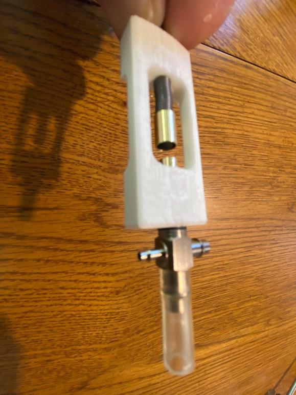

                            Simple sprung vent slide valve. Normally I'd like to see the sealing surface be on the pressure side which would increase sealing under pressure.
                            Hard to see from the photo but there is a 3/16" OD Viton ball inserted into the retracted brass vent seal cup above.
                            Hope to test this new vent valve in the next couple days.
