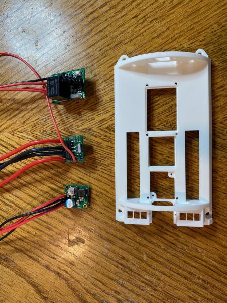

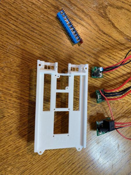

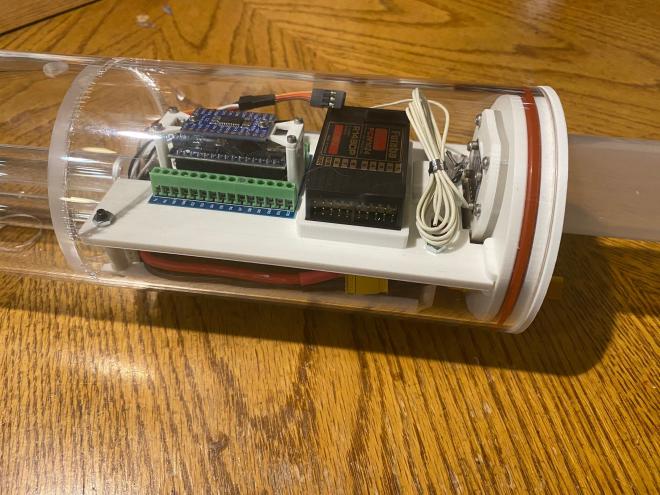

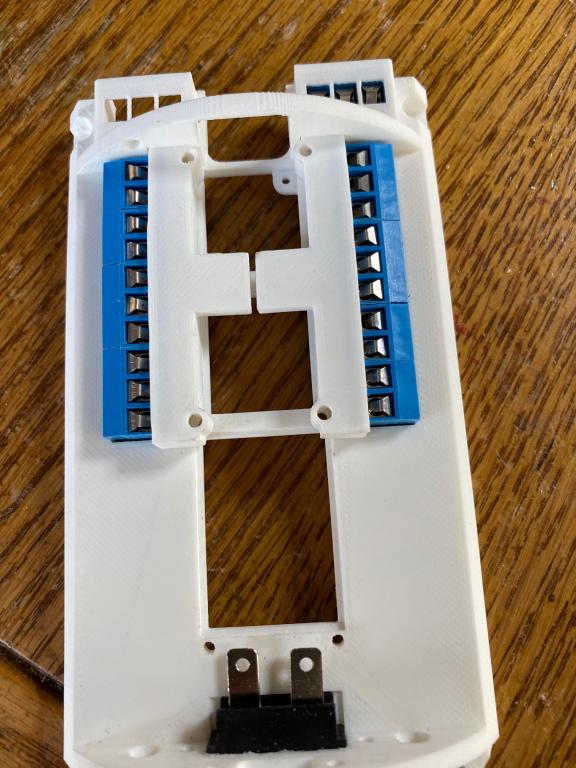

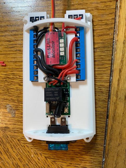

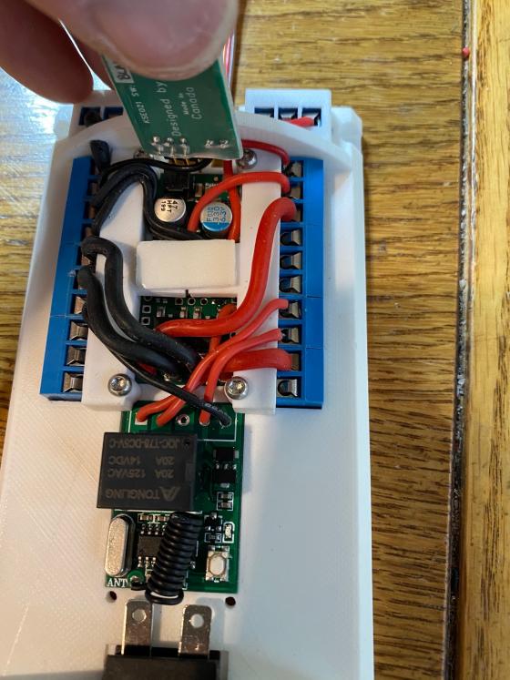

          Some more progress has been made since the last project update.
          Arrived at a final design for the aft compartment lower equipment shelf/battery tray after many, many hours of trying to find the optimal layout for all the electronic components. Here is what I've come up with so far.

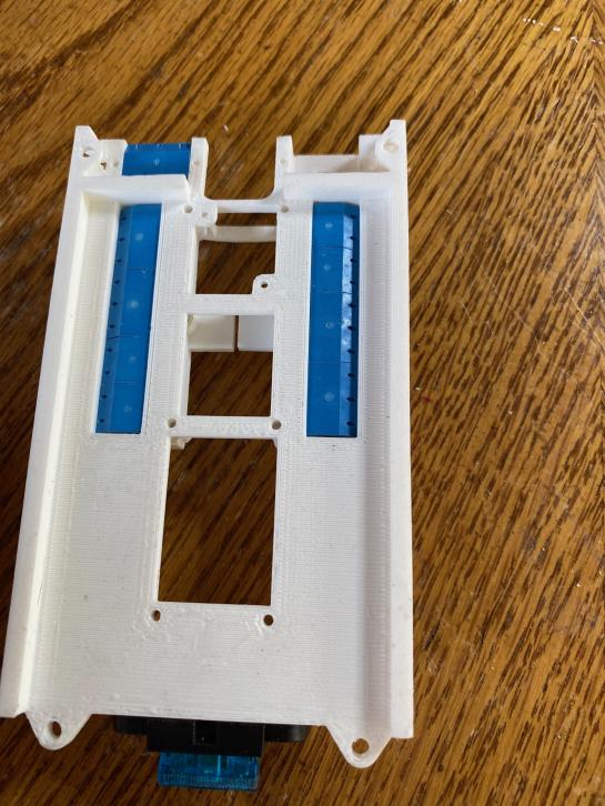

          Bottom side of lower equipment shelf. From top to bottom in the photo: Top is the remote on/off switch that turns on or off the mosfet heavy duty switch board in the middle. The mosfet switch turns on or off the power much more smoothly than the coil relay and can handle more current. The lower component is 5V 6A voltage regulator.
          Top side of the lower shelf where the two LiPo batteries will sit.

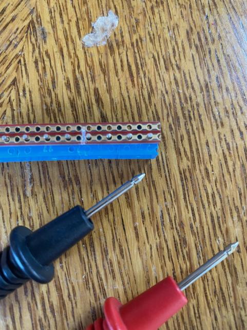

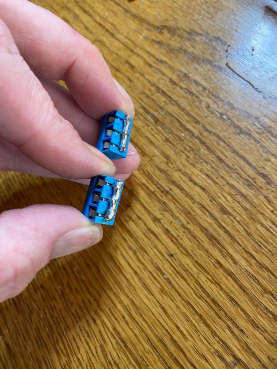

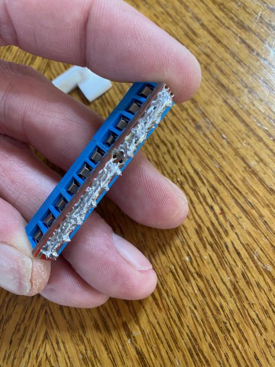

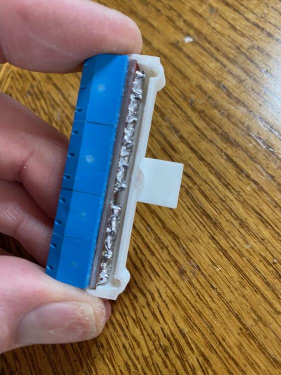

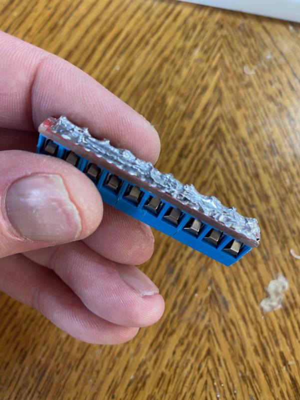

          Starting to create the 12V bus bar using 5mm screw terminals. I use circuit prototyping boards as backbone or support for the screw terminals. I rip these circuit boards down to what ever size I need using a mini precision table saw. This terminal bus bar has ten positions. The four pins on the right side will be constantly 12V hot or charged when the batteries are plugged in. The remaining 6 positions will be switched 12V hot fed from the mosfet switch. 16AWG wire is used to bus the pins together. On the prototyping boards you can break the circuit by cutting the thin metal circuit material bonded to the board with a blade or a file as shown above.
          16AWG stranded wire soldered across the pins to creat the 12v positive bus bars.

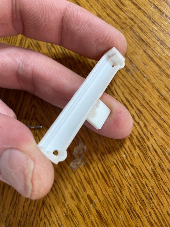

          How it fits in the bar holder. The slot in the holder shows how the circuit board is secured.
          Another photo of the bus bar holder.

          10 position ground bus bar finished.

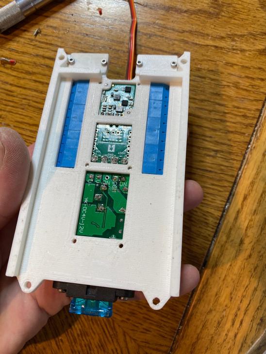

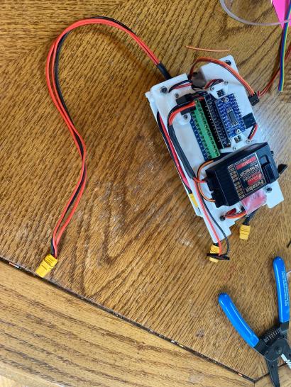

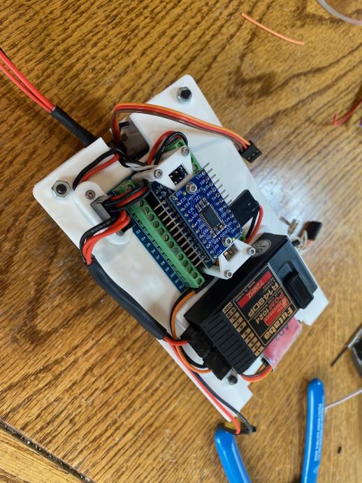

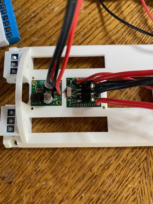

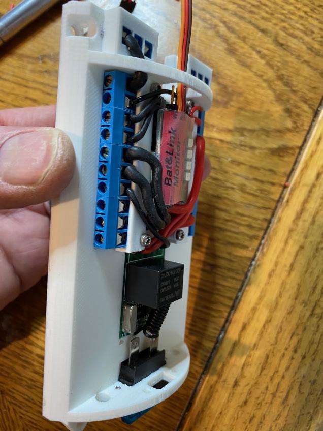

          Starting to fit the 5V regulator and the 12V mosfet switch. Forward 3 position bus bars installed.

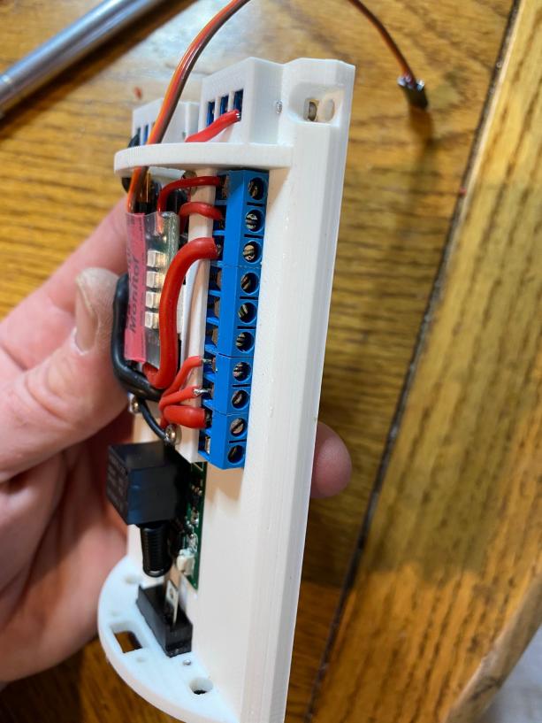

          Wiring! Although the 5V regulator use two 2mm screws to secure it to the equipment shelf, the bus bar holders were designed to slightly overlap the edges of the circuit boards to hold them in place in their countersunk wells. The Battery and Link Monitor is about to be secured in place with the double sided tape attached to the tabs on the bus bas holders.
          Getting there! in the top of this photo you can see the 3 position ground bar is connected as well as the 5V bus bar.

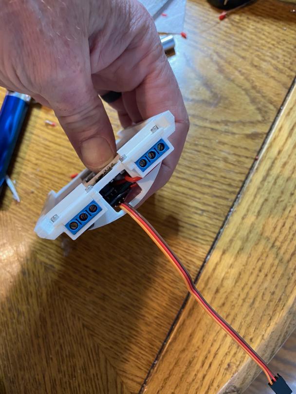

          Another view of the top side with the components installed.
          Front side view.

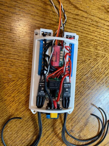

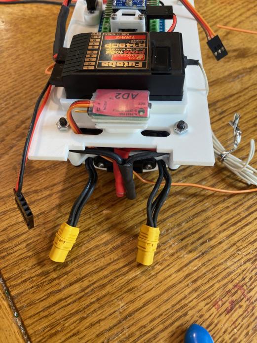

          Dual ESC's now installed along with the finalized main power wiring. I wanted to add poly-type fuses to each of the ESC in case of a over amp situation like the propellers snagging weeds or such. This would've allowed the ESC's fuse to blow at a lower amp rating without blowing the main fuse. As you can see I already have 10 pounds in a 5 pound bag, so no room. Instead I will use magnets as slip clutches for each prop shaft.
          Work has also began on the aft upper equipment shelf. I will post an update about that shortly.

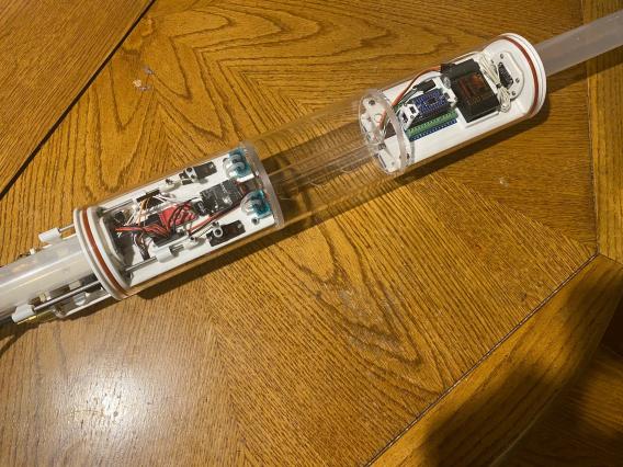

                            As mentioned earlier progress has been made on the aft upper equipment shelf. Here's the update.

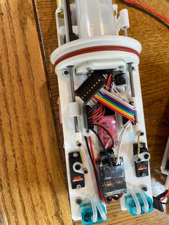

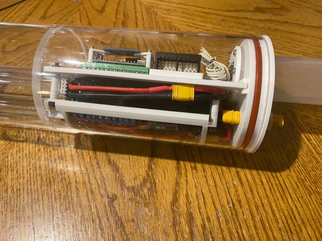

                            Upper shelf designed and made. It's attached to the bottom shelf with the dual LiPo's in between. Receiver and Arduino nano in place with ex pander unit mounted above. Also got the aft bulkhead designed with the dual brush-less motor connections and the central servo connection connection figured out.
                            Dual LiPo connections, port and starboard, made as well as the dual motor connections. Note the slip in equipment shelf tab interface with the rear end cap to keep things level and in place
                            Overall view.

                            Starting to wire the components. 5V ground and positive bus installed on the port side,
                            Aft ESC hook-ups to the aft bulkhead.

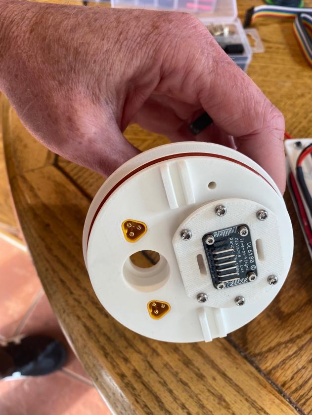

                            View of rear bulkhead and brushless motor connections.

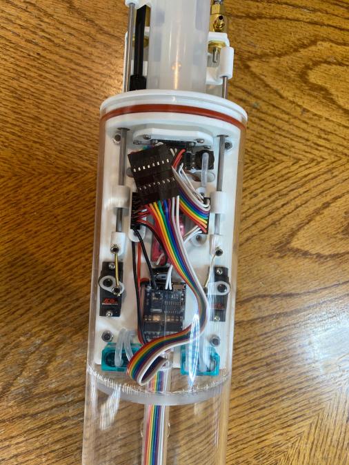

                            Outer end view of aft WTC cylinder bulkhead.

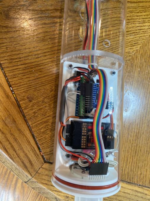

                            Rainbow signal cable harness connection from forward component unit to aft command center.

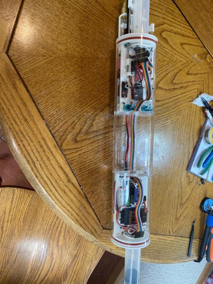

                            Overall current view of the nightmare i created for myself

                            Now that most of the main systems have been built and linked together with their respective hardware focus has bee been shifted to how to control this hot mess through code and direct communication. This is were the possibilities are endless Pick your flavor. What do you want automated and what do you want directly controlled, and just to mess you up further, what do you want a mix of?

                              #74
                              Fantastic work did you print the endcaps there look the surface so even? The 3 pin connector from amass i do use also for me the best.
                              Regards Gantu
                              • Monahan Steam Models
                                • Apr 2020
                                • 755
                                #75
                                Thank you Gantu!
                                Yes Sir, they were printed and this is exactly how they came out of the printer. I have not done any finish work to them other than remove a couple small supports needed for the 3 pin holes. Yes I agree, the Amass 3pin connectors are great. This is the first project that I have used them on and I am very happy with them.
                                Best Regards,
