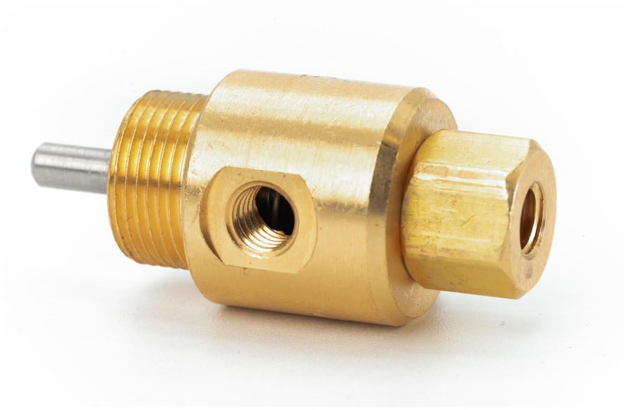

                  What vent valve are you using?
                  • Monahan Steam Models
                    • Apr 2020
                    • 755
                    #129
                    Steve,
                    The vent valve is a Clippard Mav-2.

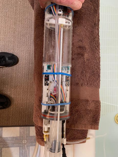

                    The connection from the vent at the top of the ballast tank connects to the stainless steel barb in the above photo. The brass barb is where the tank is vented when the servo depresses the valve.

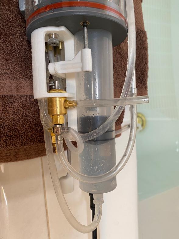

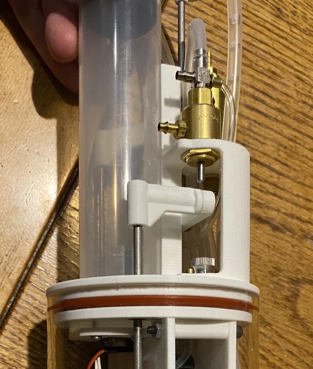

                              I did some more tests this morning to see what was actually occurring. Made a couple small changes then did some more tests and observed. That's when I saw what was happening. It was so dumb.... I'll try my best to explain below. Long story short though, problem found, solution to problem tested and the venting works now every time. Still need to decide on how to go about adding a permanent fix.
                              And now for the long winded explanation:
                              First here's the changes I made this morning.
                              Above is the first change that was made. After witnessing short slugs of water inside the clear tubing blocking the venting air from escaping I decided to try stepping up the tube's ID to increase flow by replacing a section with a 3/16' ID piece of hard aluminum tube.
                              Next I swapped where the tube from the vent connects to the barbed Tee fitting on the back of the vent valve to eliminate the possible U-bend sink drain trap effect I mentioned earlier. I re-attached a short vertical length of clear tube to the brass barb on the vent valve to allow the vented air to be above water level while surfaced. These changes did make slight improvements of the venting but they were not the problem, nor did they solve the intermittent and variable filling of the ballast tank after the first dive.
                              A quick explanation of the connections to the TEE fitting attached to the back of the vent valve. Center connection is to the vent fitting at the top of the ballast tank. Small tube connection at bottom of TEE is the input from the emergency gas blow valve outlet. Upper tube connection is the input from the low pressure blowers outlet.
