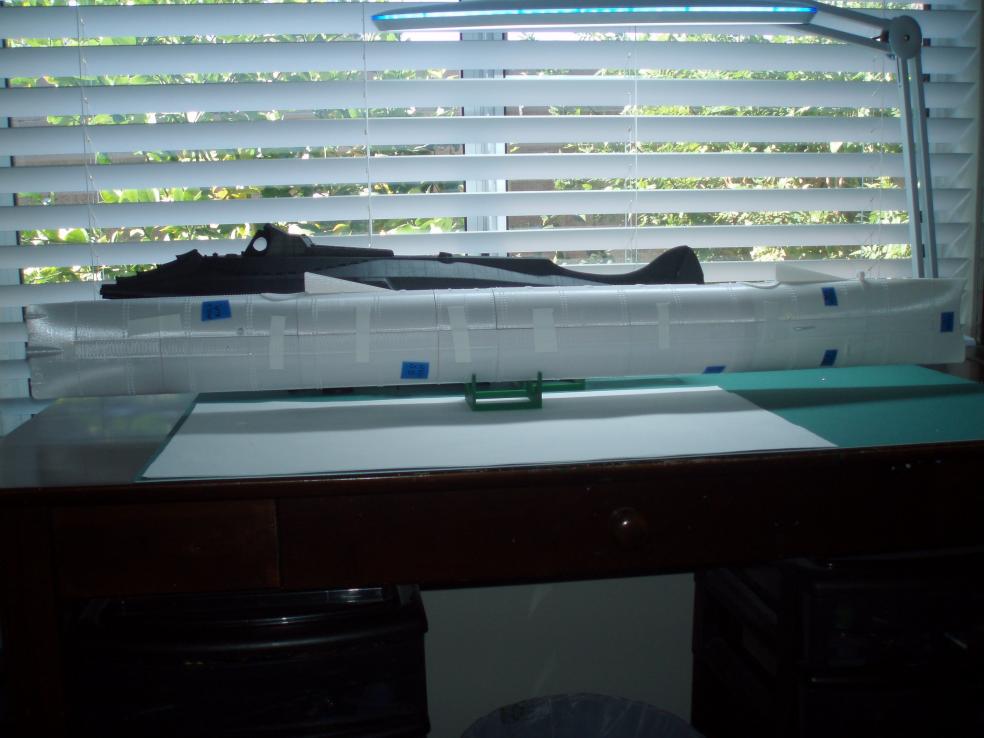

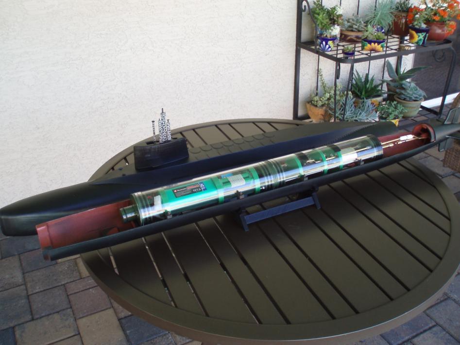

    This will actually be the first (the 1:77 scale Nautilus will be the second) real ballast system subs I have built! The other five where basic surface runners and possible dynamic divers at best! With this information in mind and me being somewhat of a newbie, I will need some help with the plumbing on the Hunley!
ID:	146700Click image for larger version
    With the Hunley we really do not have a sail as per say. The picture showing the upper hull section with the square access hole for the snorkel box and the two snorkel tubes is the only access to the outside of the sub, except for the two hatches one forward and one aft. Looking at the plumbing that came with the MSD I am just not sure what I need to do!?
    Any advice and help would be greatly appreciated!

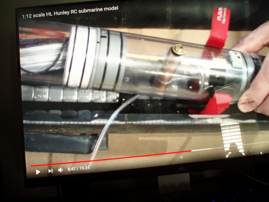

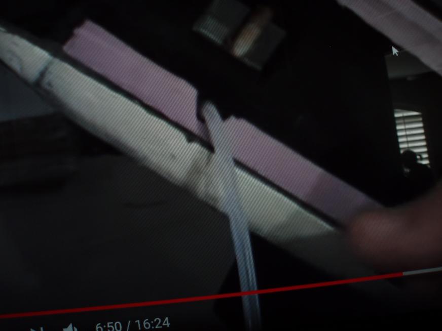

      Thank you David! I found on of Bobs videos on the 3D printed Hunley build, it showed how he hooked up a tube to one of the deck snorkels!

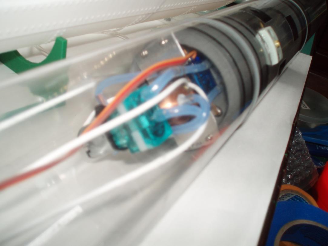

      That looks simple enough! The part that I do not understand is where the other end of this snorkel tube is attached!?

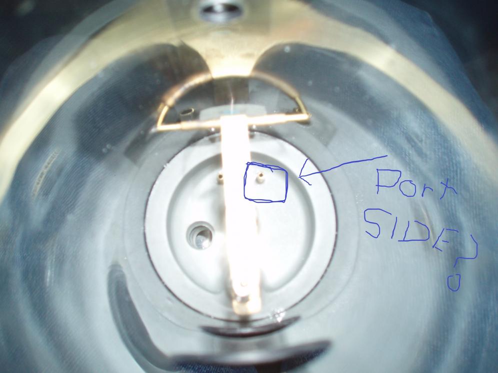

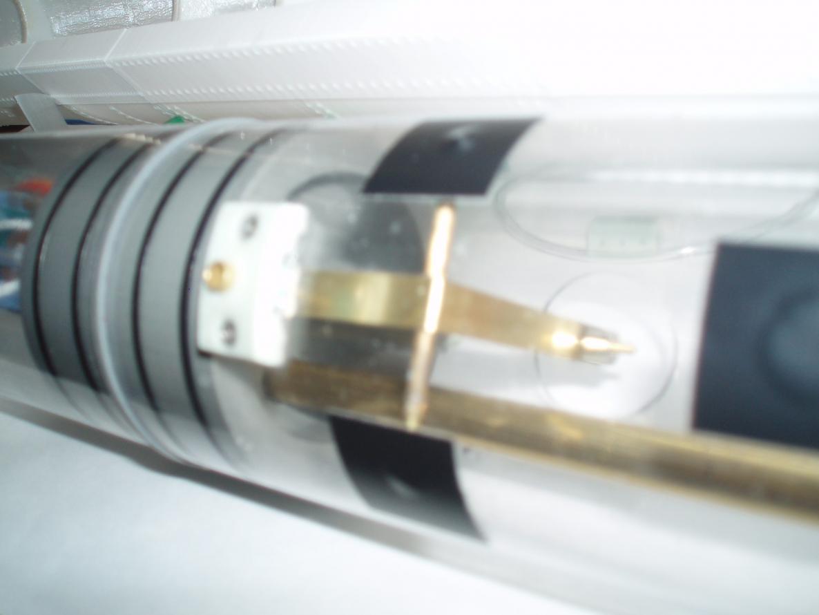

      The photo on the right shows the ballast tank bulkhead, and on that bulkhead is two very small brass tube coming in from the pump section with no connections!
      Looking at Bobs photo it shows the other end of the snorkel tube running to the inside of the ballast tank through one of the drain holes in the bottom of the ballast tank. From there I can not tell what line (tube) is connect to!? I am just having a real hard time (age related I am sure) HA HA understanding these SD, MSD and there total operation!? I guess that is why all 5 of my other submarine builds and there WTC have ALL been surface runners..
      Sorry to be such a pest! For all you newbies out there that think this hobby is simple! Rethink your thinking before you jump in! Take the time to learn it inside and out!!
      "Firemen can stand the heat"
        • 13937
        The LPB takes a suction on one of the HUNLEY 'snorkel tubes' -- that's air in (the long flexible tube coming out of of the ballast tank flood-drain holes). The LPB discharges right into the ballast tank, blowing it dry. Your MSD is already rigged to blow the ballast tank with the LPB. Just shunt around the installed safety float-valve -- that's only used if you use a snorkel.

          Let me make be sure I understand you. (this seems to simple) The clear 1/8" tubing I have runs from one of the snorkel tubes (from the snorkel box) into just one hole inside the ballast tank & maybe attached to the brass conduit line. The pump (white wires) are connected to the power and the servo type wire is plugged into one of the RX (receiver) ports to operate the pump, and that's it!?

            As long as that clear flexible hose is making up to the after ballast bulkhead port nipple, you're good to go. The starboard nipple discharges straight into the ballast tank.
              Is this the port side nipple you are referring to?
              One end of the tube to this nipple and the other goes up to the snorkel?

                Yup. that leads to the suction side of the LPB.

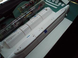

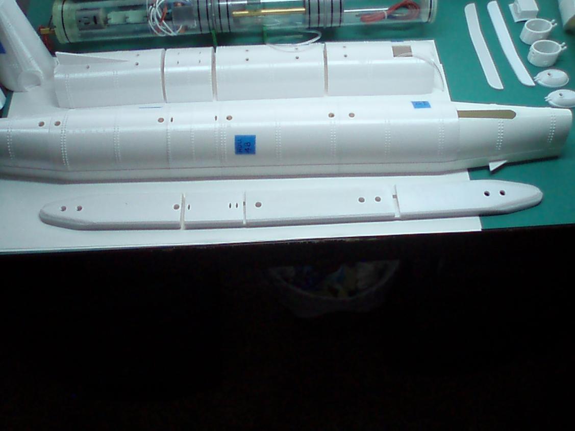

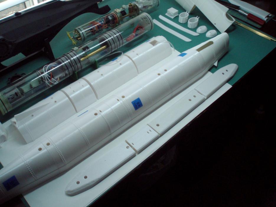

                      The hull sections are complete and ready to be joined up! The overall length turned out to be 43" (1002.20 mm) as mention before I had to add an addition 2.5" (63.50 mm) section to the length to accommodate the MSD I am using! All in all I am quite pleased with the printed structure at this point!
                      Now I can move onto the rest of the smaller components to complete the build up.

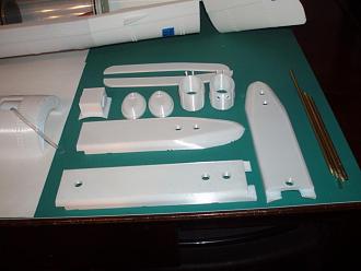

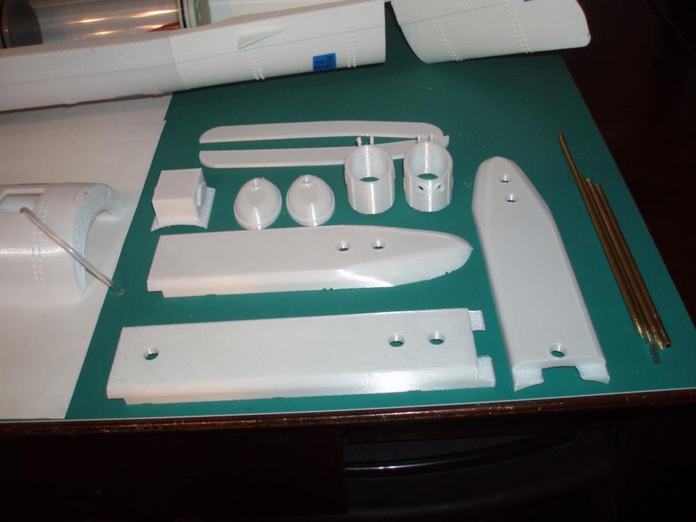

                        Today I started the print out on the accessories needed for the Hunley.
                        The items you see in the photo above are the forward dive planes, the snorkel box, the two hatches with the covers, and the keel plates. I have also cut some brass tubing for the snorkels.

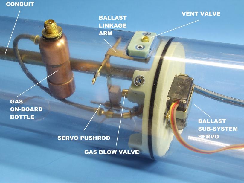

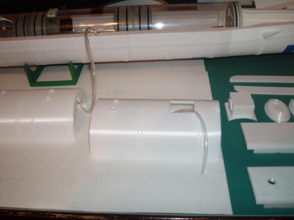

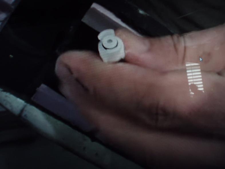

                        I do have a question about the ballast 1/8" tubing going up to the snorkel! The photo on the left shows Bob Martin showing the quick connect that he used to tie the snorkel tube to the ballast tube. I have looked everywhere and have not been able to find these. I could use a brass tube and just pull it apart, but a nice connector would be better.
                        I would appreciate any possible ideas that you guys might have on this! Thanks!!
                          • 2031
                          Robart quick connect. They're awesome.
                            WOW! Thanks Bob!
                            How soon we forget! I used the Robart air retract system on a couple of my 1/4 scale RC air planes in the day, a Corsair, and P-51! Thanks for shaking the cob webs loose!
                            Thanks again for the link-up!

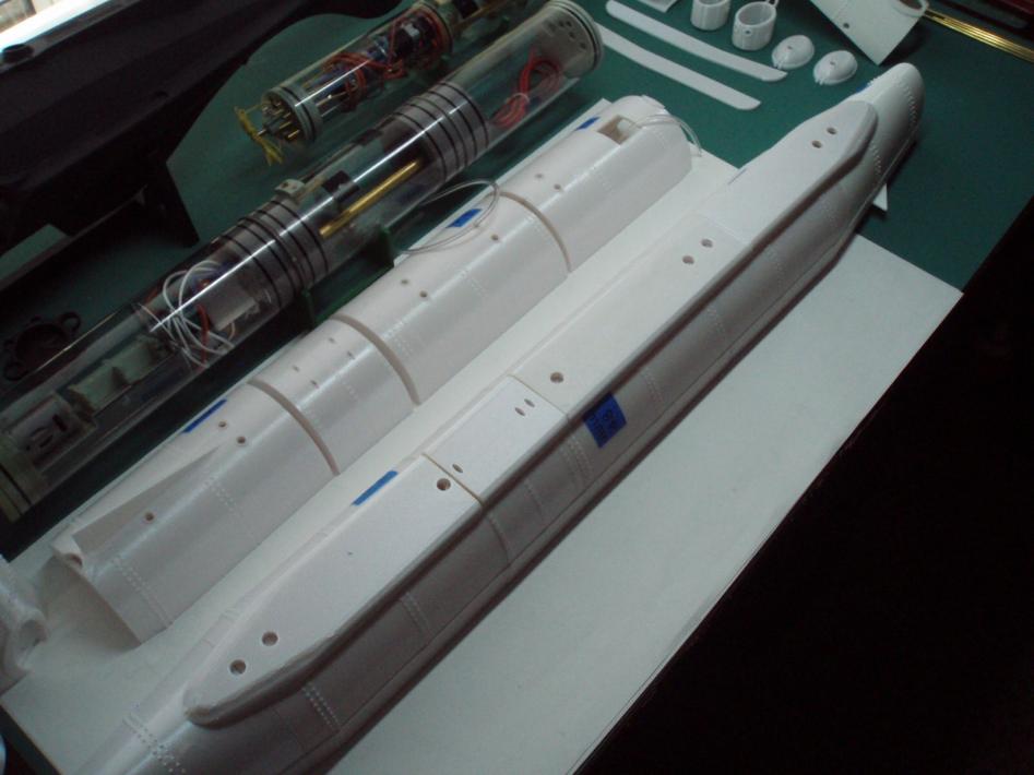

                              Today I am working on fitting the keel to the bottom of the Hunley.
ID:	146923Click image for larger version
                              I had to 3D print a smaller 2.5" long section of keel to make up for the bottom hull section that I needed for the installation of the MSD!

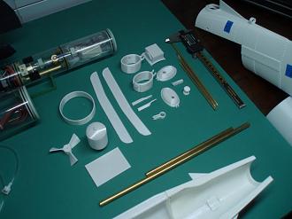

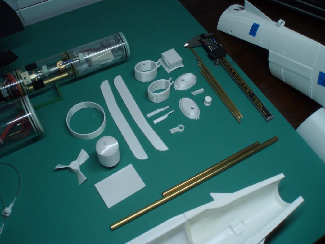

                                The Hunley 3D printing is complete! Today I finished up all the smaller parts required for the build.
                                Click image for larger version  Name:	P1220004.jpg Views:	0 Size:	67.0 KB ID:	146989
                                These files as printed are good for great looking static model! Since I am going to put this machine in the water as a full RC submarine, some of the smaller parts will be replaced using brass and copper. Attaching the prop ring, workable linkage material for the rudder and the forward dive planes will all require a much stronger foundation.
                                That's no problem, I think the more rustic looking metal parts will enhance not only the appearance of the model, but it's overall ability to operate in the water environment.
                                Moving on with construction!!!
