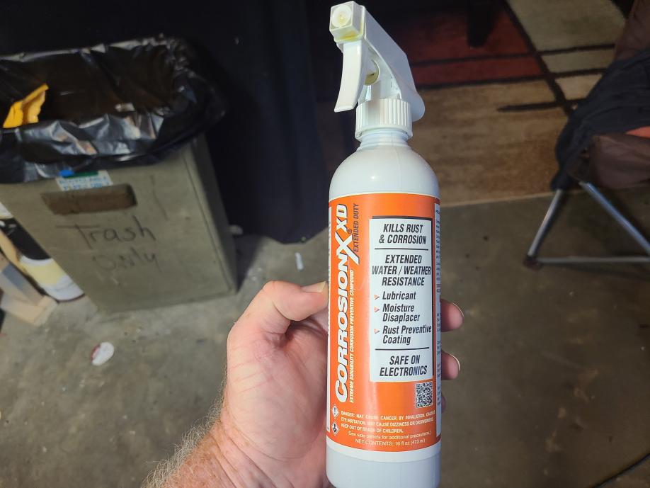

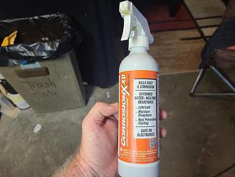

              Hey Randy, yes, I run brushless motors in the wet all the time. I am primarily using Mtroniks G2 Hydra 50's. I spray CorrosionX on the shaft ends. I added bow and stern thrusters to my Columbia using cheap drone motors in the wet and I just replaced them because I noticed that they were developing some play in the bearings. They still worked fine so it was more of a precaution plus they are cheap and easy to replace. I also run servos in the wet as much as possible, again filling them with CorrosionX. The Columbia has 7 of them.

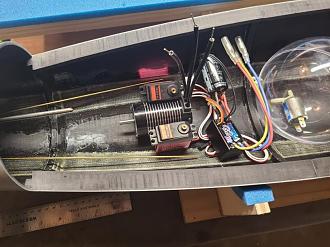

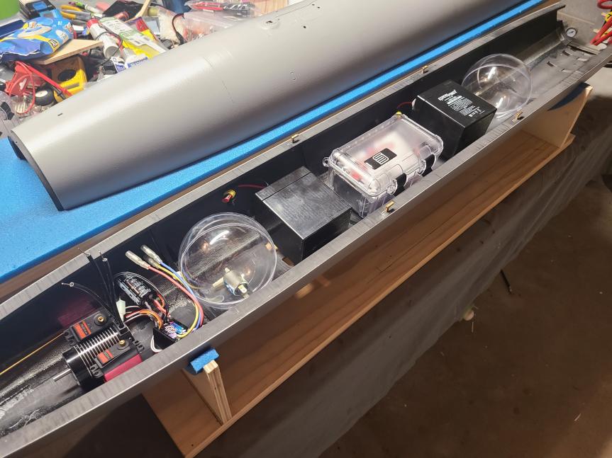

              I am in the process of laying out the running gear for my 1/48 THRESHER. Getting ready to make the trays and brackets for the components. The only thing not shown is the Emergency Gas Back-up which will go up front once I put it together.
              Click image for larger version  Name:	20211004_225654.jpg Views:	0 Size:	80.2 KB ID:	154009

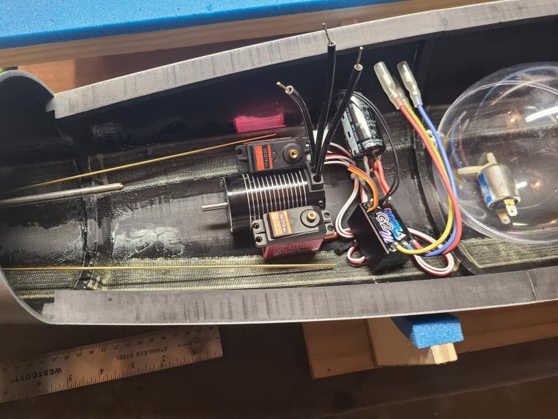

              The G2 Hydra 50 motor and ESC. The motors are brushless inrunners. They aren't cheap but they work well for the size boats I prefer.
              Click image for larger version  Name:	20211004_225710.jpg Views:	0 Size:	82.8 KB ID:	154010
              The watertight box will house the pump, ballast control module, a Castle Creations 20A BEC, receiver and an AD2 Pitch Control. I plan to go 75MHz with a "SNORT" system on this one. I am trying to keep it as simple as possible. I love to experiment so much of what I do is out of a desire to see what works and what doesn't. So far I have two boats with similar setups, soon to be three.

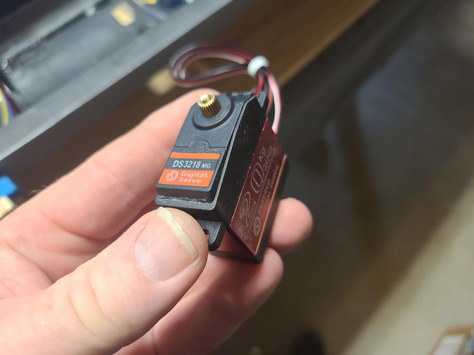

                      For most of my boats I use these which are overkill for the stern planes.
                      Click image for larger version  Name:	20211005_140721.jpg Views:	0 Size:	46.6 KB ID:	154041
                      And anything I may have lying around. For the fairwater planes 9g or up if it will fit. In my Columbia I used 5 - 17g servos, one for each stern control surface and Y'd 4 of them in pairs through an Engel X-tail mixer which allowed me to use an AD2 Pitch controller. The 5th servo is tied straight to the rudder channel in parallel to the others and controls the small vertical rudder on the stern.

                            Hey Rob, I fill any servos I put in the wet full of CorrosionX no matter what they say. As Bob said, I believe they are splash proof at best. The 20Kg servos are intended for stearing RC cars and they do have gaskets between the sections but I don't trust them to maintain their functionality if completely submerged without the CorrosionX. I fill a syringe and use that to push it into the servos.
