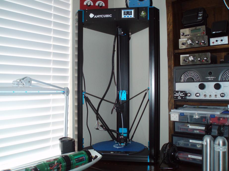

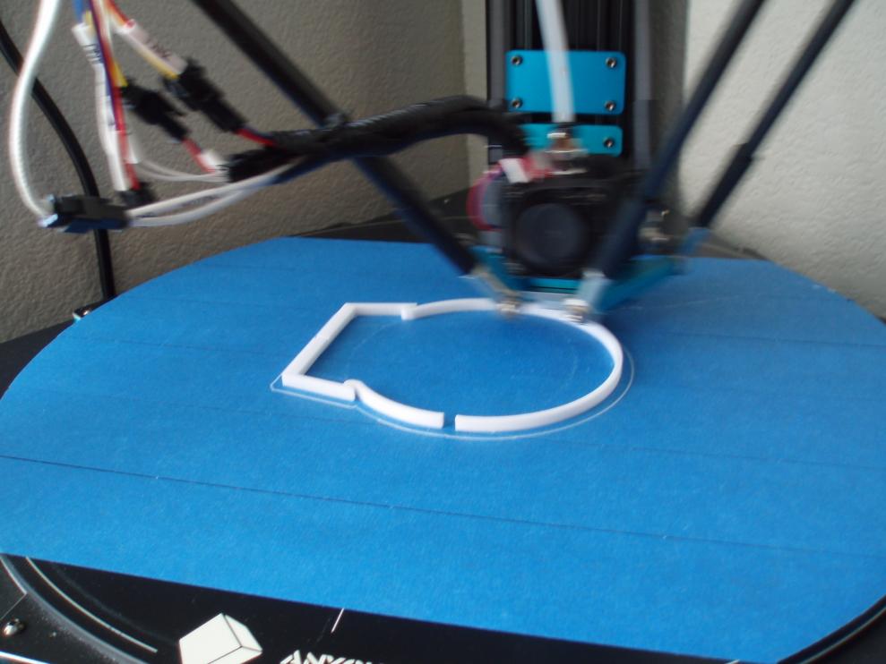

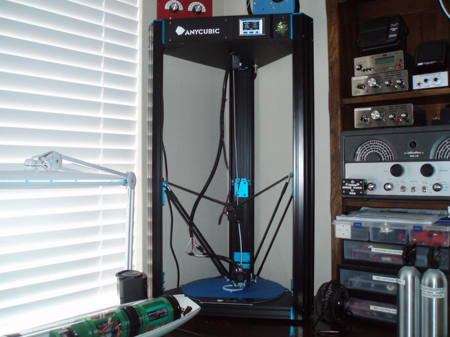

              This is what I use for my bigger Subs! For roughly $400.00 you get a bed build of 16" high with 14" Dia. table! In that price range it is the largest Delta printer out there! I have run this printer into the ground for almost 4 years now, and no problems at all! Its called the ANYCUBIC Predator!
ID:	144880Click image for larger version

                Went to Anycube website. Predator not available in US
                • SubDude
                  • 825
                  Ender 3 Pro is what I have.
                    Steve and George,
                    My Predator is over 4 years old! I got it on Amazon at that time. Check out Amazon! At one time they stopped using the Predator name on this printer! I just checked Amazon, and it looks like they do not carry this printer anymore! There are some listed on eBay in the $500.00 range, used and new! ANYCUBIC may have discontinued this printer!!!???
                    Steve, I have really heard and read good things about the Ender 3 Pro. My next one will be the Ender 3.
                    George! Chick out Steve's posts here (RCJetDude) He has built some big Subs with his Ender 3. Good luck on your search for a printer!

                        That Ender 5 Plus looks like a very well engineered printer! And the $600.00 price range is not bad for the quality that seems to be build into that machine. The print size is equal to my Predator as well! Plus I am sure you won't have the hassles of set up like you have with Delta type machines.
