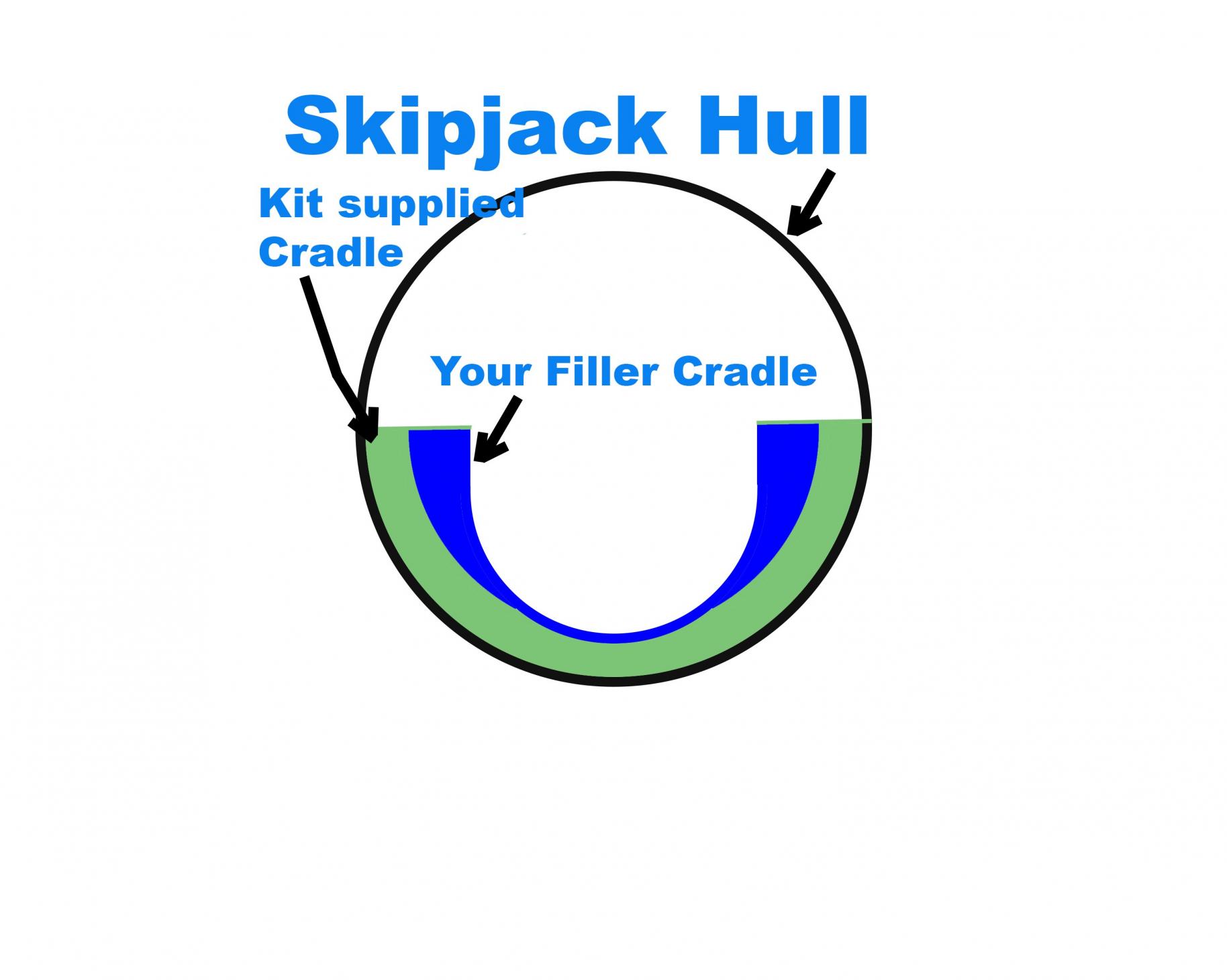

                • 3661
                I used Garolite (fiberglass/epoxy component) to make my cradle mount on the Gato. Worked great, I guess it is important not to get stuck in what you do not have but look for other sources. While wood is not my number one choice, I would not turn away from it if that is all I had.
                To answer his question, I would use the cradles provided, but make a fill in so the 2.5" will now fit into the 3.5" cradle.
ID:	138756 Sorry for the crayon drawing.
