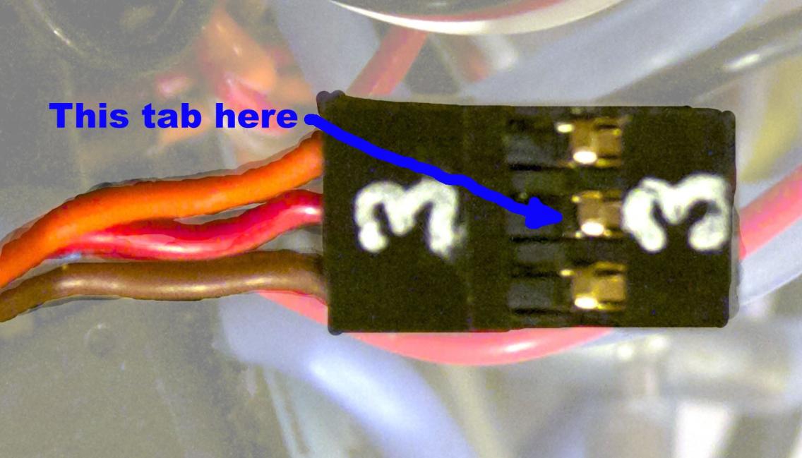

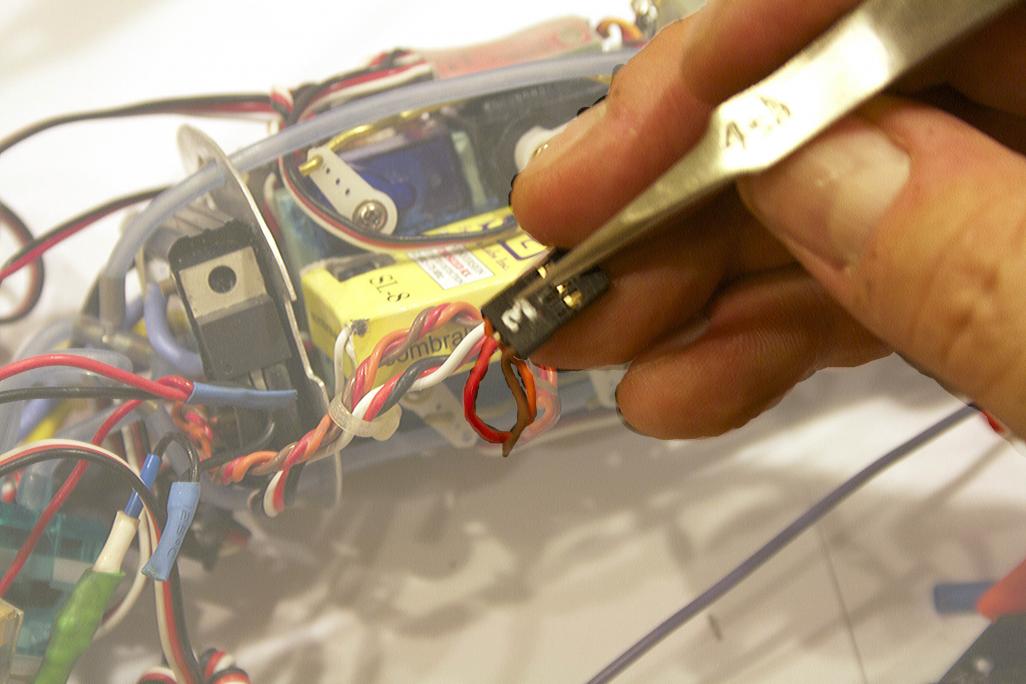

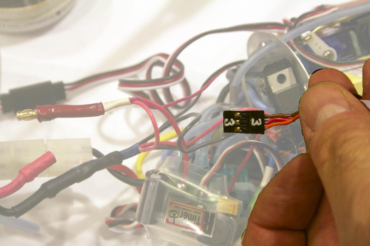

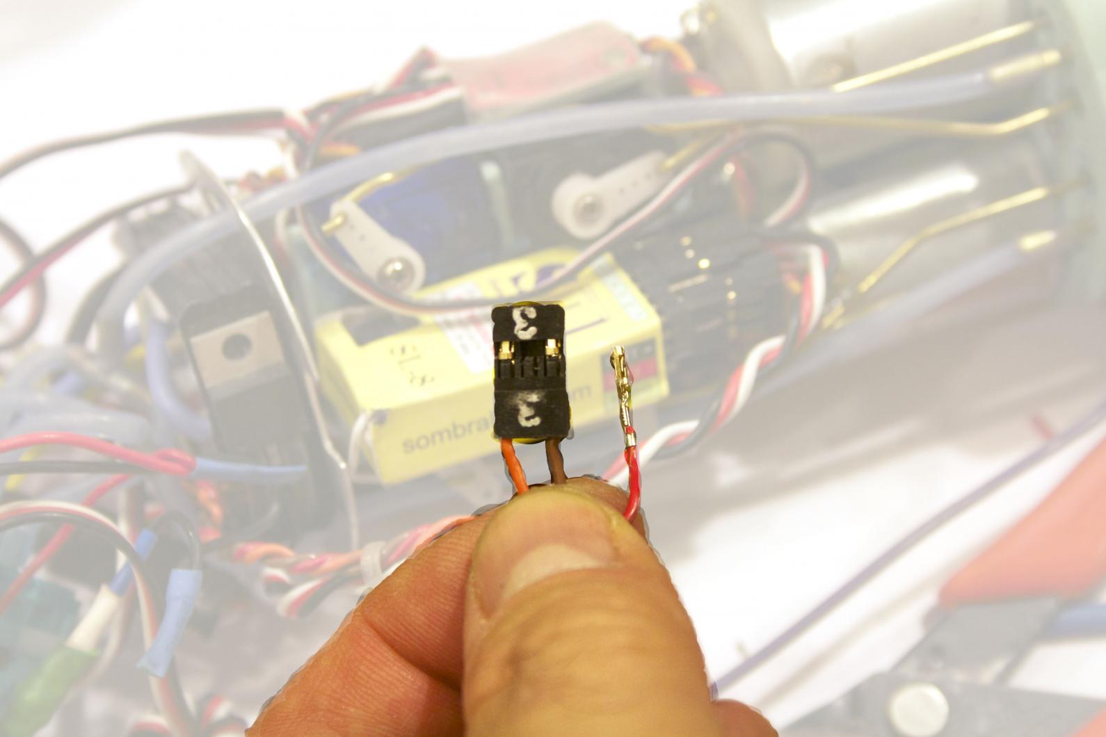

    Here is a visual of the Mtronics connector that goes to the receiver.

      So you you pull it out with a pair of tweezers......?
        There is a small tab that prevents the wire from being pulled out. So, gently lifting the tab you will be able to pull it out and if done well, if you ever want to return the bec function back you can.
