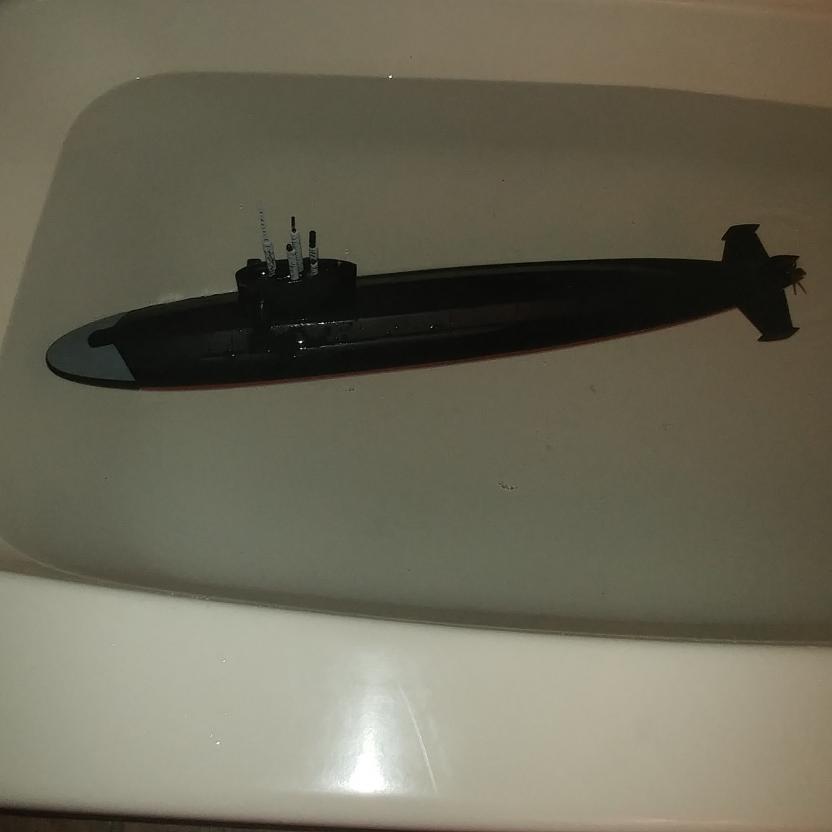

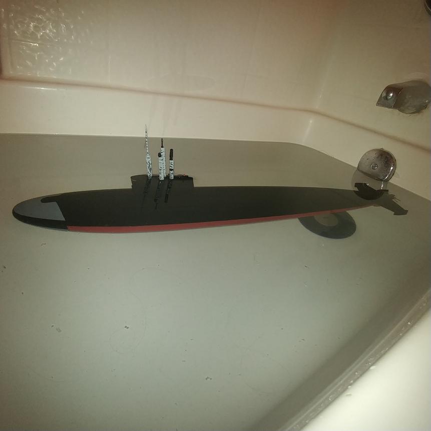

    After several weeks of gnashing of teeth and threatening to shove it down the garbage disposal, I believe I have reached trim I am happy with ! Thanks to Dave and Bob for the pointers in the past! Click image for larger version

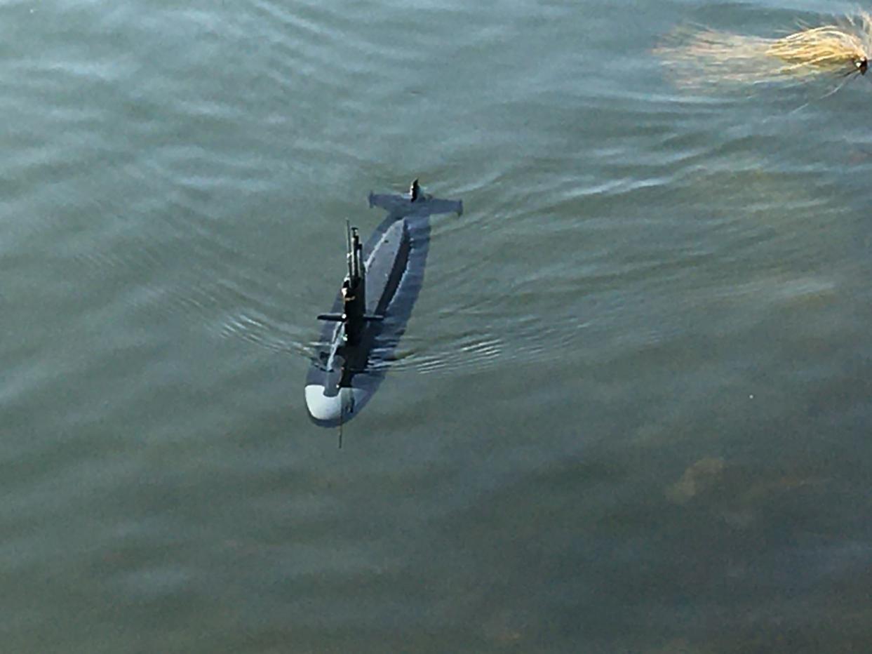

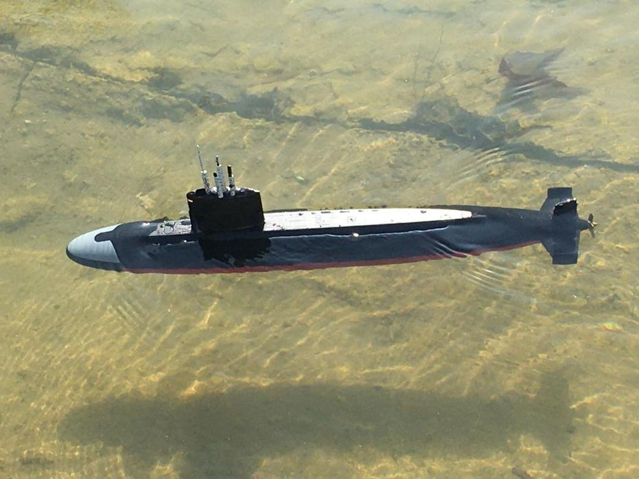

        Here are pics of her underway.... Click image for larger version
        Farlan CluttersClick image for larger version
          I am bummed I was not able to e there to see you run. Looks like you have it dialed in, how did it run?
          • secrtwpn
            • Feb 2012
            • 182
            She ran well. But I had transmitter issues. Don't know if it's the tx battery or the receiver. My receiver is a Sombra SL 8. Does this stuff ever stop???????!!!!!!!!
