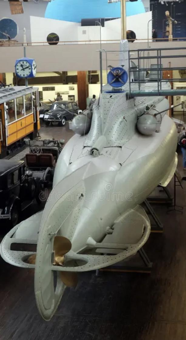

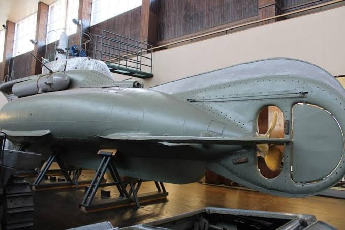

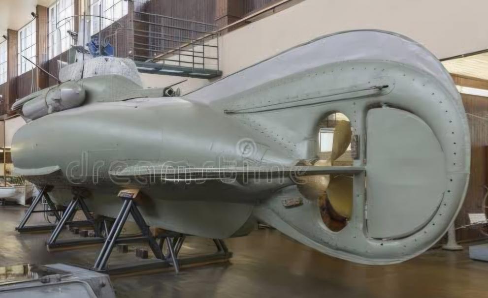

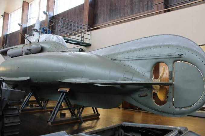

          Hello david you're welcome it looks like that the sail had some small differences the number of windows?
