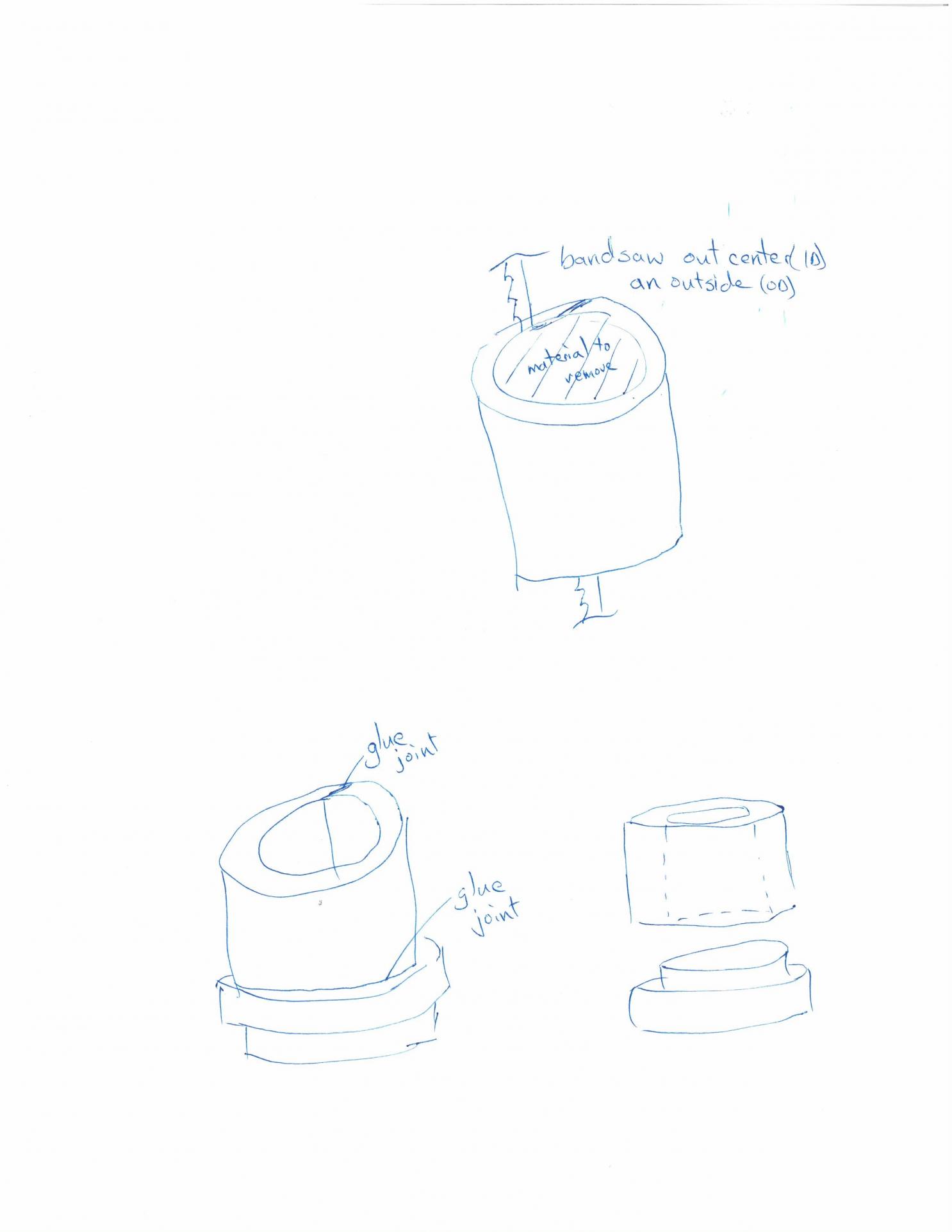

          Question on renshape. Is a super glued joint strong enough to turn? If yes could you then cut the cylinder with a bandsaw then glue it to a solid renshape plate then finish turning?
          Work is looking good.
            I'm not clear on this. Am I turning a RenShape cylinder or a Lexan cylinder, Scott? I face-mount RenShape to a RenShape face-plate all the time without incident. The CA bond is iron strong with that material.
              So I see you milling out the inside portion of the end-cap/ballast tank and
              wondered if it would be less labor intensive to cut, glue then turn/mill the part.
              A good shop teacher always tells you afterward what is easier.
