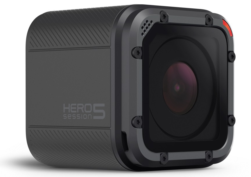

      The daddy would be something like a Gopro session 5- native 4k resolution, pictures will knock your eye out, and it's waterproof, so no case required. being a small footprint all it would need is a streamline tail to reduce drag. Sadly the performance comes at a price premium, and they're more than ten times the cost of an 808.
      Perhaps Bob could work out a deal with Gopro, say if you put their logo on your films, they may supply the kit for free. They like to see their devices used in unusual action style.
      applications. Click image for larger version  Name:	Hero5-Session-Carousel-1.jpg Views:	1 Size:	132.4 KB ID:	120168

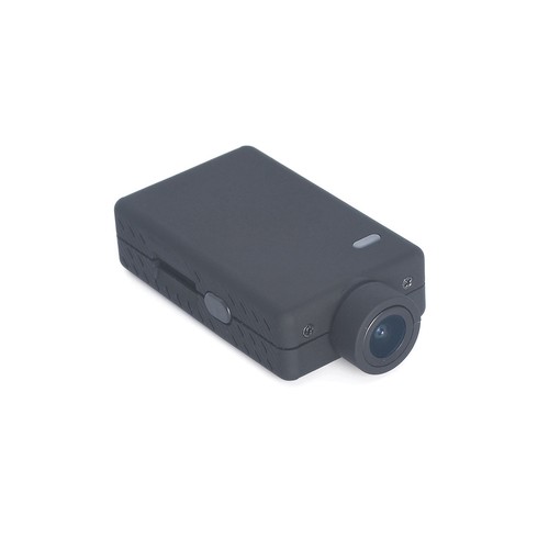

                      The hot budget-baby cam to get now is the Mobius mini. Actually a little bit smaller than the 808, and a bit more conventional in shape- achieves 1080p at 60fps- good for slo-mo shots-
                      http://www.ebay.com/itm/1080P-60FPS-...73086360&rt=nc
                      Hope the HD 808 fob cams work out for you, some of the 1080p models aren't true HD cams, is a bit of a case of buyer beware.
