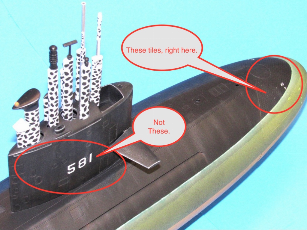

                    This one is a bit different. I like the multiple banding in the green of the hull and of course you have taken seagull poo to a new level. Seems the green is "greener" as well. And I just noticed the tiles at the front. Excellent.
                      Not tiles. Simulation of hull plating 'canning' between frames and stringers.
                        Different bit of the submarine.

                          • 13998
                          Oh! .... those.
                          Again, an attempt to illustrate the shading of 'dished' portions of structure. In this case settling-in of the fiberglass sonar dome windows over their geodesic dome support matrix. Not tiles.
                          As a diver aboard the WEBSTER I had occasion to work the free-flooding bow spaces to perform anchor, bow plane (only Boomer with 'em!) and torpedo tube inspection and maintenance. When first entering the bow -- before my kicking around stirred crap off the surfaces, turning visibility to zero -- I marveled at the complex and futuristic looking under-structure that supported our plastic sonar window.
                          And when doing security swims (a requirement when arriving at or ready to leave a new berth) on the outer hull, I could make out the slight dishing of the GRP window over the support structure. Even in those days I was an excellent model builder, dedicated to accuracy and detail work. Hence my penchant for representing everything I saw and felt and did on the boats.
