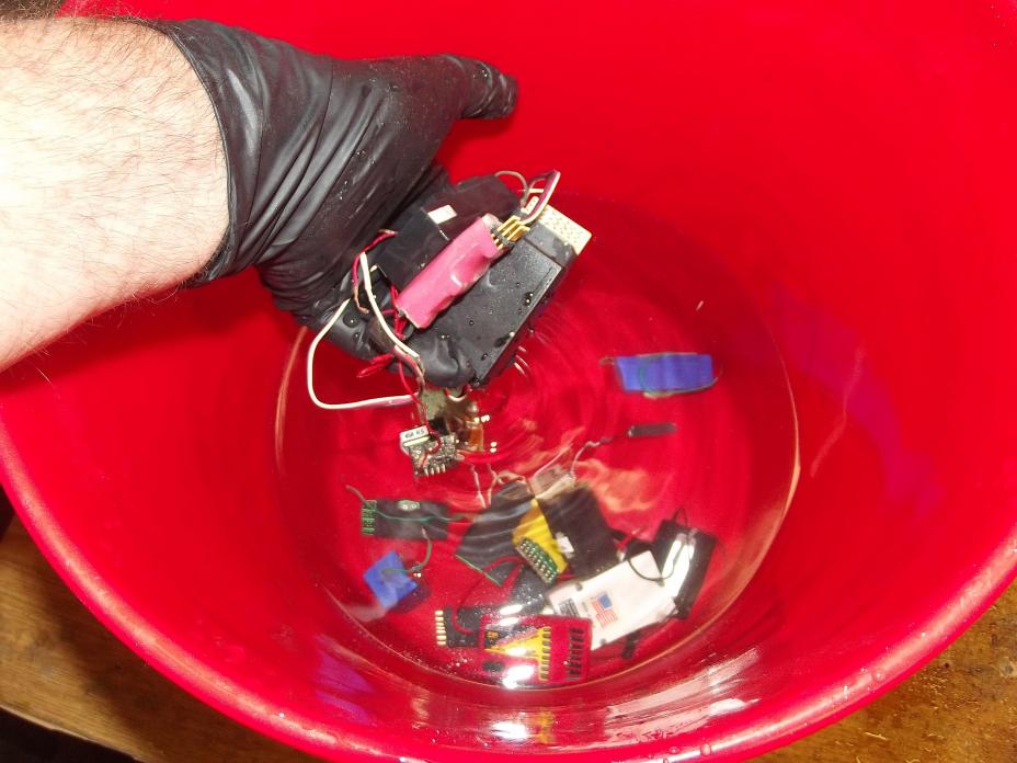

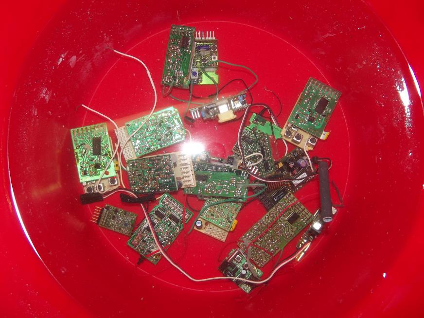

                Having lived in the world of wetted submarine electronics (both 1:1 scale and models) it is also helpful to soak your modules (rcvr, servo, etc.) in isopropyl alcohol after you have uncased them and blown them dry. The alcohol will remove any residual water and mineral deposits from the boards and wiring that may form from the water evaporating. Let the piece get good and wet (say a 20 minute soak), then remove it from the alcohol and dry naturally. Then test it. In a past life we managed to save the taxpayers many $$$$$ with just a little alcohol and some patience.

                  To buttress William's process with a few twists of my own:

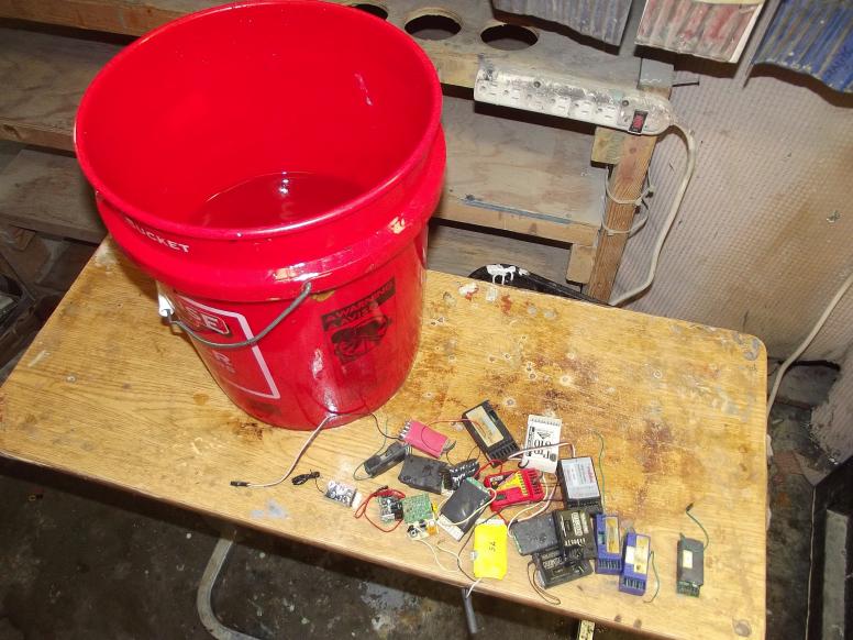

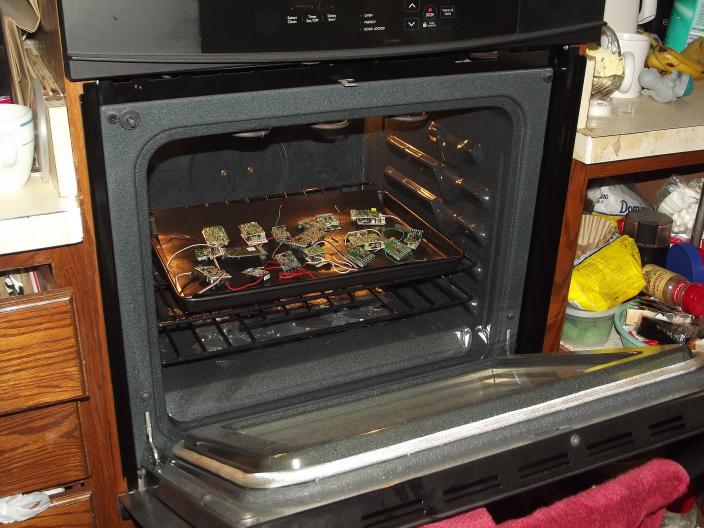

                  Blow out the boards and components with LP air; soak in isopropyl alcohol while scrubbing everything vigorously with an acid brush; blow down with LP air; place on an oven plate, and bake at 200-degrees for a day or two; garnish to suit taste; serve warm. Yummy!
                  After our big flood -- three days submersion in brackish sewer water -- Ellie and I were able to save all the electric motors, and about 75% of the electronic devices. What a mess!
                  Click image for larger version  Name:	DSCF1222.JPG Views:	0 Size:	77.4 KB ID:	150510Click image for larger version  Name:	DSCF1226.JPG Views:	0 Size:	72.2 KB ID:	150511Click image for larger version  Name:	DSCF1229.JPG Views:	0 Size:	84.9 KB ID:	150512Click image for larger version  Name:	DSCF1200.JPG Views:	0 Size:	83.7 KB ID:	150513Click image for larger version  Name:	DSCF1239.JPG Views:	0 Size:	67.5 KB ID:	150514Click image for larger version  Name:	DSCF1196.JPG Views:	0 Size:	61.2 KB ID:	150515
