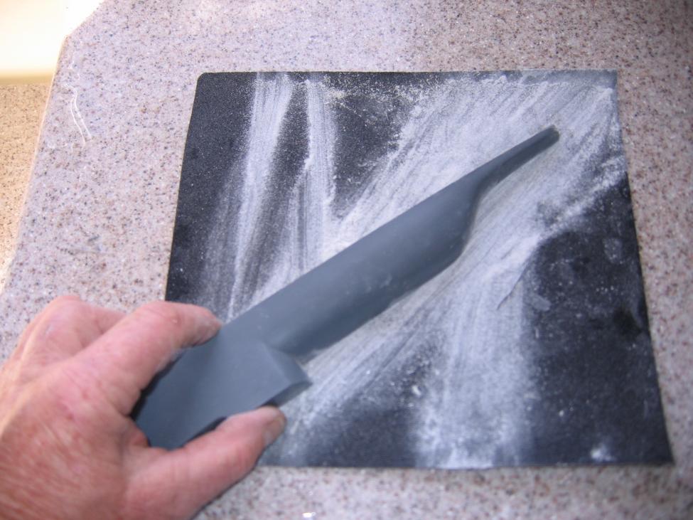

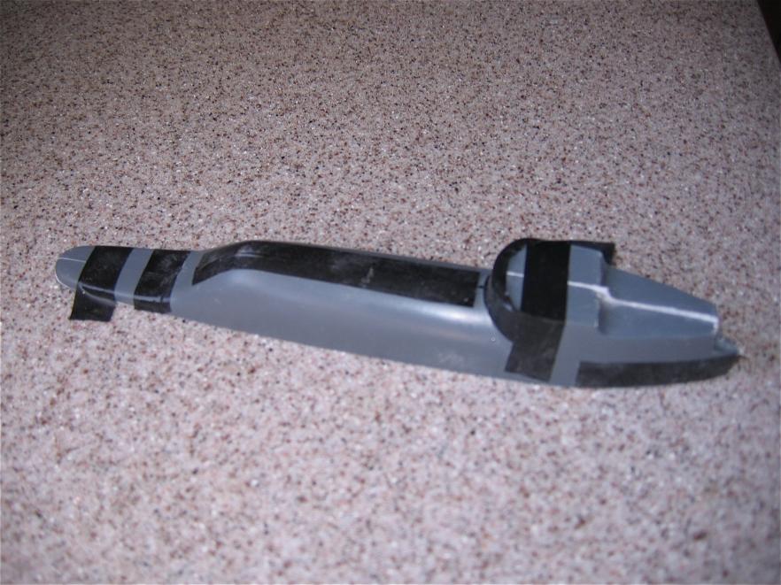

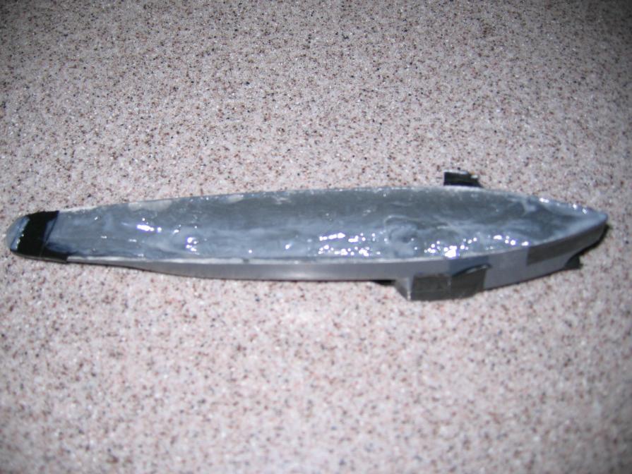

        The rudder assembly isn't my real concern with this model. Although there isn't much height in the Ducks Tail, it is wide enough to place a servo arm to one side.
        I decided to fix the conning tower today. Trimmed off the excess around the edges and then sanded them flat on a piece of 120 grit paper.
        I taped the two halves together using electricians tape as it stretches well and pulls the parts together. I mixed up some epoxy resin and coated the inside along the joint, then mixed some CABOSIL into the remaining resin until it was a paste, then brushed a dab or two of that into the joint. The thickened resin fille the crevices pretty well. Tomorrow, I'll remove the tape and give the part a light sanding to remove spew etc.

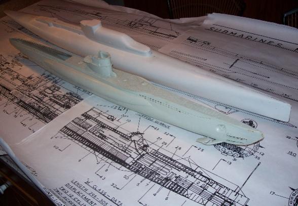

          Here is the M1 model up against the Revell VII. Both at 1:72 scale.
