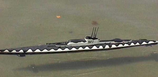

                    I have the M-1 in 1/72nd scale. Built by the Sainted Cliff Shaw

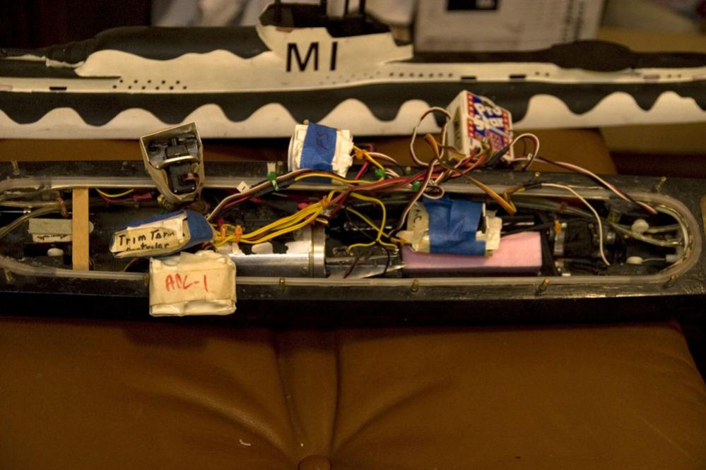

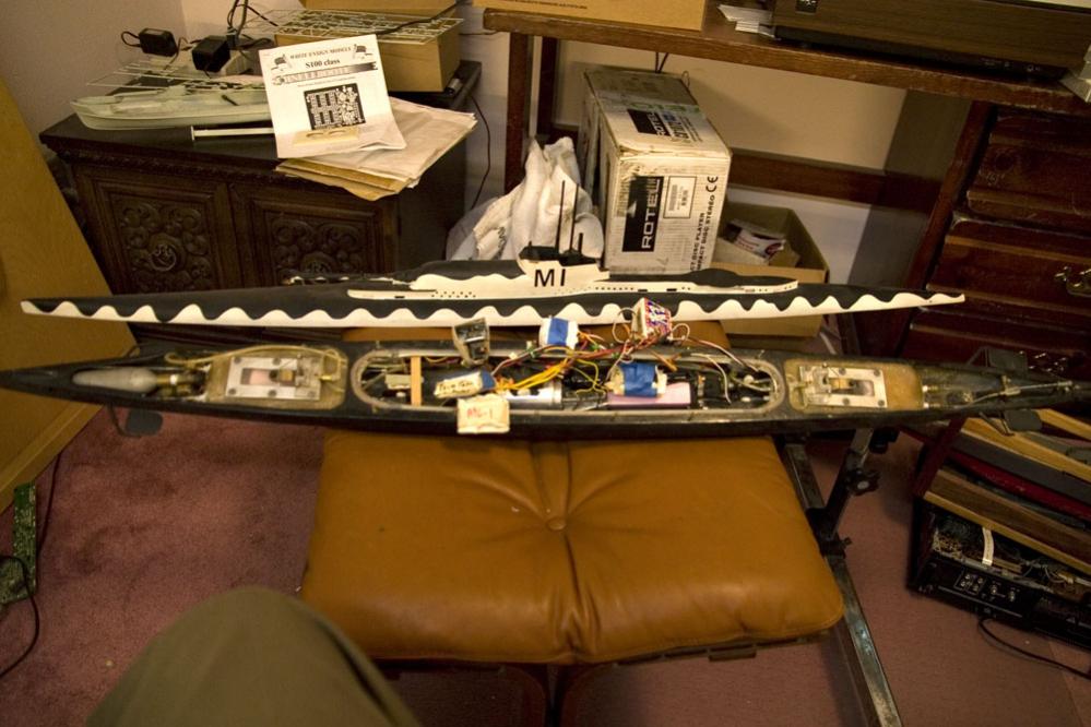

                                Here are a couple of pictures of the innards of the M1 made by Cliff Shaw that I now have in my possession.
                                From fore to aft you have:
                                CO2 tank for ballast tanks and 1/4" gun ( no longer installed)
                                Foreward ballast tank
                                Foreward diveplane servo
                                Trim Tank controller
                                APC connected to the foreward planes
                                Above the TTC is the ballast control servo
                                Trim tank
                                Above the trim tank is the fail safe
                                5v voltage regular sets on the trim tank
                                ESC
                                Above the ESC is the receiver
                                R10 pink foam seperating the battery pack
                                pair of Maxon motors
                                Aft ballast tank
