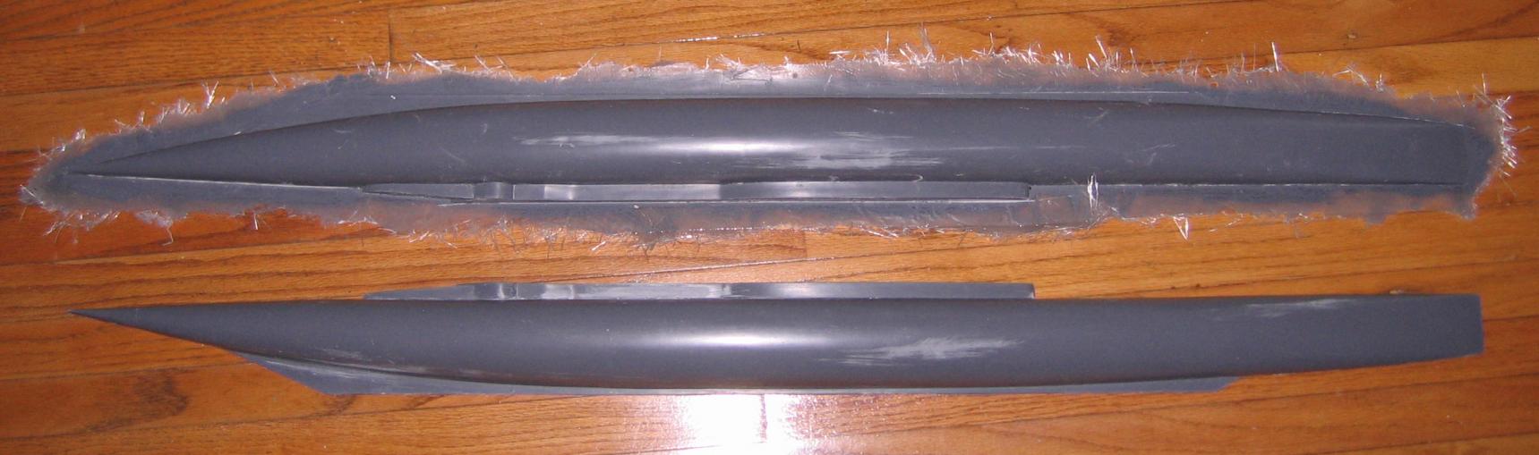

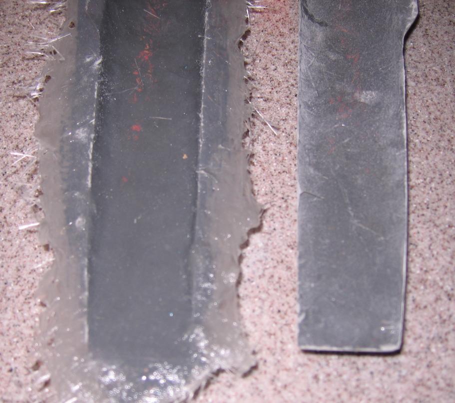

          I've just received the first M1 pull from the molds.
          We've decided to go with the split as supplied (see photos). I think this gives more options for real model-makers to tinker with their own ideas.
          I'm going to ship the model with the excess material on it, as it offers a great deal of protection during shipping. (And it saves us doing it)
          The excess trims off easily with a utility knife, and I found that the edge is easily smoothed off by laying a piece of 120 grit sandpaper on the table top and running the hull half evenly up and down.
          I am going to glue the hull halves together using epoxy and Cabosil to thicken it, letting the material squeeze out of the joints. Once this is done, then I am going to cut the hull, probably in a Z cut. There is very little space in the Duck's Tail stern for rudder arms etc. so this needs a lot of thought I'm thinking that I should make the cut about 1/4" forward of the rudder shaft, so that access is easier. I've been caught too many times fiddling around with the innards of these boats being just out of reach.
          Another few days and I should have the rudders and dive planes molded and in production. As previously stated, the Lambert plans have struts showing on planes & rudder, and that is a mistake, so the new planes will be smooth.
          Any ideas on how you would cut the hull, please?

            Mike,
            I don't remember if you said, but is it made from Gel-coat on exterior, with fiberglass on inside?
            That's what it looks like in pics.
            If so, I would probably cut it with cut-off wheels that fit Dremel. The new diamond impregnated type. They make a very thin cut and don't break like the old Dremel cut-off wheels. They did a great job on the FG T-class.
            Steady hands or a holding fixture are required but these wheels cut so easy it's not too difficult to hold steady.

              #66

              Sorry Rick! By ' Any ideas on how you would cut the hull, please? ' I meant Where you would cut the hull, rather than how.

                Of course the best place would be just below the superstructure, if that will make a large enough hole to stuff everything in.
                If not, might as well make it at the widest part of the hull, where the hull is most vertical. A cut in a vertical wall is easyer to fit together with smaller gap, than a sloped wall.

                  Good grief! He thinks I may use an axe or a chainsaw to cut the hull? When what I'm after is, do I use the Z cut method, the standard 'top off with the forward end of the top attached', or something completely different? As usual, the horizontal cut would be at the waterline.

                    I think method b based on what ive seen so far.

                      You need to provide more info to get a proper answer to that question mike...
                      What is the beam at maximum dia. what is the beam at the deck? What size sub driver are you planning? Is there room to get it in with the dogbones and linkages by sliding it in...etc. Who knows the best way might be like the engel boats where the whole front end is removed. You will need to experiment to find the best way. The hull looks very sleek but not very big. Some size comparison next to your gato would be great.

                            looks the dive planes have good access, but rudder hmm
                            Looking at Tachikaze's M1 the hull cut needs to extend right back in order to reach the rudder.
                            Sorry to post another forums (the RC groups loser forum) thread, but if you look here it is a 1/96 Gato hull which is also quite tight at the stern. look at how he arranged the rudder control with silver soldered post. might be whats needed here.

                              that or a belt driven rudder. Atleast there is only one rudder.

                                The positioning of the rudder is why the seperation of the hull is set up the way it is. The tiller on the rudder is only slightly longer than 1.0cm. The throw on the servo is about 1.5cm.
                                I have a similar problem on the Surcouf, not related to the length of the tiller arm, but finding a line on the boat to seperate her and still look good.
