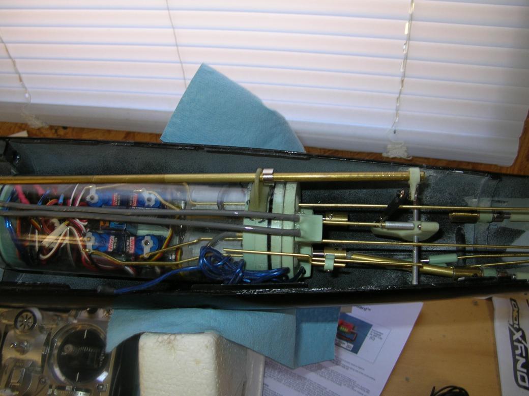

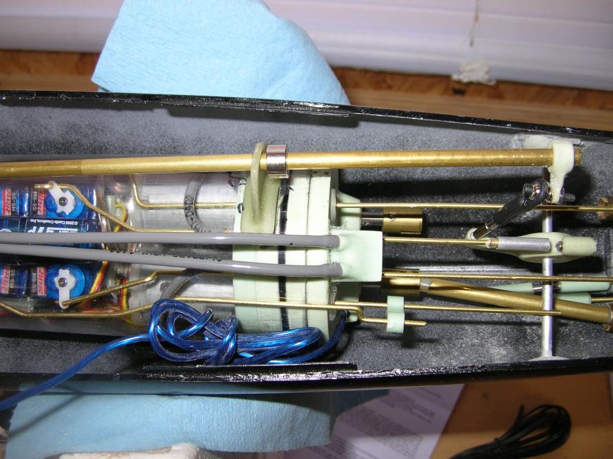

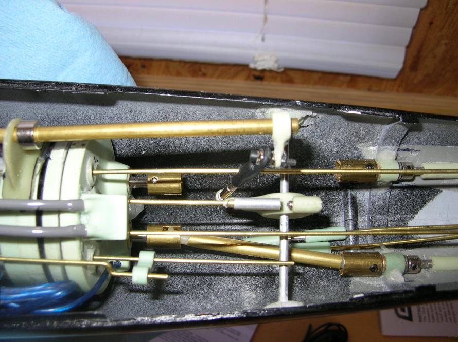

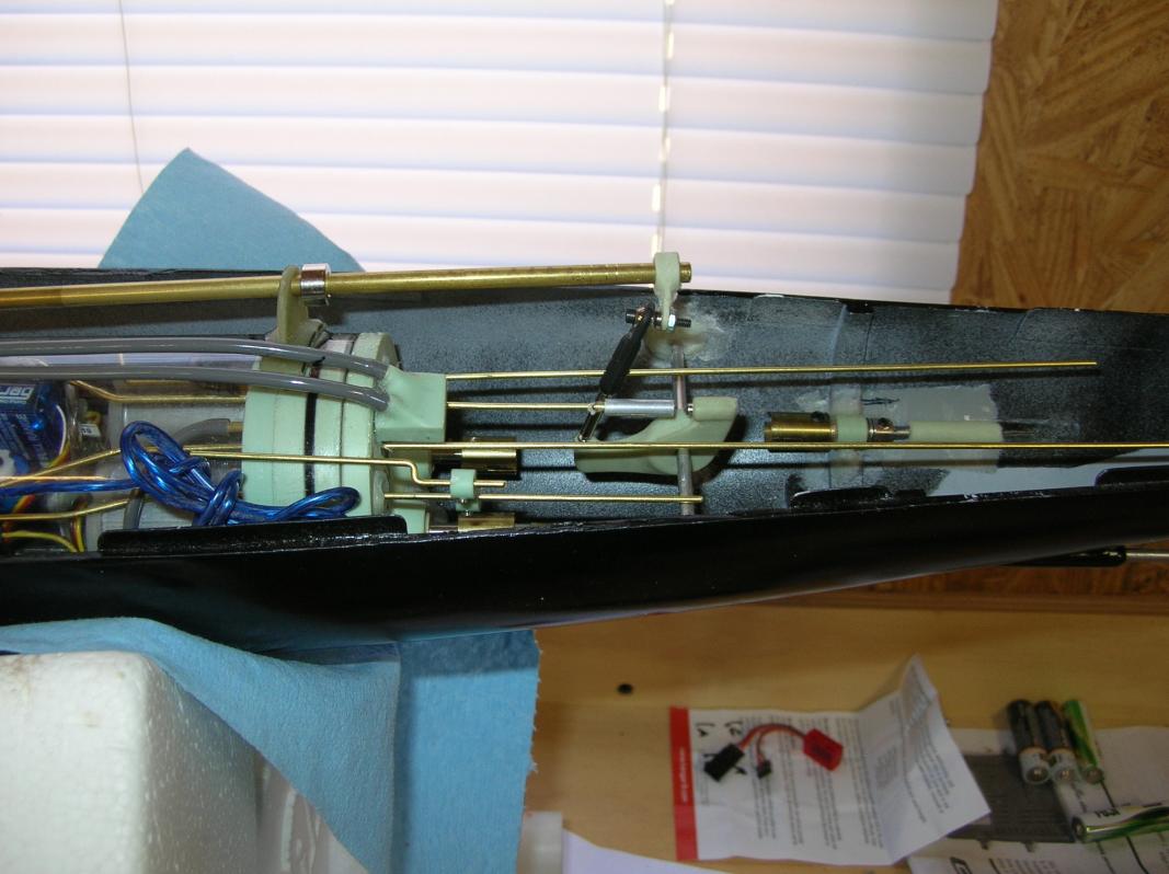

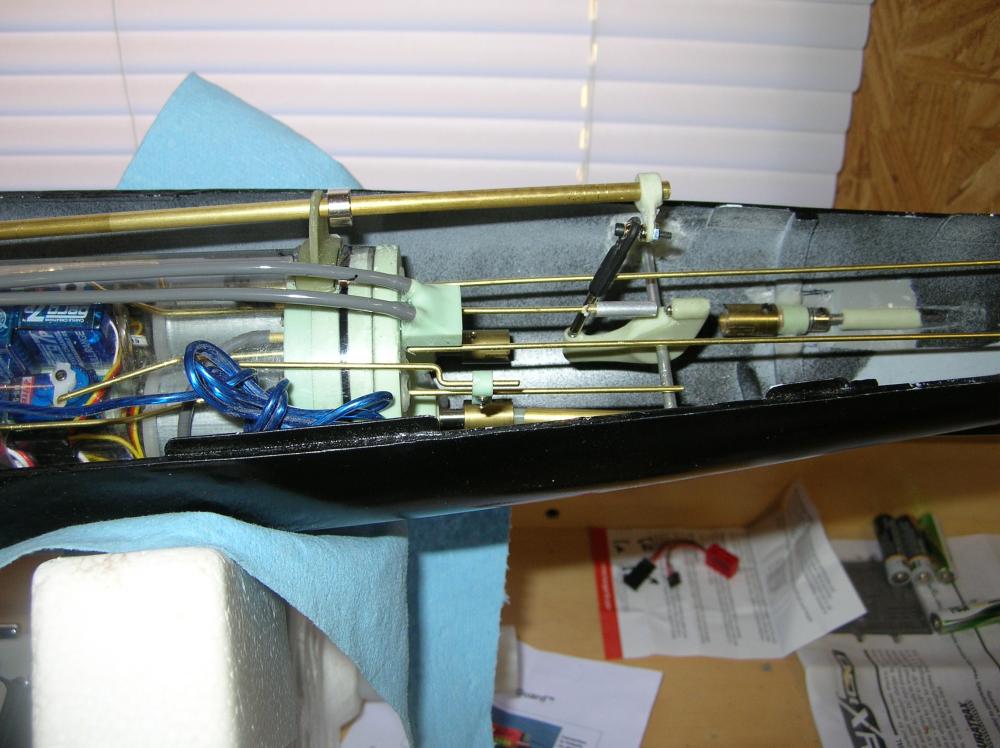

        Please post pictures of what you got -- something is terribly amise here.

          Hope these show up alright.Click image for larger version

            Cut away the aluminum tray under the retract servo. Drop the retract servo till the output arm (bell-crank) is at the cylinders maximum diameter. Install a longer bell-crank arm. Send me money. Sing my praises! Register me as a religion!

                  That fixed the problem. I'm happy til the next fix. Going to test wtc in water wedsday, hopfull there will be no leaks. Again thank you for your help
