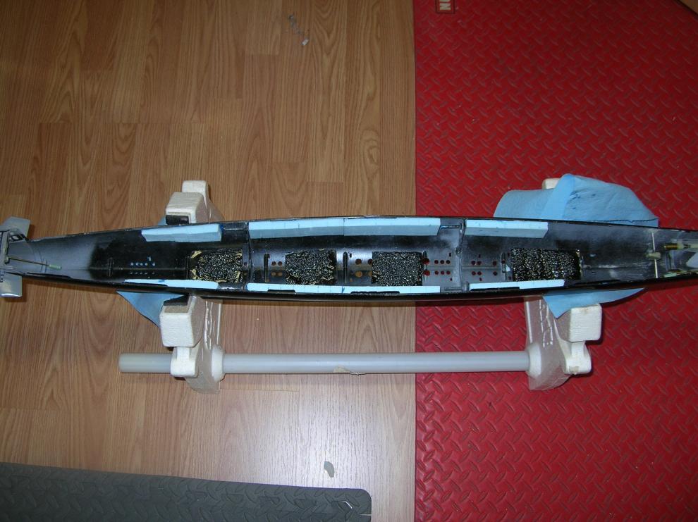

        got the ballast kit for the gato from caswell. not for sure where the 6 pieces go. On bottom or sides. I'm thinking bottom and foam on the sides. All so not sure where pink foam goes. The 6 pieces are black with what looks like bird shot in it.
        Please let me know. Thank you
          • 14010
          Start with three of the weights, situated in the center. And, yes, they go in the bottom of the hull. The foam, is equally spaced longitudinally on the sides of the lower hull. The trick is to place the top of the foam even with the boats designed waterline.
          Make your initial installation take pictures and we'll guide you in for a safe landing.

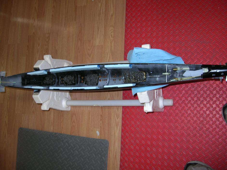

            put foam in hull. the weights are just sitting ther for now. need to know if is alright to grind them down a little. wtc woun't fit all the way down the way they are. Here' picsClick image for larger version
ID:	76624Click image for larger version
              • 14010
              sure, grind away

                do I need to redrill the holes on the lower hull that the weights are going to cover?
                  • 14010
                  no........................

                    Got all my foam in and my weights epoxyed in. Hopefully weather permiting going to my sons house and use his pool to balance the sub.Will let you know how it turns out.
