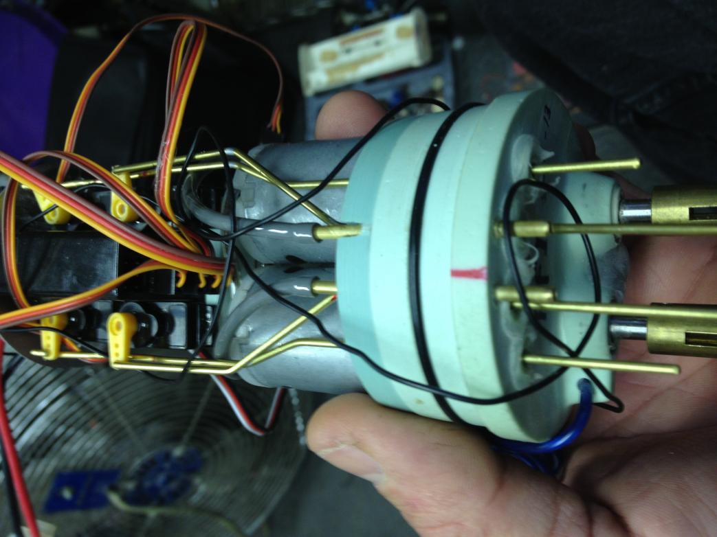

                        I put shims in to space the servos outward a bit and carved the tray out some. But I've got a JR scanselect rx to fit in the gato SD tray. Click image for larger version
ID:	77163I know its not the greatest photo depicting rx install, but it shows it in there.
