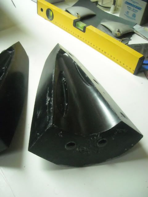

    Here is the other one

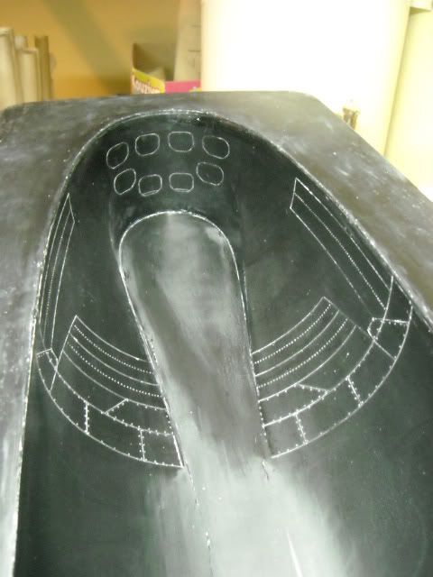

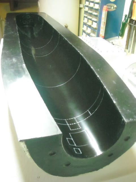

      Thank you very much David!
      Some more work has been done and here is some photos!

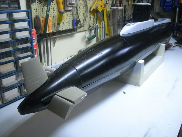

                Hi there!
                Work is coming along and here is some photos of the progress!

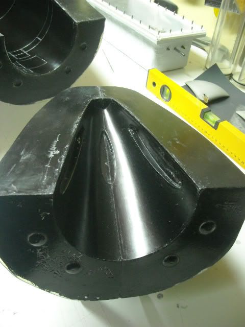

                              Hi everyone!
                              I did some more progress on the boat and here are some deck molding photos!

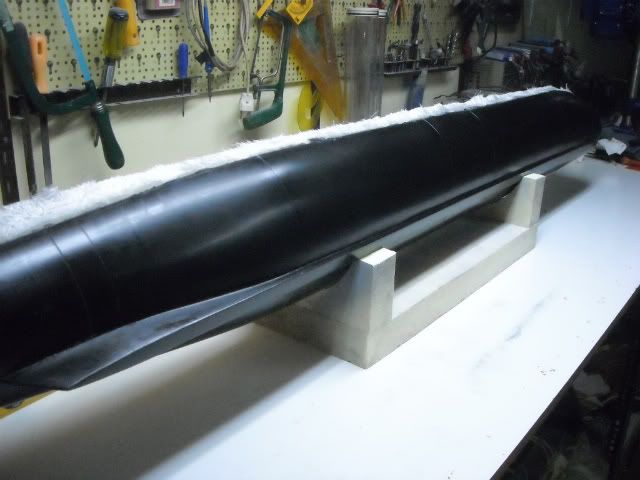

                                Hallo everyone
                                Here is some photos of the progress it's been made lately! Finally I've started assembling the beast! So far everything goes as expected!
