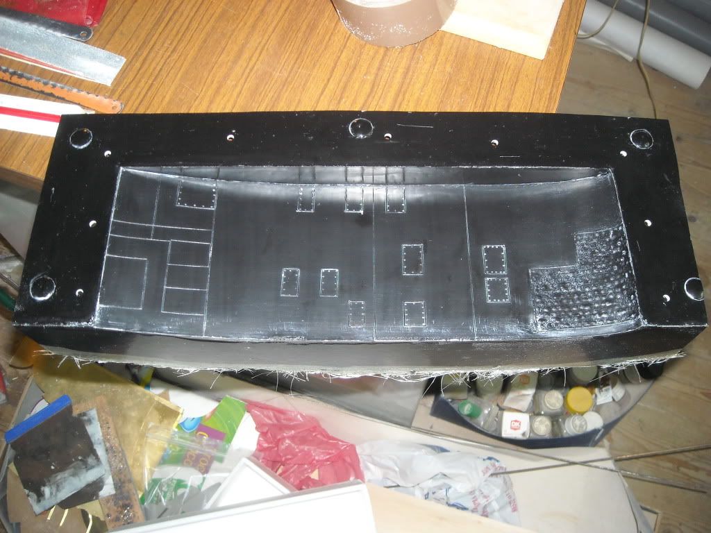

          A small update! Molding process photos!

            Finished with the mold. It needs a good cleaning and then I'll start waxing again to produce the first part. It didn't come out as good as expected but I think it'll do for now! I'm going to remold it at a later stage as I'm not very happy with it!

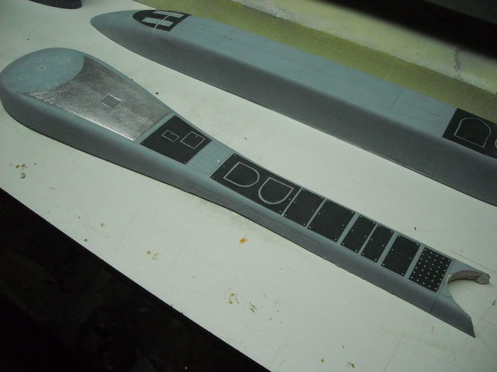

              Taking advantage of the time between the wax layers I made the last detail on the deck just behind the sonar dome! I used a piece of mesh cut to size and it was glued in place with a little cyano. Then it was covered with self adhesive aluminium tape wich it was pressed with an eraser to form the lines of the mesh. I'm quite pleased with the resolt! Sorry about the black & white photos but something went wrong with the camera!

                        Just a small update! The progres is VERY slow due to work obligations and luck of time! Anyway I've managed to add some detail on the top of the sail and now I think is ready to be molded in RTV

                          • 244
                          Also did the antiskids on the deck and cut the hull as shown in the photos! The reason I did this is that it gives me the option to produce three diferent types of 209(conversion kits are going to be made) just by changing the deck! The types are 209/1100,209/1200 and 209/1200AIP. The hull itself is going to be molded in GRP while the sub sail and deck are going to be molded in RTV

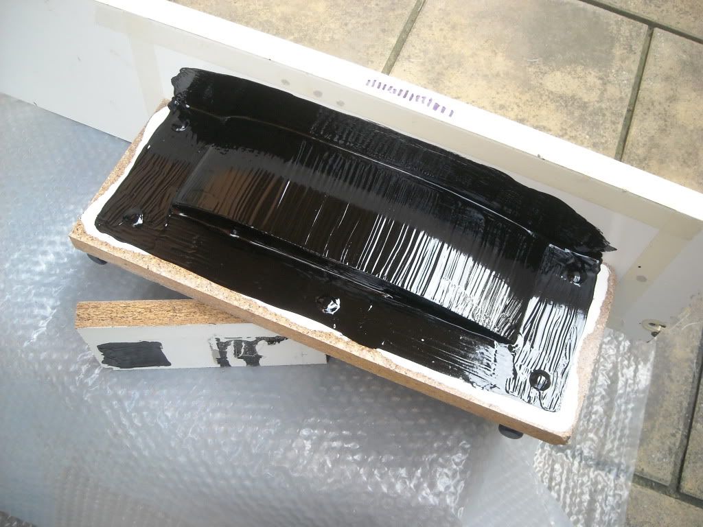

                            Hallo everyone
                            At last some progres it's been made and molding has started!

                              Moving along nicely. Please tell me thats epoxy for the mold gellcoat.
                                Sir, I'm afraid I'm going to disappoint you, it's not epoxy, it's polyester gelcoat! I thought to go that way just in case I'll have to do some changes or mods and I won't waste some good and expensive material! If everything turns out OK then I'll go the proper way! Here is some more photos and a couple of videos just for the fun of it! I hope I don't bore you to death!!!
